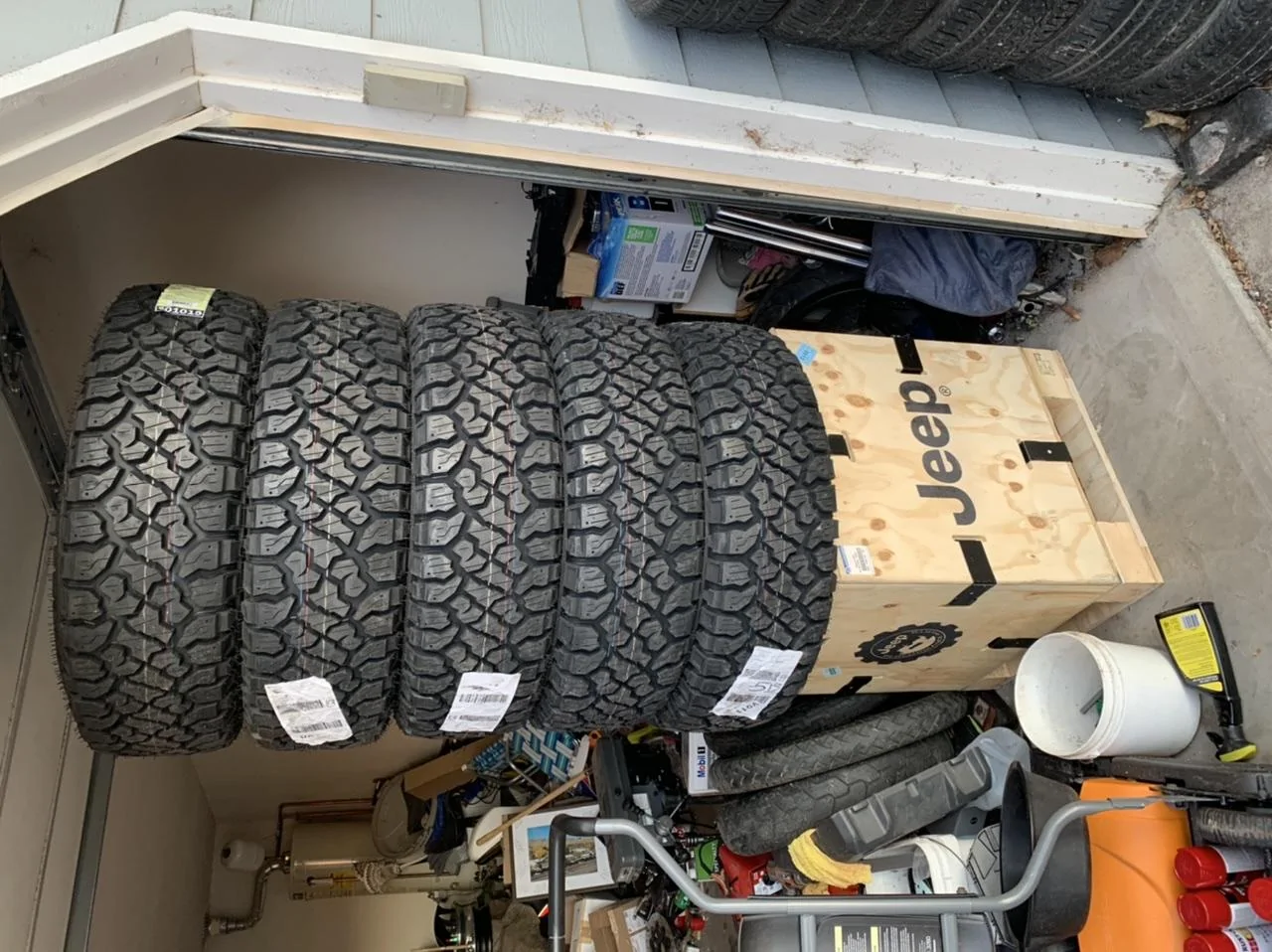

I’m putting my build here for others to use as reference and so that we can all benefit from my experience with the parts I’ve chosen. My Gladiator will be here next month but I’ve been preparing for it by getting a lot of the parts for my build together. I’ll bore you with details later, here are pictures of what I’ve gotten ready so far. Parts list will be below.
Jeep Gladiator ‘21 Sport w/2” Mopar, Kenda 35x10.50 on Mopar Steel Spares 6F9252A9-DCE5-48FF-BAC7-E77AF08F1026
Jeep Gladiator ‘21 Sport w/2” Mopar, Kenda 35x10.50 on Mopar Steel Spares 41B3C867-3F80-4BA3-864A-6B7F83BC32D6
Jeep Gladiator ‘21 Sport w/2” Mopar, Kenda 35x10.50 on Mopar Steel Spares 2EB36735-B293-476E-8F85-32CF630B41F1
Jeep Gladiator ‘21 Sport w/2” Mopar, Kenda 35x10.50 on Mopar Steel Spares BB884CF7-9F79-4952-8B83-B5FD54837E26
Jeep Gladiator ‘21 Sport w/2” Mopar, Kenda 35x10.50 on Mopar Steel Spares 6D112E30-60FC-419D-B508-D76389740D5F
Jeep Gladiator ‘21 Sport w/2” Mopar, Kenda 35x10.50 on Mopar Steel Spares AEE6F632-AA04-4B4F-8320-BCEBDE2EBBF5
Jeep Gladiator ‘21 Sport w/2” Mopar, Kenda 35x10.50 on Mopar Steel Spares 392B5EA2-81A2-4378-B629-599405D1F795

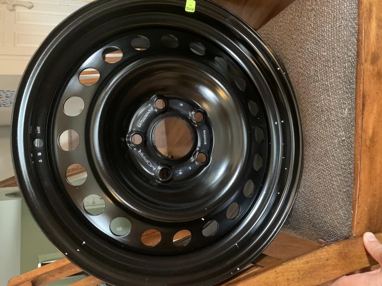

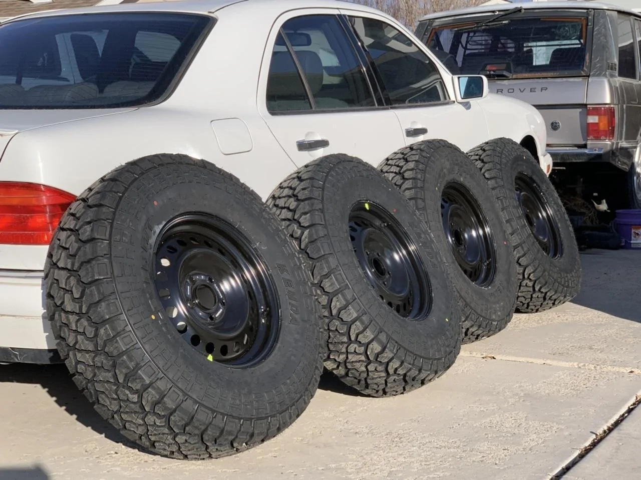

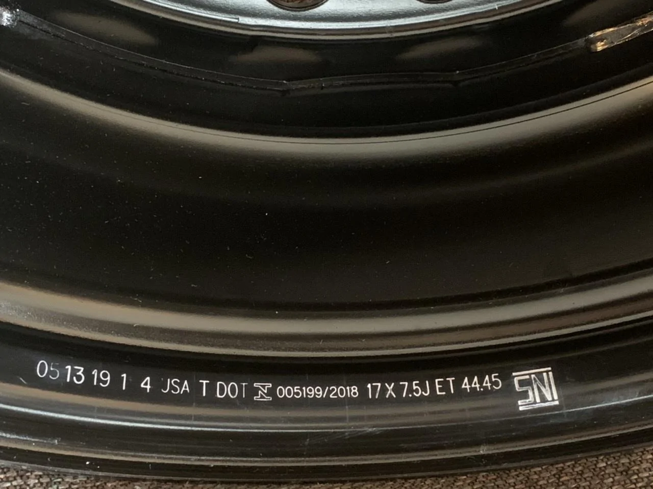

MOPAR steel spare wheels PN 04755290AA
Kenda Klever 35x10.50r17
MOPAR TPMS sensors PN 6846466AB
MOPAR 2” Lift kit PN 77072468AB (obviously still in the crate)
Take-off Mojave rock sliders PNs 68341315AA and 68341314AA.
I also ordered the Rebel Off Road Xplor half rack from Steve at Rebel Off Road today. I have a Tepui Autana XL Ruggedized that will probably ride on it for a little while as I build a trailer up for camping. More pics will follow, but I’ll likely wait until the Jeep gets here since we can all look at pictures of parts whenever we feel like it.

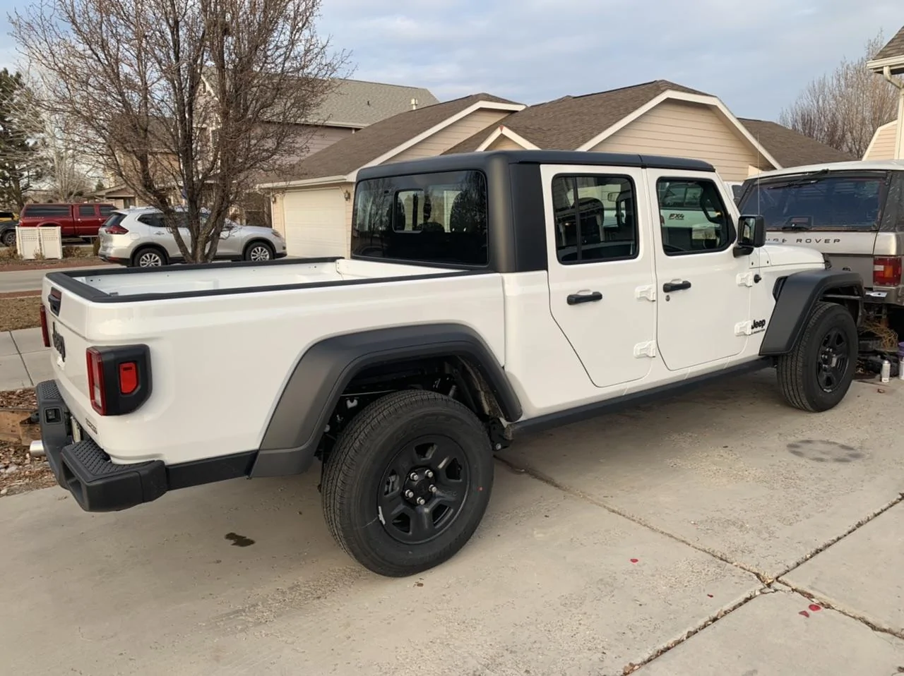

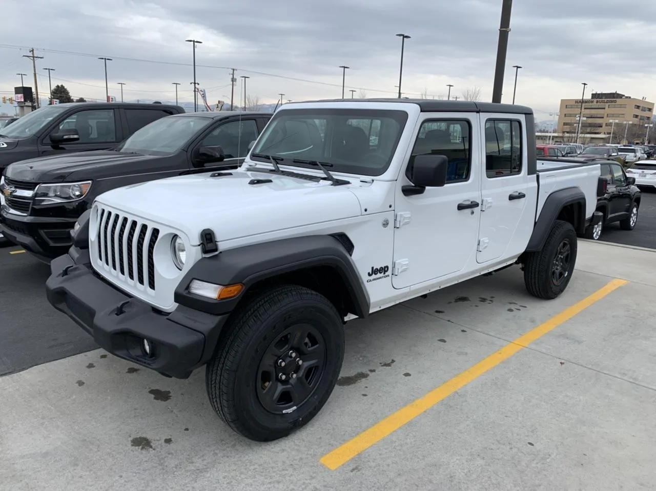

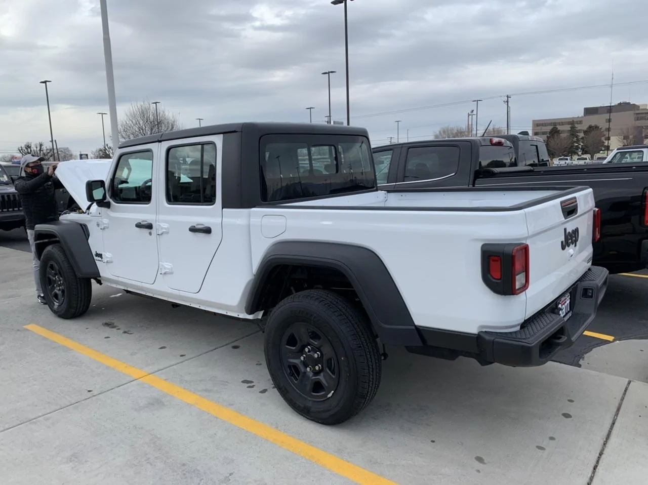

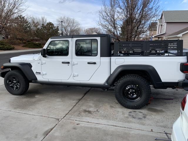

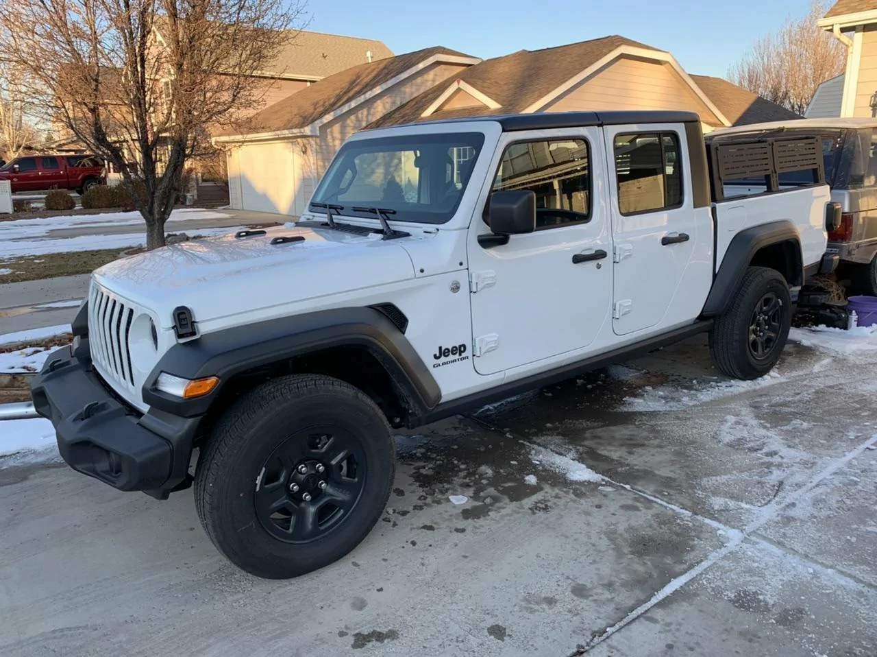

Finally picked up my Gladiator the day after Christmas! I’ve been super busy since. Got the rock sliders, bed rack, LED tail lights, and stubby antenna on so far. Waiting a little bit to put the lift and wheels/tires on. I’ve got a lot of traveling for work to do this month and it’s super cold here anyway.
At the dealership with 6 miles:
Jeep Gladiator ‘21 Sport w/2” Mopar, Kenda 35x10.50 on Mopar Steel Spares 1972669C-B94C-4834-971E-5C337030DC4A
Jeep Gladiator ‘21 Sport w/2” Mopar, Kenda 35x10.50 on Mopar Steel Spares 4C770B8C-6F25-4421-B34B-F3A7F8A14B9C
In my driveway with rock sliders installed the next day:
Jeep Gladiator ‘21 Sport w/2” Mopar, Kenda 35x10.50 on Mopar Steel Spares 0CA5D477-E60A-4CC5-A29B-A5D94DE2AF96
Jeep Gladiator ‘21 Sport w/2” Mopar, Kenda 35x10.50 on Mopar Steel Spares 756AFAC9-68F5-49E8-AAA4-D625C3AAB3C9

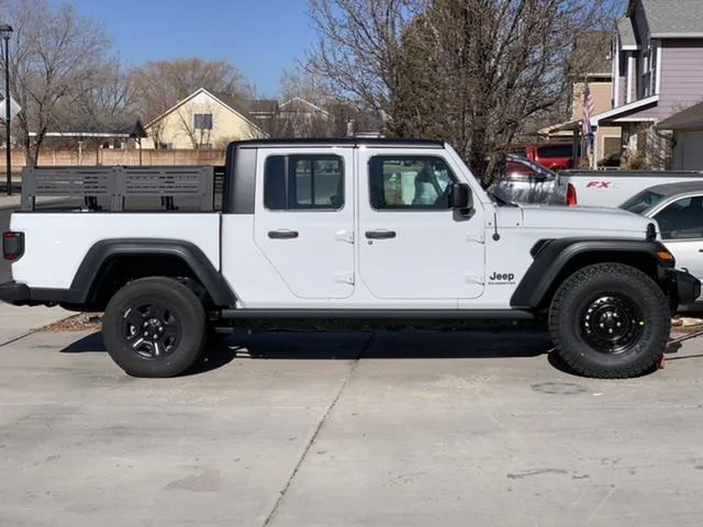

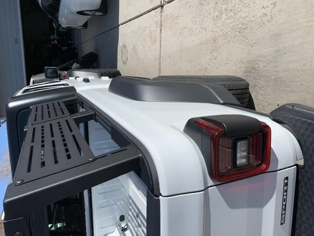

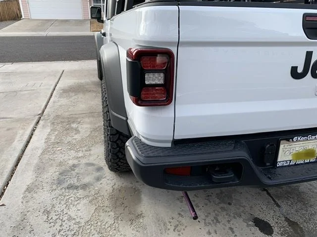

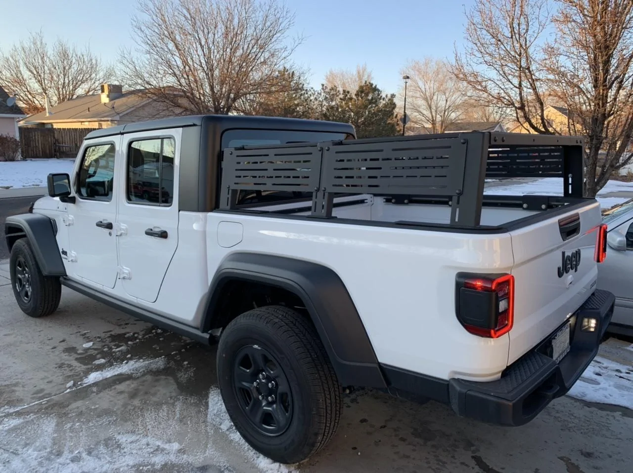

Rebel Off Road half rack and LED tail lights installed:
Jeep Gladiator ‘21 Sport w/2” Mopar, Kenda 35x10.50 on Mopar Steel Spares 258B7C25-AE37-4739-A911-CA78F3B5C598
Jeep Gladiator ‘21 Sport w/2” Mopar, Kenda 35x10.50 on Mopar Steel Spares 38D73D82-8910-4035-A800-50BD76511A1C

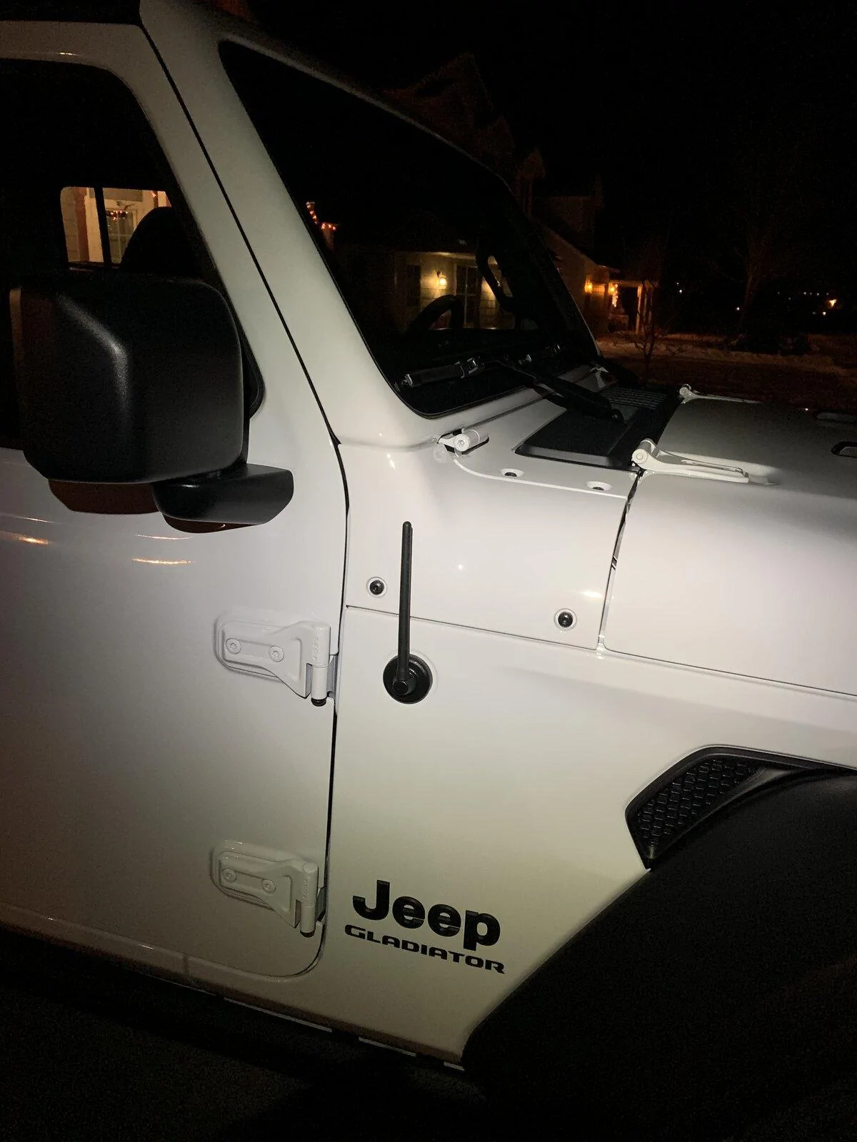

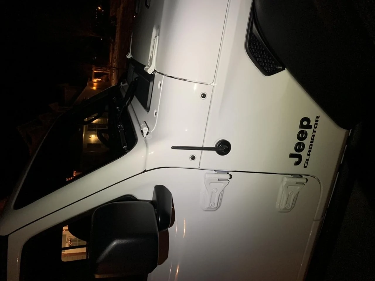

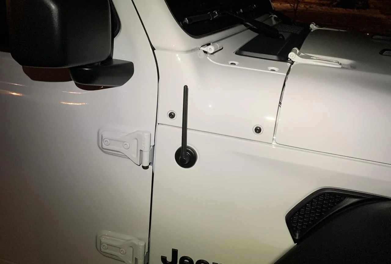

And the easiest install so far was this little 6” Votex antenna from Amazon that ACTUALLY WORKS!
Jeep Gladiator ‘21 Sport w/2” Mopar, Kenda 35x10.50 on Mopar Steel Spares A20E1D35-1D6C-4F7D-B4B9-0B3DE27017AC

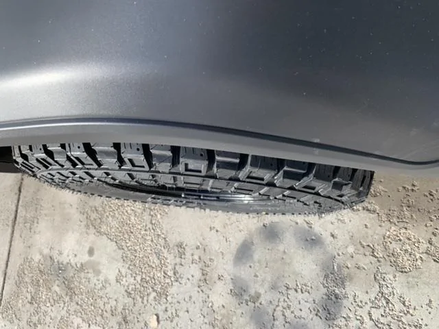

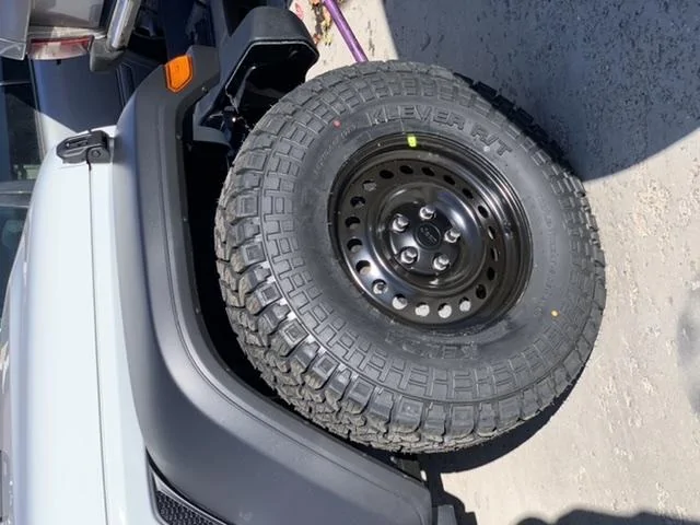

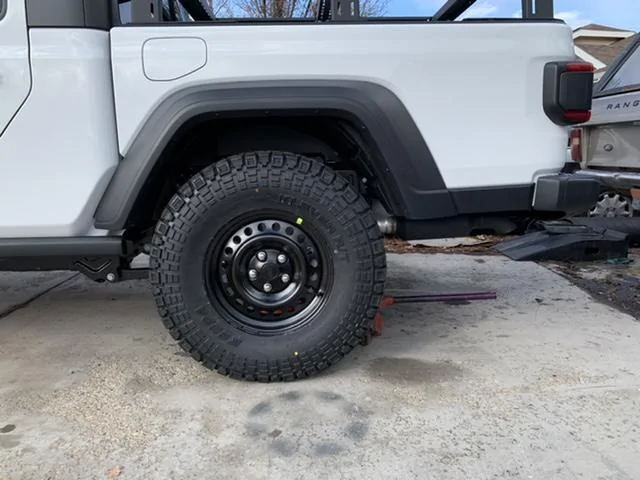

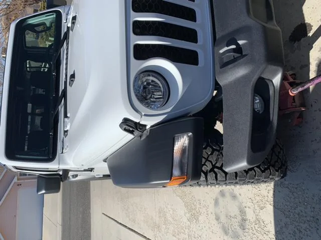

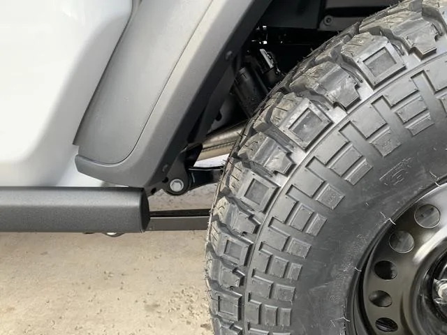

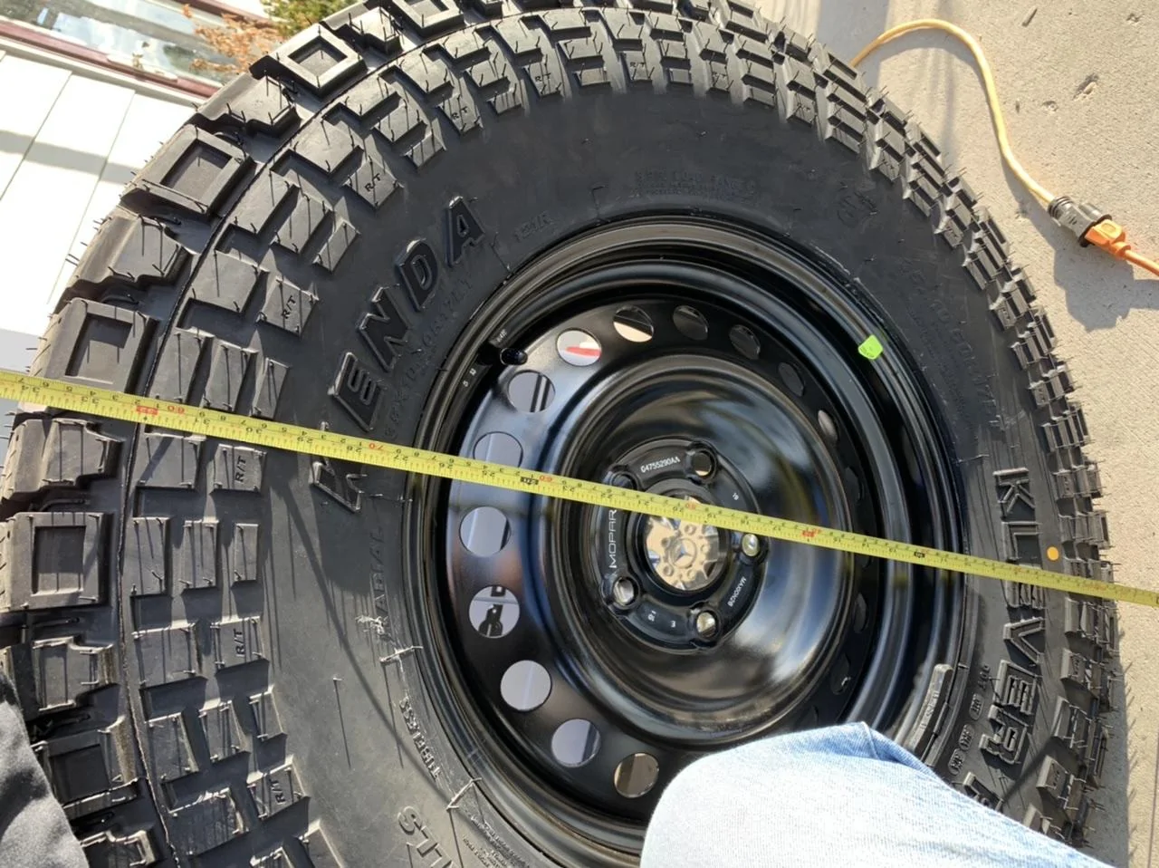

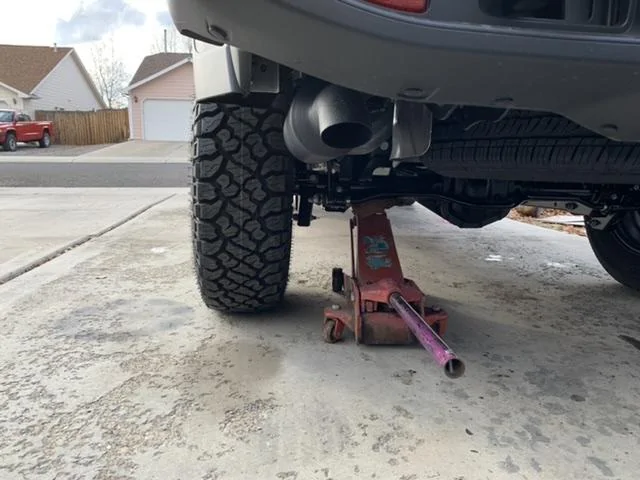

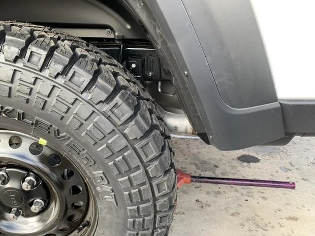

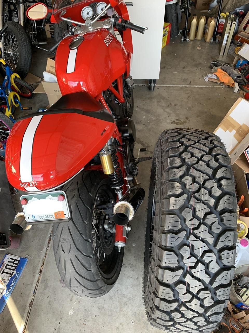

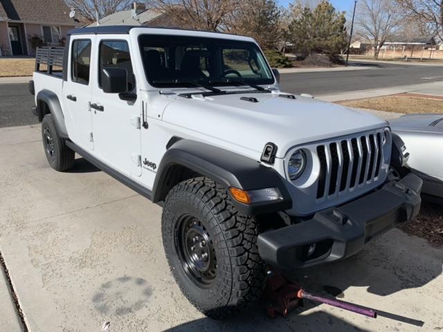

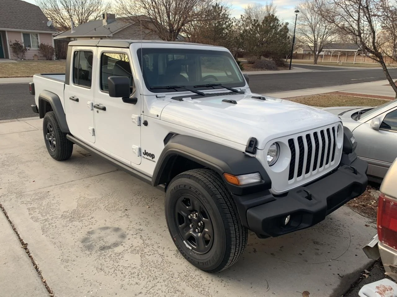

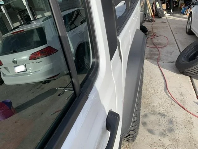

I have a couple of test fit pics to share! These are without the lift installed and only one at a time but might help others wondering about fitting them on a stock rig. Personally I wouldn’t try it. It looks like they would stuff up and destroy the milk jug thin factory inner fender liners if you hit a speed bump too hard.
An interesting thing that I discovered was that the wheel’s inner surface to brake caliper clearance is kind of tight. My wedding ring is 6mm wide and easily slid through the gap but I was worried just eyeballing it.
I sold the TJ that was holding up my progress on building the JT today, so hopefully soon I’ll get to put my lift on and finally bolt these bad boys up for real. The wife wouldn’t let me work on the new Jeep until the old one I bought to flip was gone...
Oh and I almost forgot - the factory steel wheel hubcaps / center caps work with these wheels perfectly! So if you’re changing over from alloys just pick up a set of the factory steel centers and you’re good to go!
