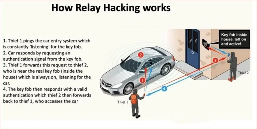

Faraday Pouch - Why own/use one....
You might want to carefully read the following:
Features like keyless entry and keyless start are extremely convenient for drivers, as you can unlock your vehicle and hit the ignition without having to get the key out of your pocket....
However, this technology can also leave you vulnerable to sophisticated thieves: they are known to use relay devices (see graphic below) to copy a fob's signal, allowing them to drive off with your car without leaving a trace. These relay devices can be had for $30+- and are easy to acquire and easy to use...
What is a Faraday pouch?
A Faraday pouch or bag (aka: RFID bag) is lined with a material, frequently copper based, that contains the RF signal transmitted by a vehicle's fob. The material absorbs and redistributes electronic signals from the fob, not allowing the signals to escape.
It’s this signal that tells your JT/JL that the fob is nearby and allows the vehicle to be unlocked without pushing a button on the key fob.
So in a nutshell, a Faraday Pouch/bag blocks all radio signals ranging from Wi-Fi and Bluetooth to RFID (used by credit cards and car fobs) and GPS.
In closing..... DO highly consider buying a Faraday Pouch/Bag ....and do put it to use. Faraday Bags are inexpensive.
Do read the Faraday Bag reviews/shop around, before you buy, as not all Faraday Bags are durable and can be known to fail..
Important:
Periodically check/test your Faraday Bag to be sure it is up not damaged and not serviceable.
Day to day use can damage the bag lining with the result that the signal blocking ability is compromised..
How to test that Faraday Bag .... Place a fob in the Faraday Bag... close up the bag properly and then squeeze the bag so that it initiates a button push on the fob inside.
If, when doing the fob button push, your JT/JL responds, do know that your Faraday Bag needs replacement as it is not blocking radio signals as it is suppose to do.
YES, a Farady Pouch/Bag is a defense against Relay Hacking....

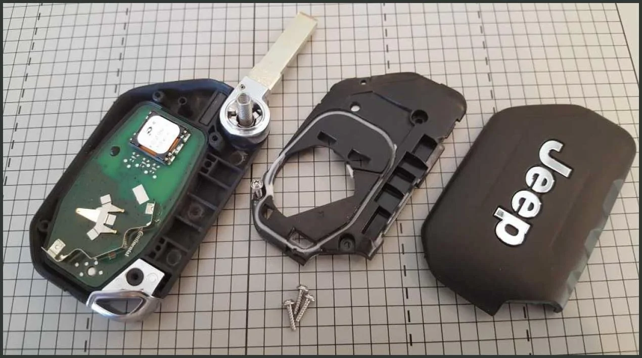

Both circuit board and RFID chip are in the buttonless factory fob.
Here is a pic of a buttonless factory fob opened up.... the pieces..
Thanks, I was curious since that's what mine is.
No battery in that case if I'm seeing right for the buttonless?
And either way I was assuming the RFID to start the vehicle is passive and doesn't require fob battery to start the jeep?
Edit I'm seeing the other post now with that info

All JT/JL fobs have a CR2450 battery, a circuit board and an RFID chip in them.
Regarding the Fob Circuit Board and CR2450 Battery:
With the programmed circuit board and attached healthy fob battery.... in simple terms, the fob talks to the JT/JL.... the vehicle then knows it is ok to start and run, turn on and off, and the vehicle is allowed to run.... and deals with the vehicle alarm.., etc.. You do not actually need the RFID chip in the mix/ in the fob...
Without the 3V fob battery to power the circuit board, (programmed to your specific JT/JL) the fob would not be able to communicate with the JT/JL.. so the vehicle would not know that your programmed fob was present and your JT/JL could not be started...... It could not be started even though there is an RFID chip in the fob. SO, without the fob battery or if the fob battery is depleted... you need to know the following in order to start/drive the vehicle..
With a dead fob battery, you take the fob and while holding the brake pedal down, you press firmly, the end of the fob that holds the RFID chip to the start button...(the fob end opposite of the panic button ) the RFID chip is then noted by the JT/JL and the JT/JL will start. ( Important: Remember, with that dead fob battery.... when you exit the vehicle, do not lock the JT/JL up by pressing the door lock button on the door. ) Get out of the JT/JL and lock it with the key, using the key.
IF, you use the door lock button to lock and set the system alarm, when you come back later to the JT/JL and use your key to open the door..... the door will unlock and the alarm will sound/honk honk honk..

For those that have not had their factory fob apart .... here is a very clear picture of IT...a part.
Note the size of the circuit board.... seeing the size of the circuit board, show's you WHY.... why, the factory fob is so big.
Click on pic to enlarge
