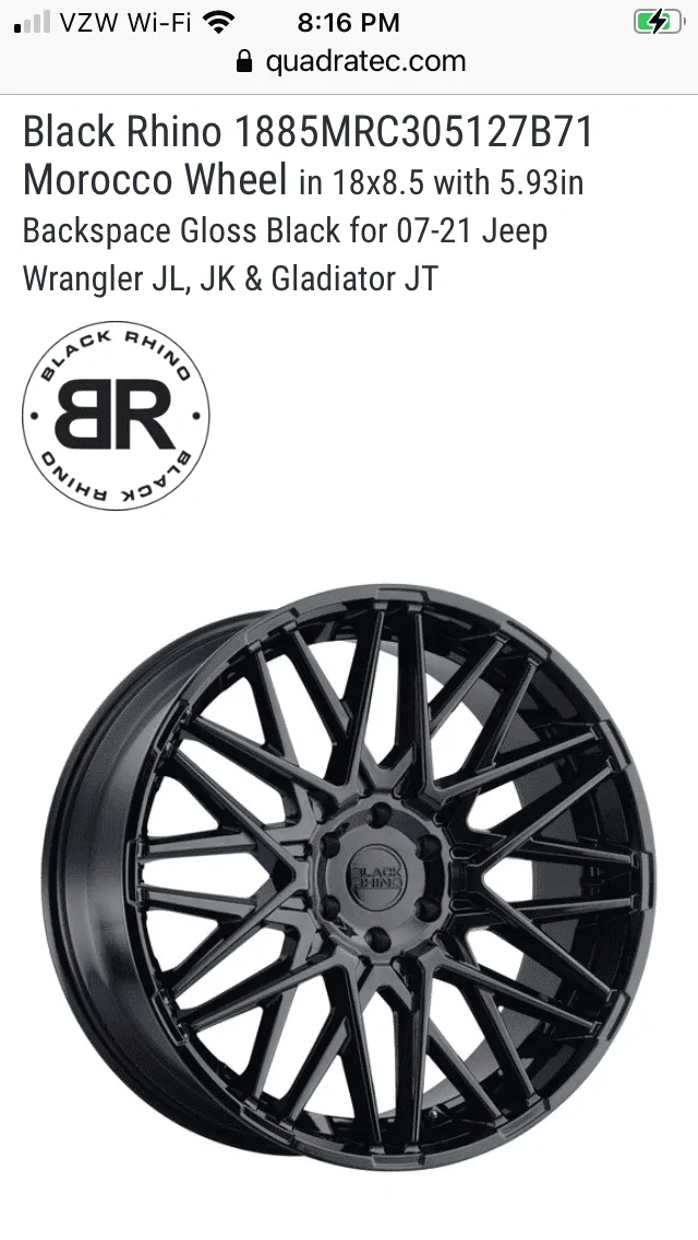

Patience grasshopper...
I do like th
This one is similar in style to the V11, and is +30.
Buy that wheel and a 1.25 or 1.5 inch hubcentric spacer. Easy.
according to my math, as well as 2 different offset calculators, i should only need 8mm thick spacer, to keep my inside tire edge , at the exact location it is with the stock wheel. If I’m wrong, please show me the math.🤔

I do like th
That wheel has a 5.93 inch back space, which is almost exactly stock Mojave backspace, you’ll be fine. The 9.5 inch wheel will need a bigger than .25” spacer
