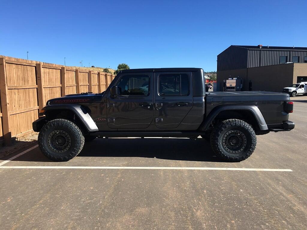

I used that same Teraflex/Daystar combination on my Rubicon when going to 35's but only installed the 1" riser up front (it comes with two rings, 1" and .5" you can use together or separately). Wanted to keep the factory rake so when I tow or haul a load it won't squat too much.

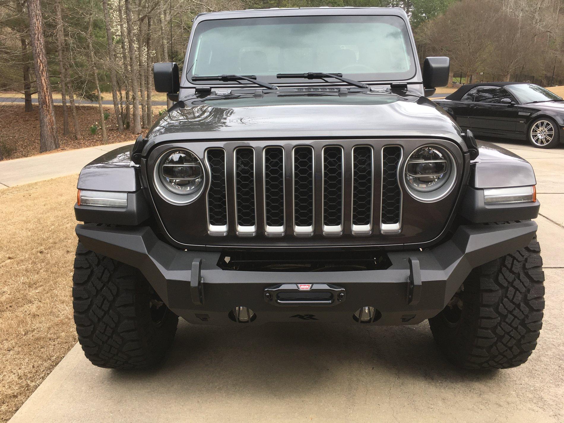

I all ready have the Rubi suspension on, now that I have a bumper on and winch ready to mount I am going with the Teraflex to have the option on the lift. (1”/1.5”) to just remove the sag from the extra lbs. up front.
Keeping the rake....

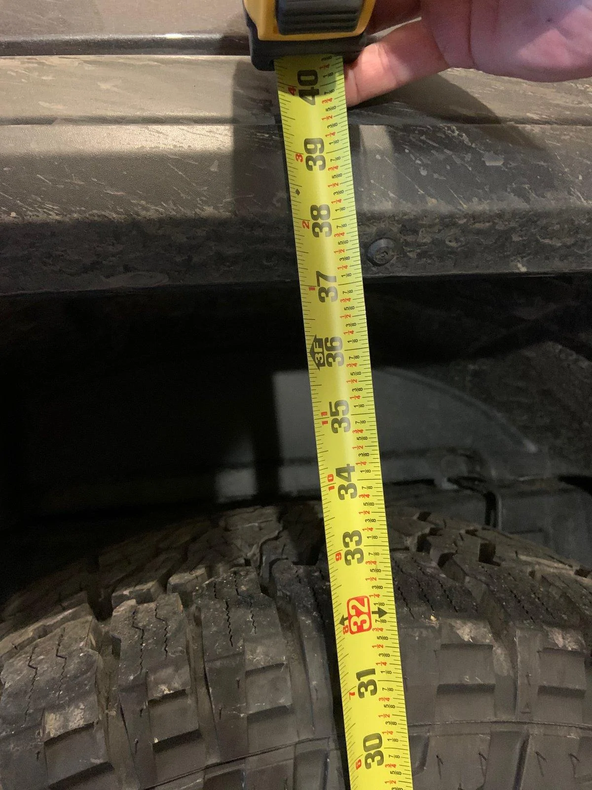

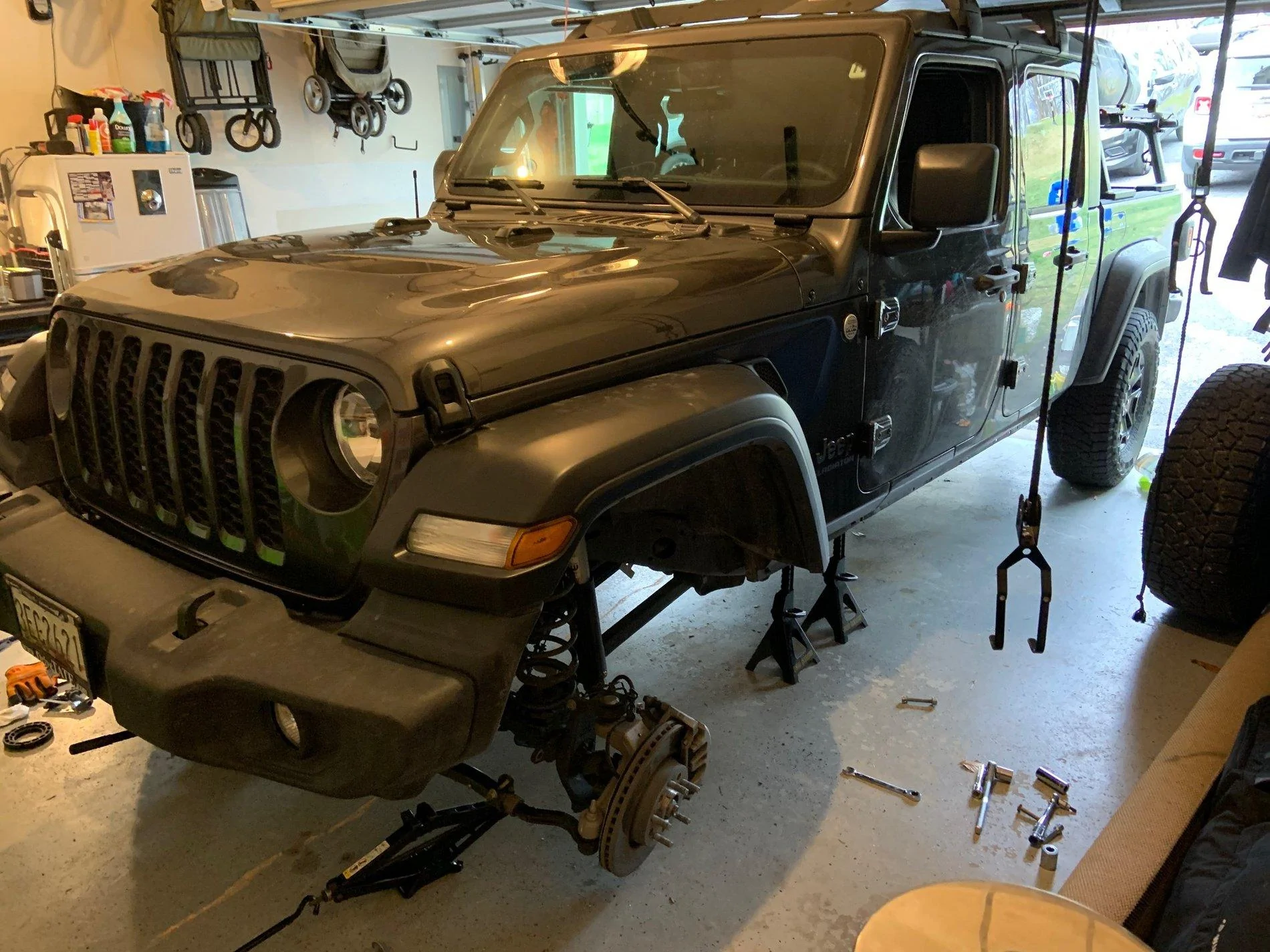

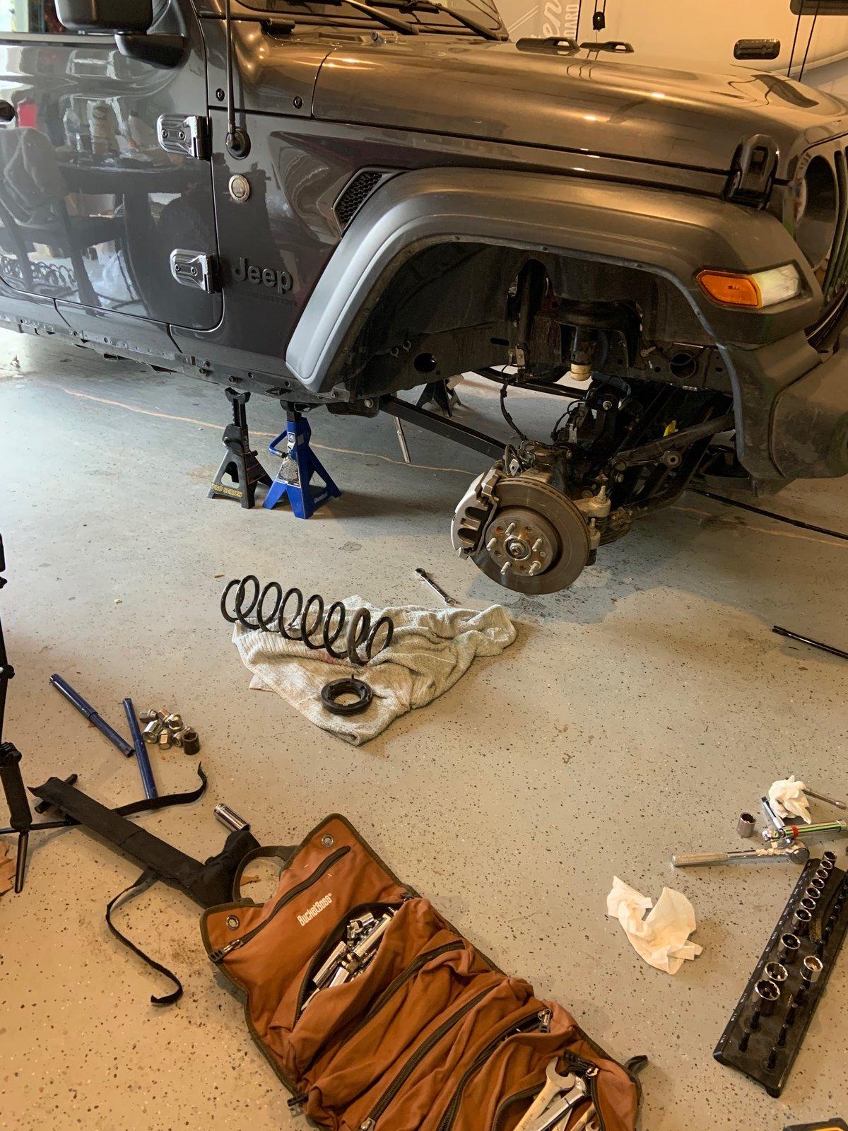

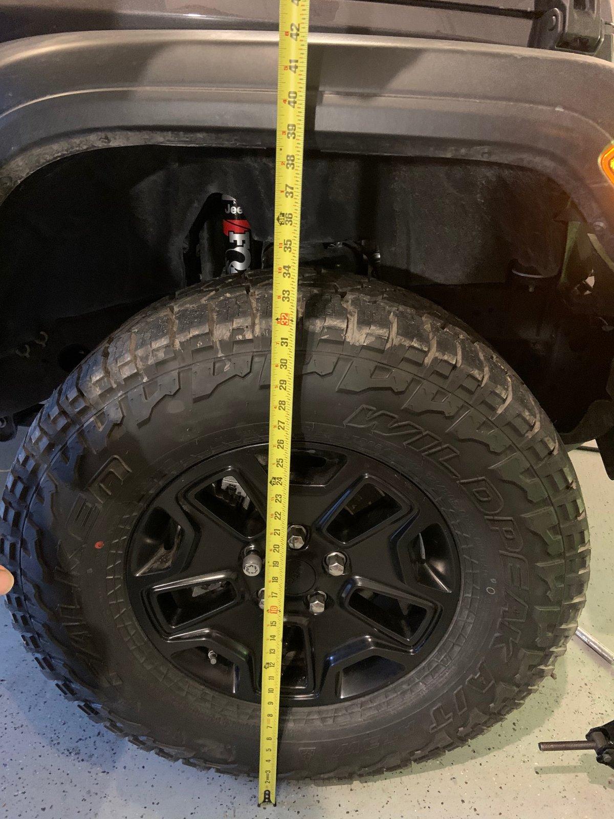

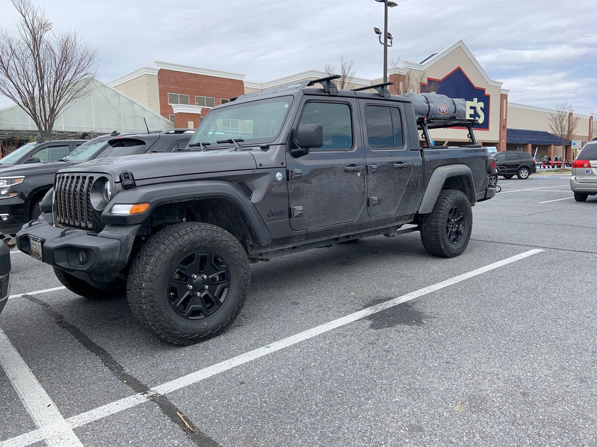

Got the Teraflex installed with the Rubicon take off. Its sitting almost 2" higher in the front and about 1.5" in the rear. The ride is definetely more responsive. I can feel the difference in the shocks. I did opt to only go with the 1" portion of the Teraflex vs. the full 1.5". I believe running 33's it looks fine with plenty of flex. I also installed the 0.75" daystar in the rear at the same time to continue the factory rake. I have the tent on the bed and didn't want to have any sag with the additional weight. I believe it looks good. I also like how I can go back and install the additional .5" later when I add a bumper and winch, should I see a drop in the front. Hats off to Teraflex with a nice design. FYI installing those bumpstop additions is a royal pain in the a$$. Save yourself a few moments for some choice words and a tall glass of "water" when installing those. Ill try and take some better pics later.

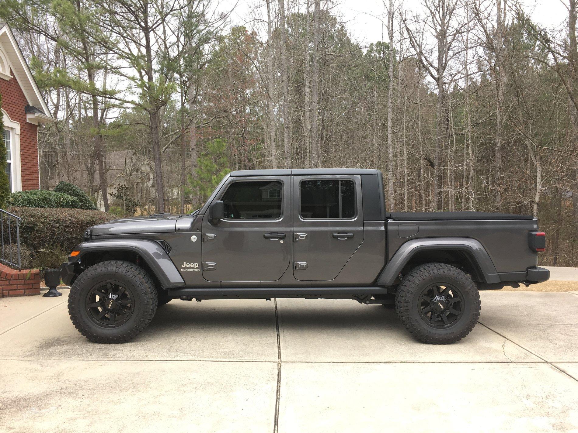

Here's my jt sport s max tow with 35x12.5r17 bfg KO2 no lift winglets removed. Box stock otherwise. Works really good.
