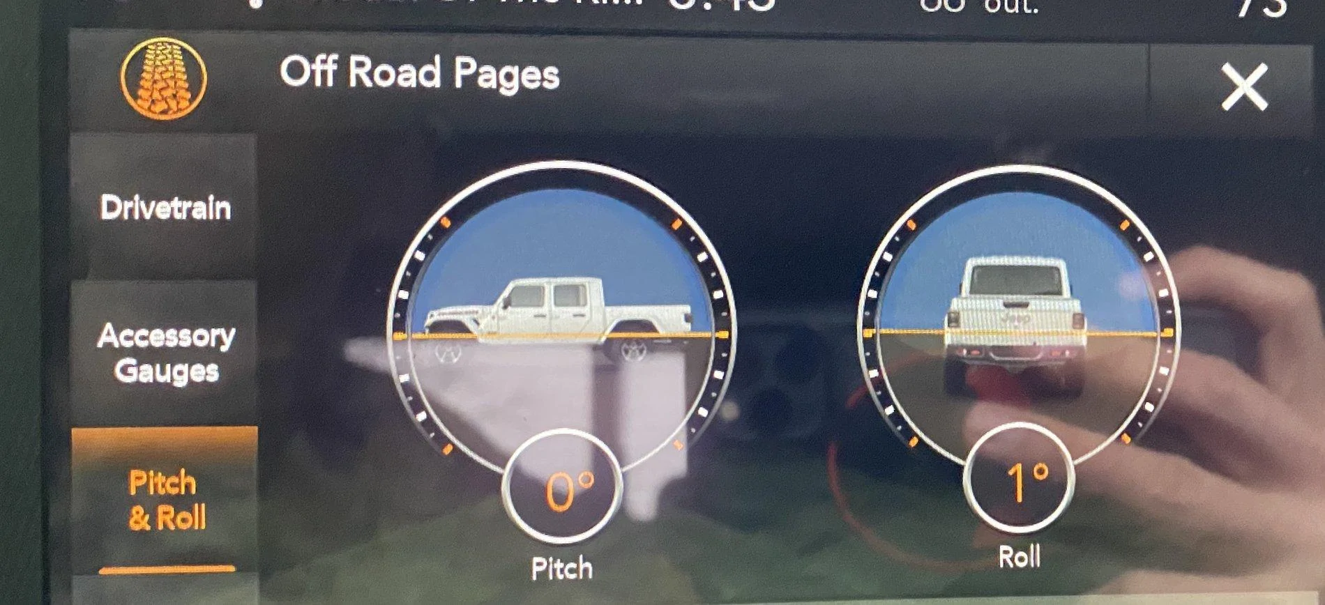

Just wondering who else is getting a 1 degree roll on their Jeep after the mopar lift. It’s been like this since I installed it and I’m curious who else noticed.

Fuel tank.
That’s what I assumed but with them putting stiffer springs on the passenger side you would think it would correct that. No biggy

Yes , gas tank , some of the aftermaket lifts have a thicker spring seat for the right rear to compensate for that giant tank .

I have a 1 degree tilt without a lift.
I usually tilt a bit more than that after a few drinks.......
Oh, wait - different tilt.
And you mean on flat, level ground, a road without a grade or crown to it?
Mine says 0/0 when parked on the level spot by my shop (not much can be called level where I live - it's all up-hill in every direction, coming and going)

Yes. Like in a garage and even at the dealer’s service bay

OP, Tires all the same inflation? Does it drift while driving etc.? If not, I would say you are fine.
No lift on mine but it does read 1* in my shop no matter which way it is parked. Shop is new and def level.
