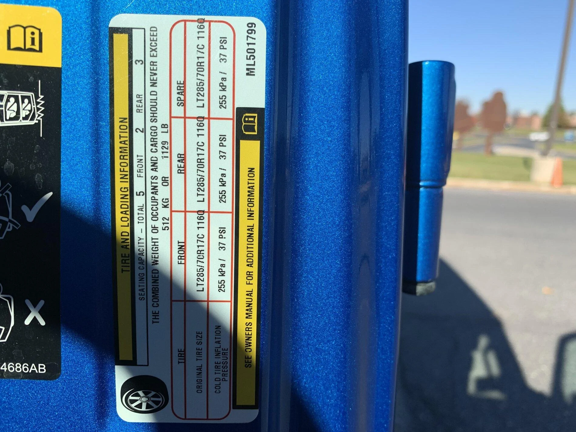

My Mojave is at 1129lbs, with hardtop, auto, seletrac, and those heavy leather seats. I have a 170 pound RSI Steel cap on. I did notice a little sag as the progressive springs lost the soft part perhaps, I put on Icon aluminum 1 3/8” spacers put rear at same as front now still rides great. I want to put more stuff on like refrigerator (32pounds), bed insert for sleeping with a stove and sink pull out under it, front runner 10-15 gallon water tank, and porta pottie. It all adds up quick, roof top tent will never happen as I slept in bed twice earlier, so setting up a rig to allow me to be self contained to stay on some beaches overnight. Wife is not really into it, but I did just buy a 19 foot camper (3200 lb. Dry, 4000 max.) for more room, she loves me and won’t even care that I already bought a partner stove, stainless sink , and expensive 48” drawer glides, of course she doesn’t have to know about the genesis dual battery system right, I have two batteries already not really an upgrade! Gladiators are more like oversized JL then trucks but work perfect for my needs and love it!…..Jack
