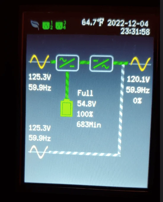

It’s adjustable via its app. I selected 200 watts which it does honor when I plug it into my house AC.
The question on wattage depends on the actual voltage under load.
Our home outlets receive 125 volts.
At only 120 volts, 200 amps is 1.6 amps
If the Jeep outlet drops to 110 volts under load, that 200 watts is going to go up 1.8 amps.
Even higher amperage draw at lower voltage. Most devices I've worked with take down to 100 volts as normal. It's only when things drop into the 90s it's deemed as a real issue.
At 100 volts, you are riding 2 amps.
I can see the reason for the comments on converting 13 volts to AC, then back to DC again when it charges your station. It's a double-loss thing.
178
29,084
34,569
Our house voltage and frequency - 125.3 volts, 59.9 Hz
