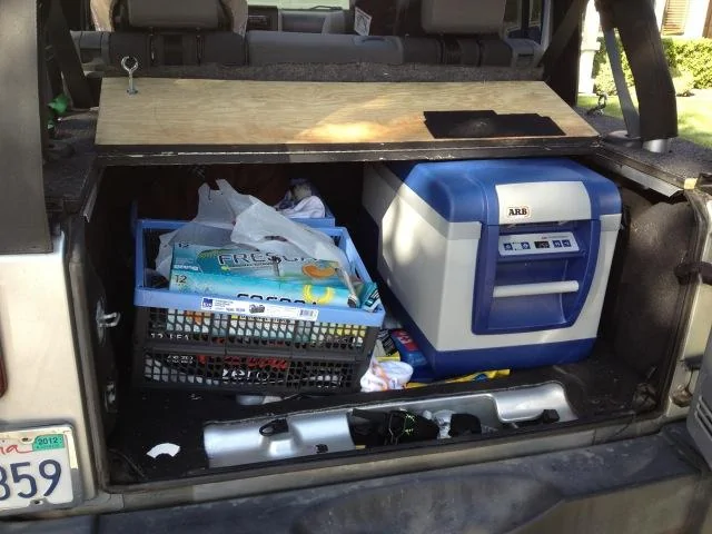

Not that you asked, but I’d seriously look at an ARB over the dometic - they are rated to operate at 30* off level, whereas almost every other portable fridge isn’t, and you risk damaging the compressor if it runs while you’re not level.
My ARB has been absolutely bulletproof, and draws very little juice. I ran a dedicated 12v line for it in my JK and it could keep my mexican coke bottles cold for 3-4 days and the Jeep would still start up.

I'd say if your bed was covered in any way you should be good to go - you'll want to minimize dust and water, but you don't have to 100% eliminate it. I'd throw mine in the bed uncovered for a day or two, but wouldn't run around like that forever... I did leave mine in my JKU 24x7, but even when I was roofless (6-8mo/yr) I had a plywood cover over the cargo area.

Before you go using that 110v outlet, check to see what the native power is for the fridge, most are DC. It would really be a huge waste to convert from 12v DC to 110v AC just to have the fridge convert it back to 12v DC internally again. You’d probably use 2x the power doing that.
As for the snomasters, those dual compartment models look nice - way too tall for what I bought my ARB for though, I needed something that was the same height as my JK cargo box, which this was. Fortunately that means it will fit under a tonneau in the ‘8r bed as well. I couldn’t use a snomaster in an ‘8r unless I had a full height topper, which I personally don’t like.
