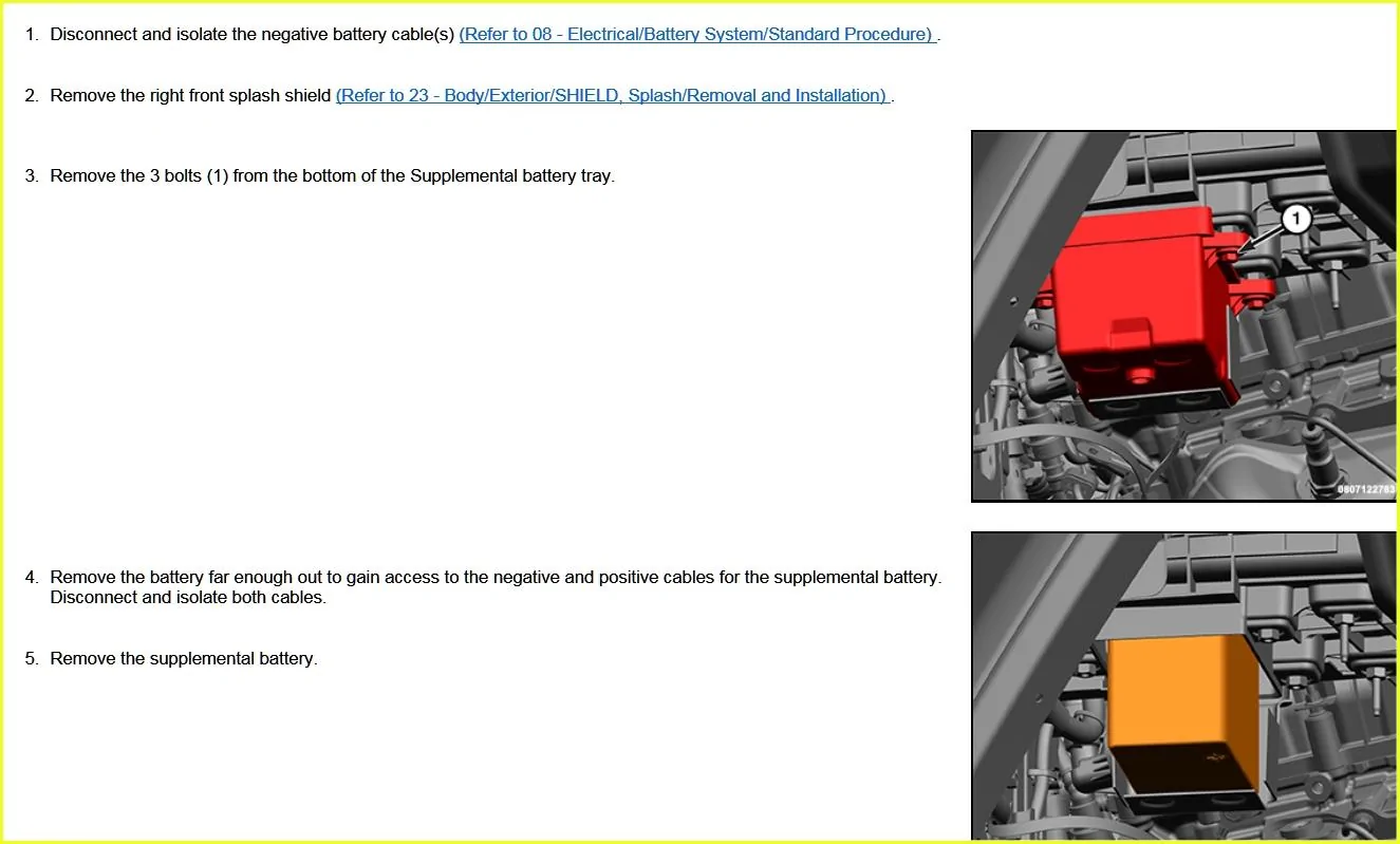

Anyone take pics of this? I guess the aux battery is under the main battery?
Under PDC/fuse box. Remove right front fender liner/shield and you can access it via the back of the RF wheel well. If you want, you can also pull the PDC/fuse panel but that can have its own issues with connectivity, etc.
This is "by the book" ->
Jeep Gladiator 14-BS Motorcycle Battery Experiment aux-replace

4,407
Pennsylvania
Where does one purchase "the book"? I used to buy Haynes and Chiltons manuals for everything.
That image is from a google image search I did a while back.
I wanted to know what I was in for "just in case".
I ended up not taking mine apart but splitting cables, disconnecting, up top to charge the batterie independently.
I also read what the tech who checked my batteries wrote on the repair orders to confirm he went in through the wheel opening, removing the shield.
