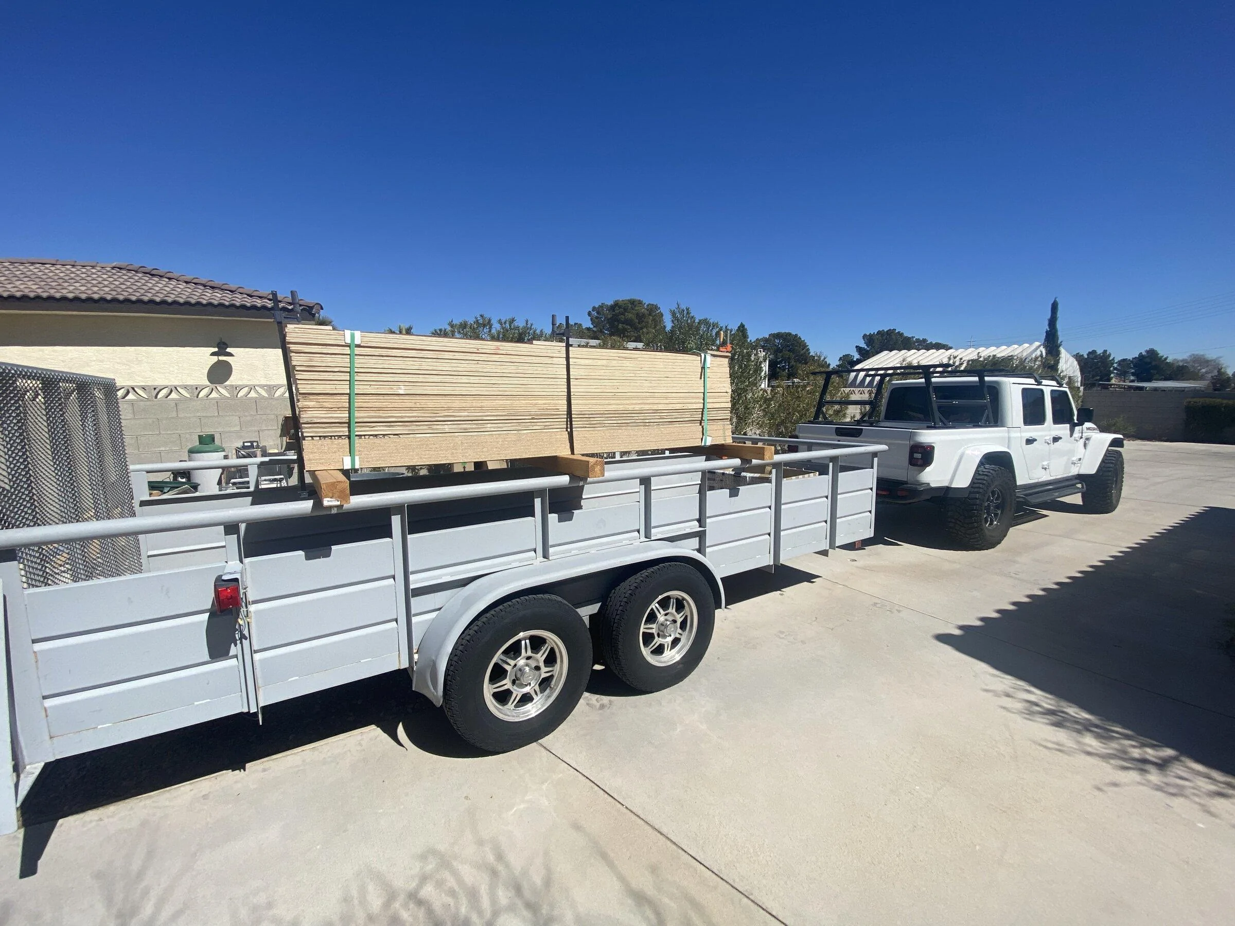

I am looking to put 35's on my Mojave with stock suspension. Not looking to go any wider than 11.50 so I can run the stock rims. I also have a set of 18" x 8.5" rims I could switch to. Mostly a daily driver with frequent treks on the beach and some mild trails. Tow a 3000lb travel trailer once a month for weekend trips. Should I keep the 17" rims or switch to the 18's? Pros and cons? (I know I don't need the 35's but hey , I like the way they look)
I went with 18” Motive glock wheels with a +18mm offset. My main reason is I plan on adding 6 piston big brakes , which need 18” wheels to fit. I routinely pull a trailer 4-5000lbs that does not have brakes. And although the Gladiators brakes are very good, they will benefit greatly with the larger calipers. If my trailer had brakes, the stock brakes would be fine.
