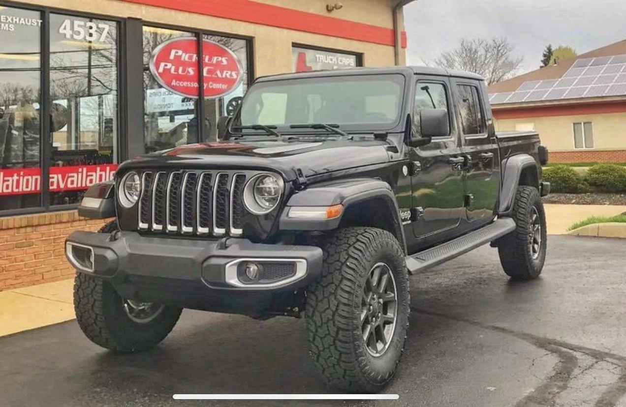

Discount's website let's you know what will fit/what they are authorized to install. Based on the website you can put a 37/12.5/18 or 305/70/18 on a 7.5" tire. Here's 37s on 18x7.5 Overland wheel
Jeep Gladiator 18" Tire Size Recommendation img_3925-
Looks great. Which tire did you go with, and how much of a lift if you don't mind?

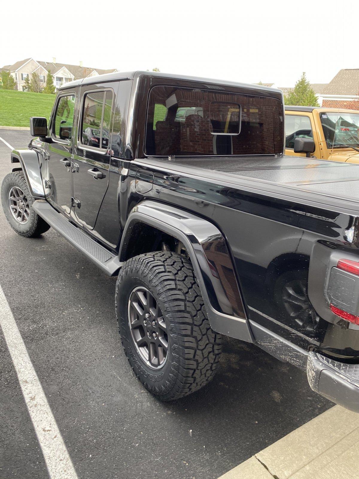

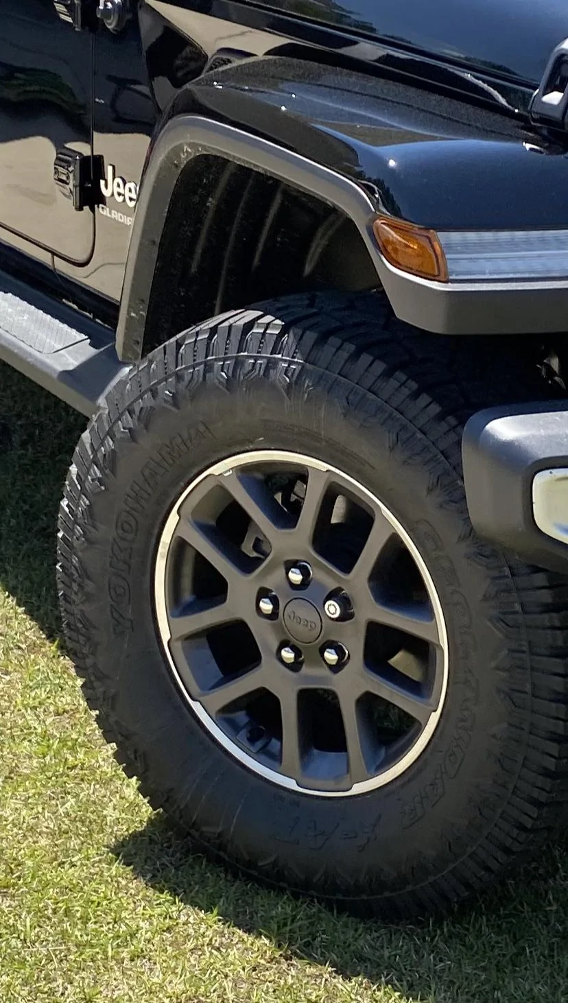

Here is mine with the stock 7.5” overland rims on 295/70r18 Yokohama Geolander AT. Yokohama offers a 30 day guarantee that allows you to return them if you are not totally satisfied. They also have a great tire mileage warranty.
Since the rims are 7.5” wide, I added a Spidertrax 1.75” wheel spacers and 2.5” SST lift to gain the look I wanted. Also had an adjustable steering stabilizer added.
