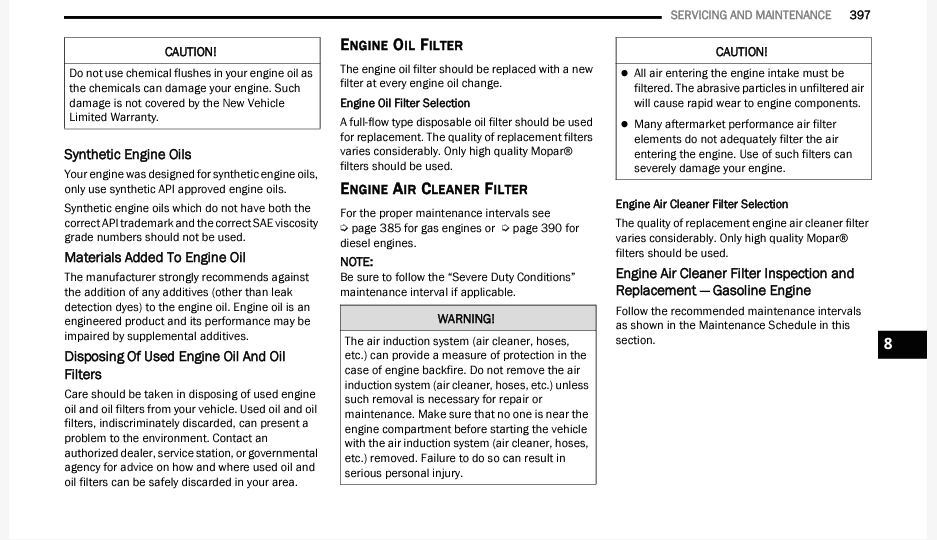

This is from the 2022 Jeep Gladiator Manual.

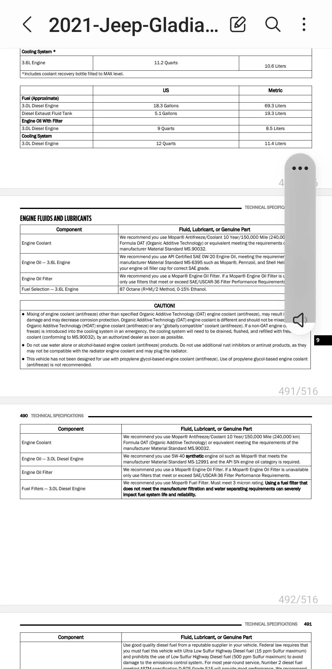

This is what my dealer uses on mine.
Mopar 68522999AA
Max Pro 0W-20 Synthetic Motor Oil
