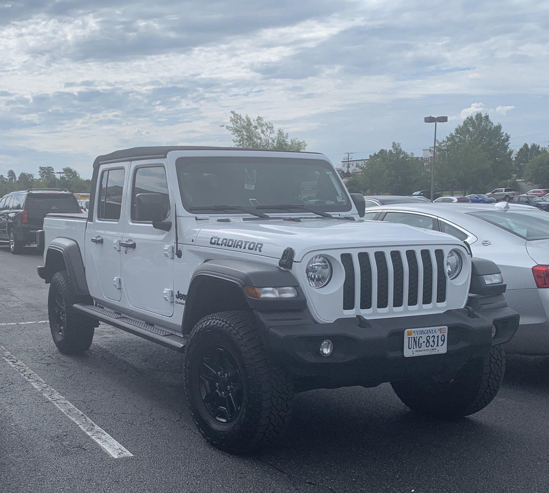

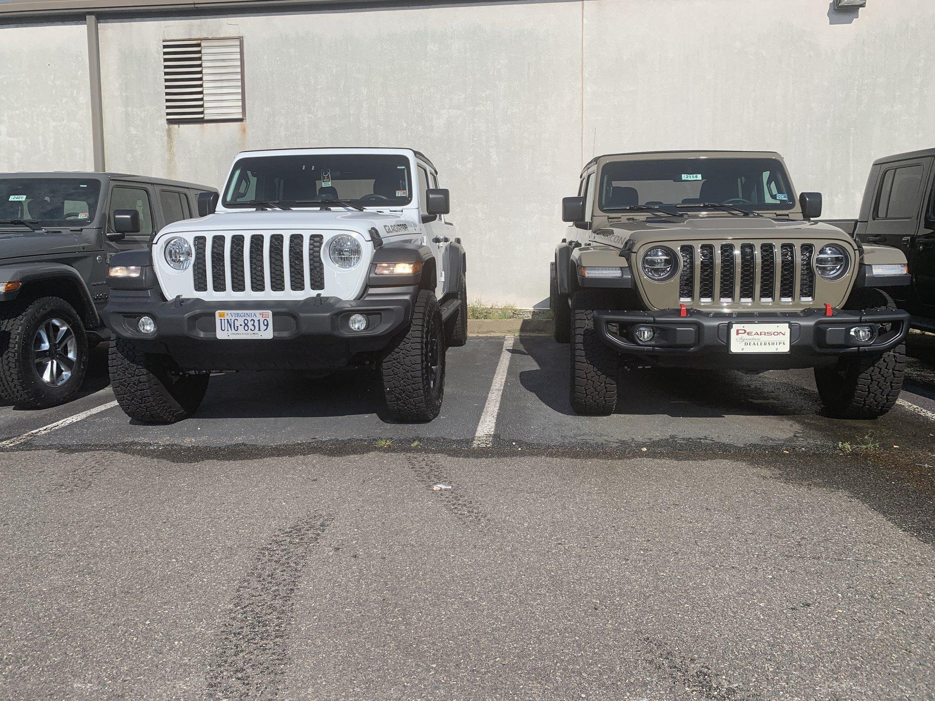

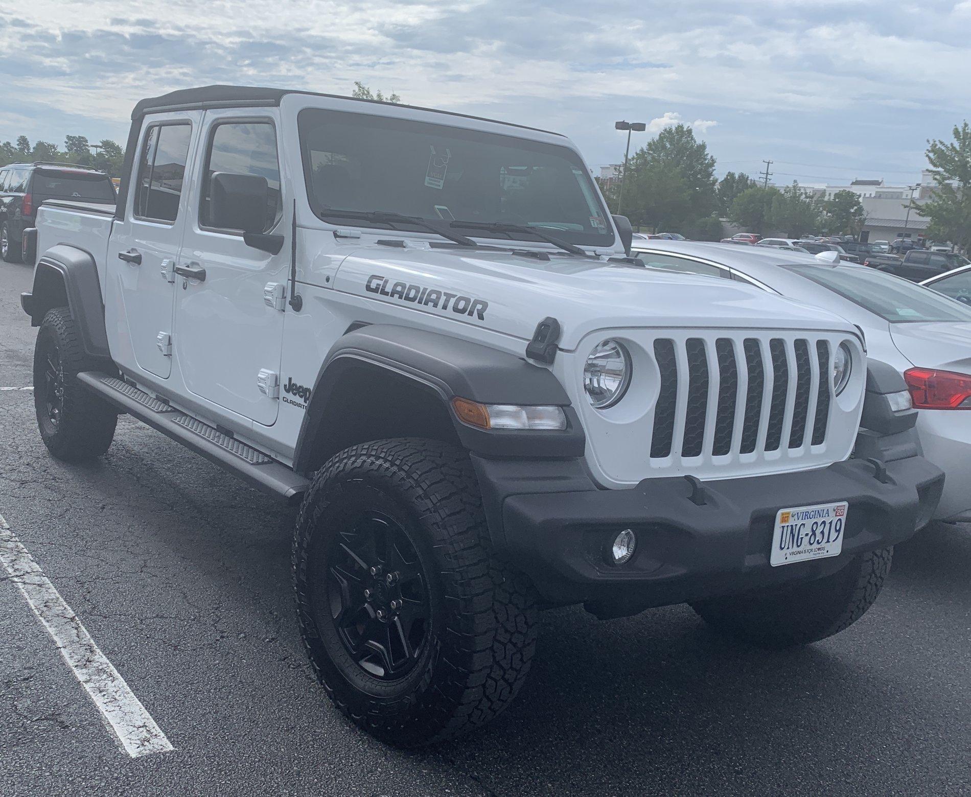

My current set up is a max tow, takeoff 19 rubi rims, 285/75r17s wildpeaks (close to 34s), Fox steering stabilizer, iron rock 2” spacer lift, also put on JT rubi shocks and front springs.
Any ideas on the affect on towing capabilities besides weight of things added (maybe 70 lbs)?
honestly it drives better and more stable than stock form. First picture is beside a stock JT rubicon.
thanks!

My Swag would be probably down to Rubicon with HD tow package or slightly less than that, maybe 5-10% reduction of towing capacity. I got a Max-Tow not to try and tow it's maximum every time I tow. But to be able to easily tow 1/2 to 3/4 max safely under any conditions. Something to use as a comparison: a winch bottom wrap max pull, with a reduced amount of 10-20% per wrap over that. You have increased tire size by what % so you can reduce the towing capacity by that amount plus a little more. Rolling and wind resistance, braking reduction bigger tires =bigger lever. More engine and transmission load. But your terrain, weather, road conditions and what you are towing boat or V-nose vs flat nose trailer come in to play too. The big part of why I bought a 16ft Scamp T.T. was that it was well with in towing capacity of my LJ it was rated for 5k the Scamp is around 3000/3500 lbs. Dry wgt.
