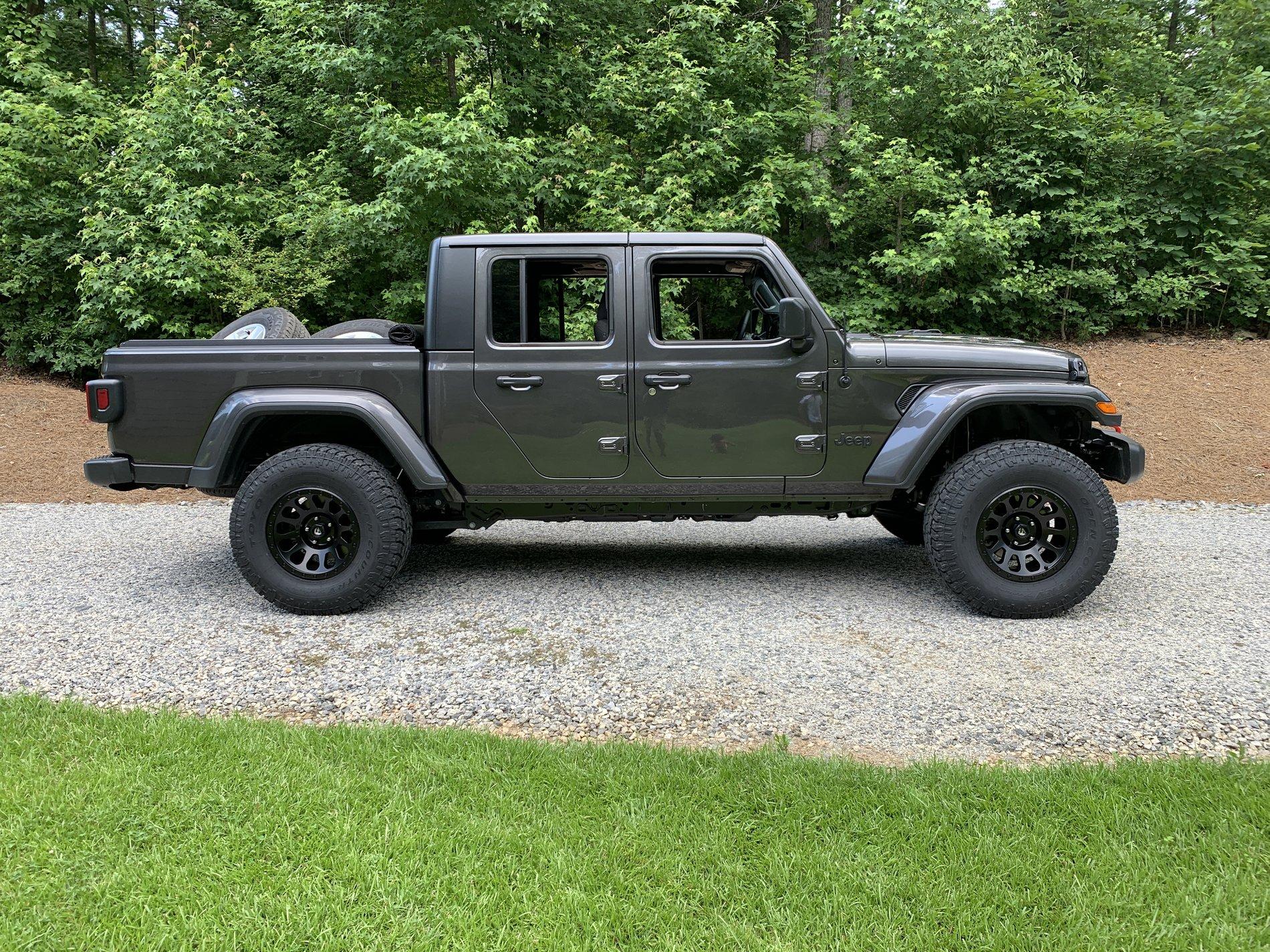

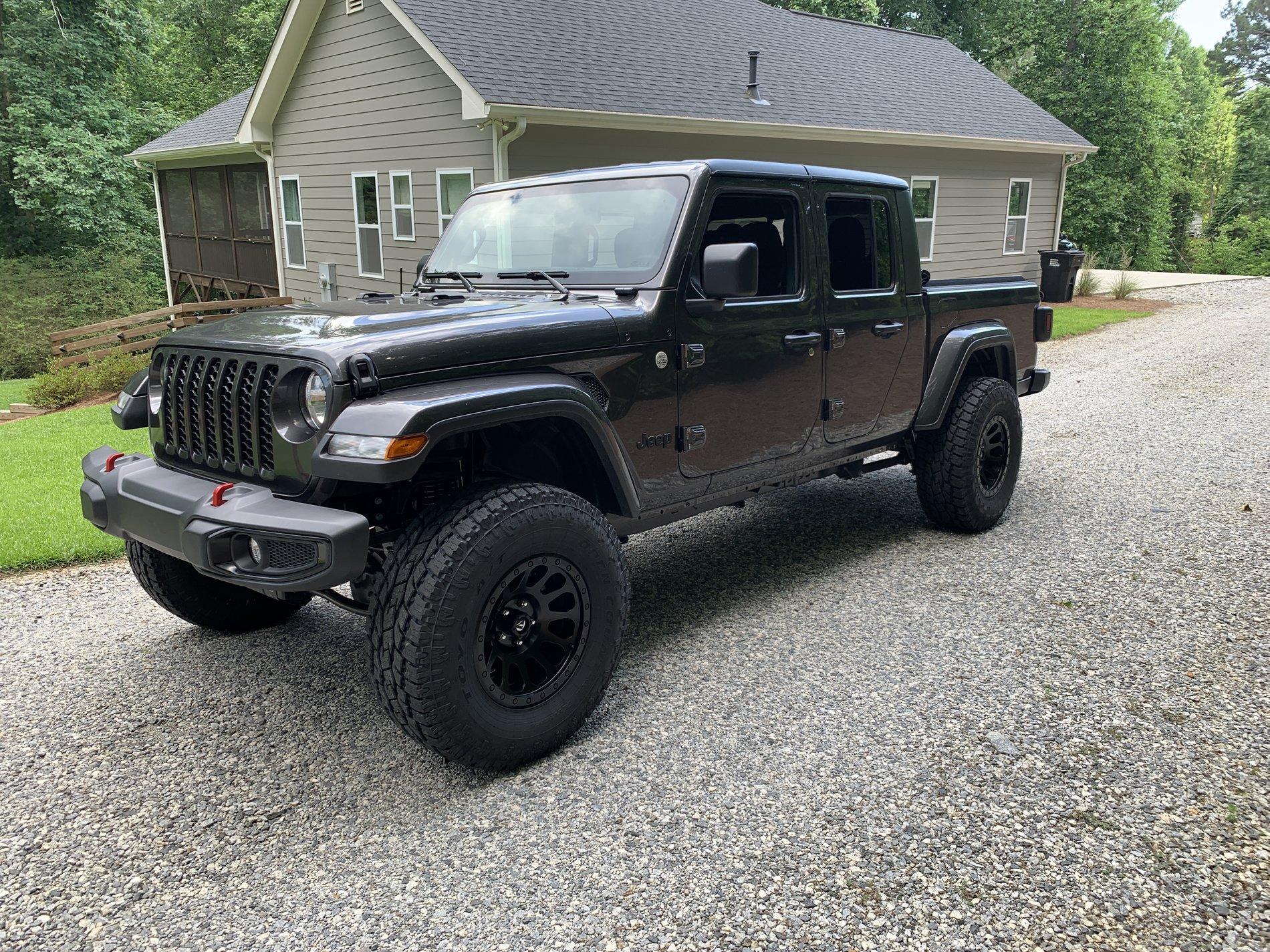

2020 Gladiator
JKS 3.5 with additional front LCAs was $1800 installed for me. Comes with everything I needed for mainly on road use and has a nice firm ride compared to stock. Handles corners much better and doesn’t bounce around. I love it and don’t feel like I need anything more. If I was a serious off-roader I would go for a complete kit with all four control arms and all that jazz, but I don’t need all that. Looks great with 35s, but plenty of room for 37s.

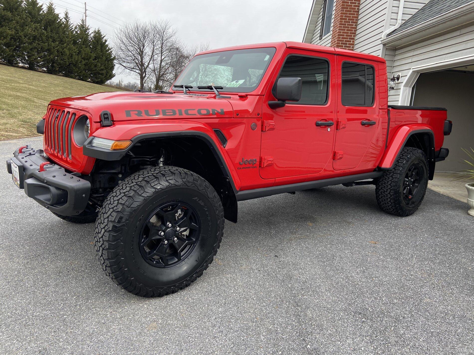

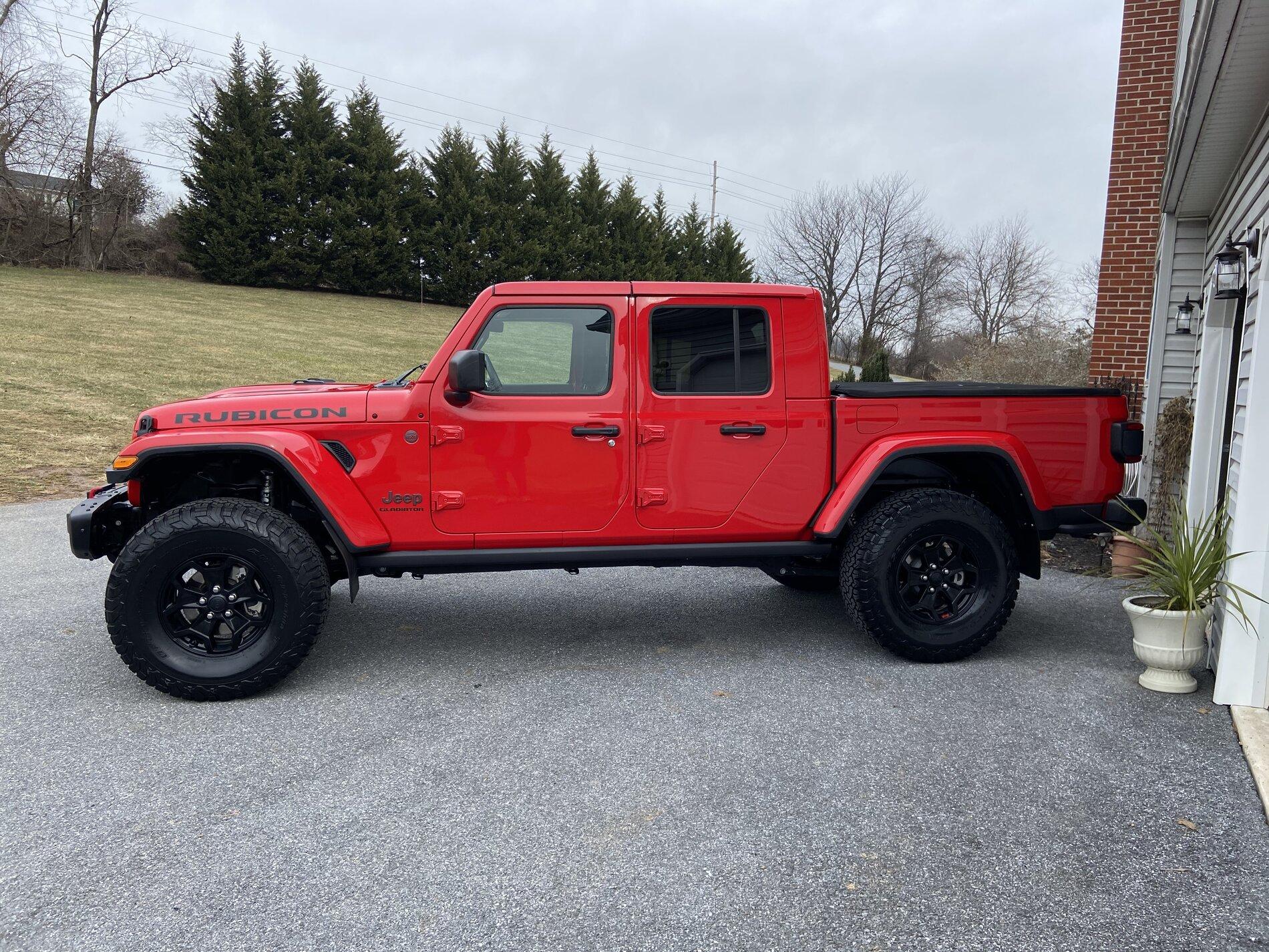

learjet
Gene
Aug 18, 2019
29
32
FL450
Rubicon LE
heres mine with mopar lift, 37” KO2s. local dealership sold me the kit, $1300. took my son and I 5 hrs to install. I did add a 1/2“ spacer to the front for mounting a winch in the future.
overall happy w the mopar lift for the price. my front axle is shifted 1 inch right, and inhave a bit of rubbing on the Right LCA at full left turn. Adjustable track bar should fix. if you go mapar id plan for an adjustable track bar. still i decent option with the other lifts not including shocks
hth
lear
