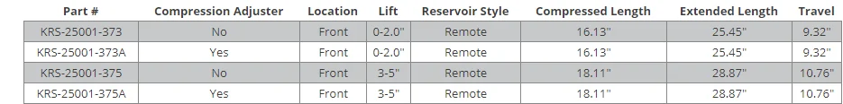

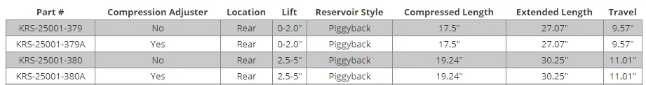

i'm just curious though what length shocks (extended / compressed) I should be pairing with this kit to avoid any front drive shaft mods? I do want adjustable shocks front and rear.
It appears that the King fronts come in a 0-2.0" and 3-5" (not sure where the 2.5" falls)
Jeep Gladiator 2.5" lift question for a 600lb constant load Alu-Cab Gen 3 RTT'd JTR 1592776132543
Also the King rears sort of fall into that in between space...
Jeep Gladiator 2.5" lift question for a 600lb constant load Alu-Cab Gen 3 RTT'd JTR 1592776268812

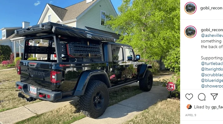

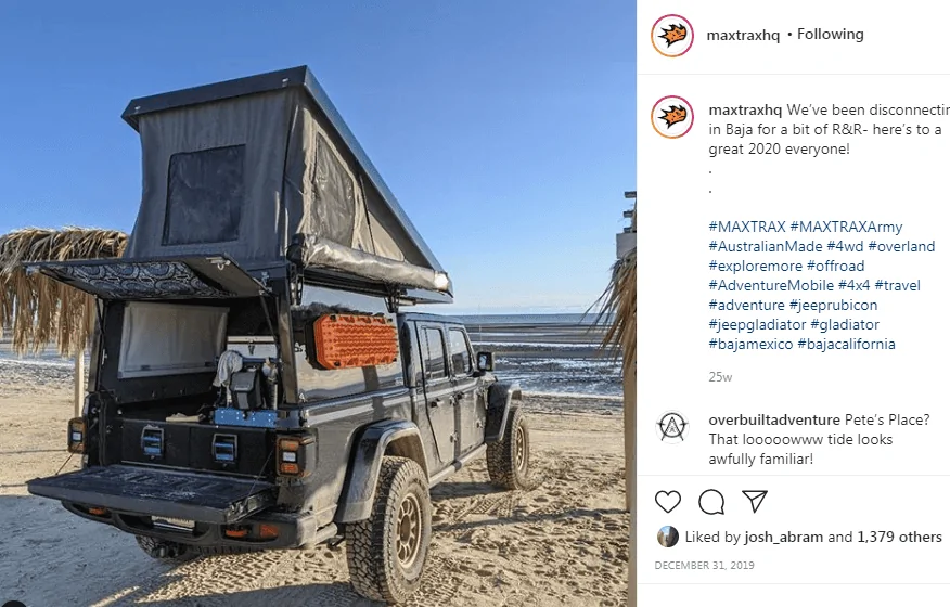

So I have spoken to (2) JTR owners with similar constant load situations. BOTH of them run the Mopar 2" lift and BOTH of them threw the Fox shocks in the trash. Both said the shock valving was wrong for the weight.
User #1: IG @maxtraxhq = AT OVERLAND SUMMIT (~340lb) and drawer system (unknown)
His comments: "Mopar lift Fox shocks have crap valving for the weight, I put King adjustables on all 4 corners and haven't looked back. I also run a Hellwig rear sway bar and it's essential"
Jeep Gladiator 2.5" lift question for a 600lb constant load Alu-Cab Gen 3 RTT'd JTR 1593094832068

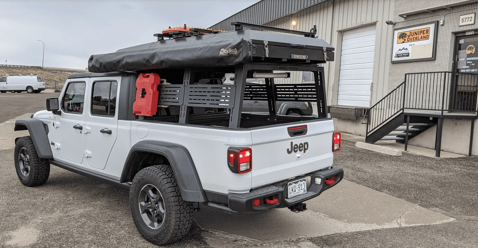

User #2: IG @gobi_recon = spoke with him when he had a Rebel Off-Road full rack and RTT (~400lb)
His comments: "Found the rear shocks (Fox 2.5s) to completely under-valved and replaced with Falcon adjustables. I also like a little rake and I added a 3/4" spacer in the rear"
Jeep Gladiator 2.5" lift question for a 600lb constant load Alu-Cab Gen 3 RTT'd JTR 1593094882157
