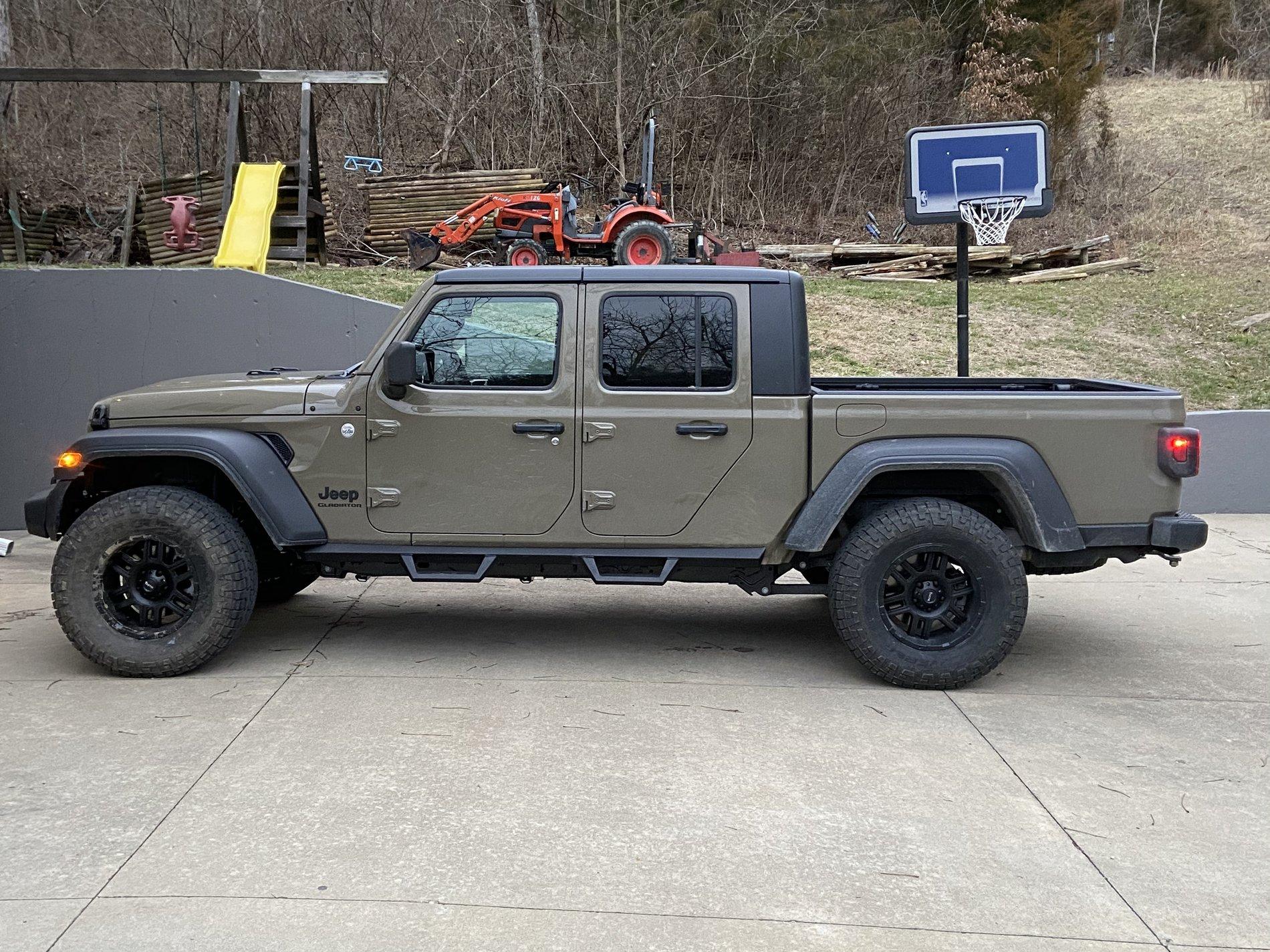

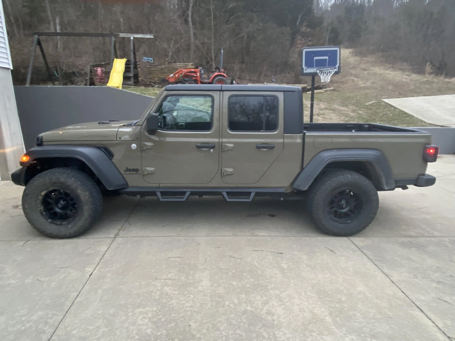

I had the readylift 2.5" SST lift installed and absolutely love it. Mine rides same as stock or better with this kit installed. No need to change the factory shocks they ride just fine. Mine on 35's with no lift and with the Readylift installed
No lift
With Readylift
https://www.northridge4x4.com/part/...eadylift-suspension-2-5in-sst-spacer-lift-kit
I was out the door at my local shop with alignment for $802.00
