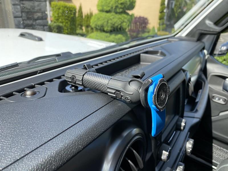

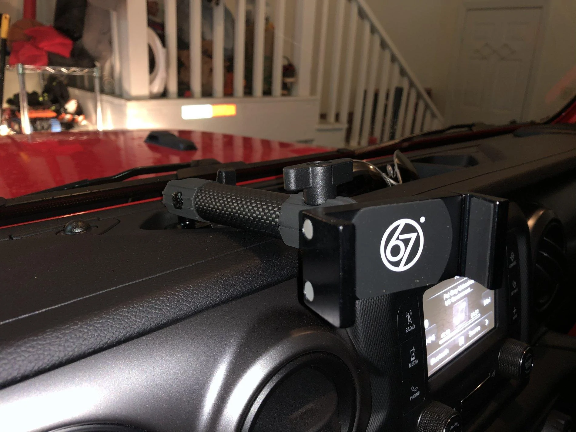

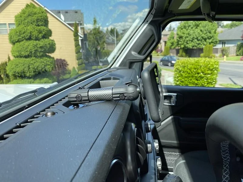

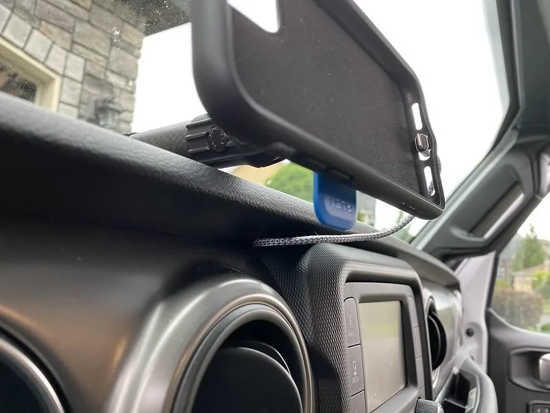

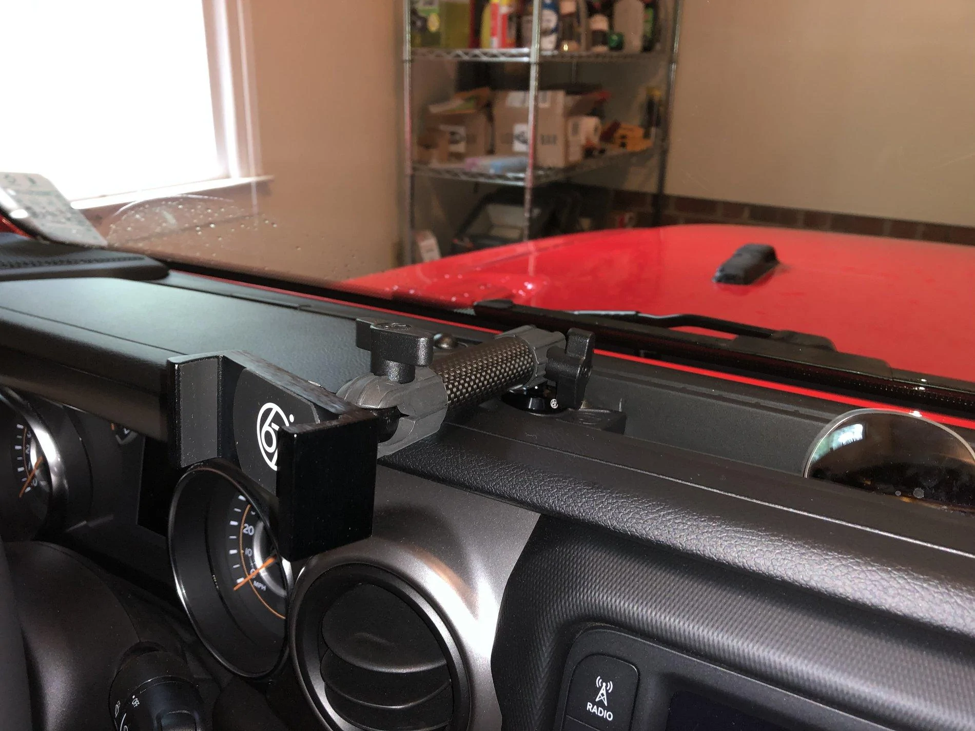

Never thought I would drill holes in my first new car (well, on the inside at least) but after seeing some inspiration, I went forward with the following mods.
I ordered a 67 Designs mount, mini bar and RAM ball attachment. I won’t bother you with a 67 Designs review. Its solid, and there are plenty of other reviews out there. This pairs with a Quadlock motorcycle ball and the Quadlock case. I use this case and mount with my motorcycle, and if its good enough for 100MPH… its good enough for the jeep. Putting the retaining screw in was the first hole I made in the Jeep, and while unnerving, the results are worth it. The mount is rock solid.

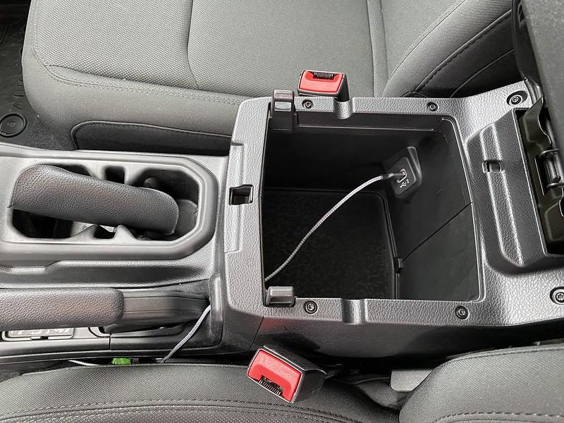

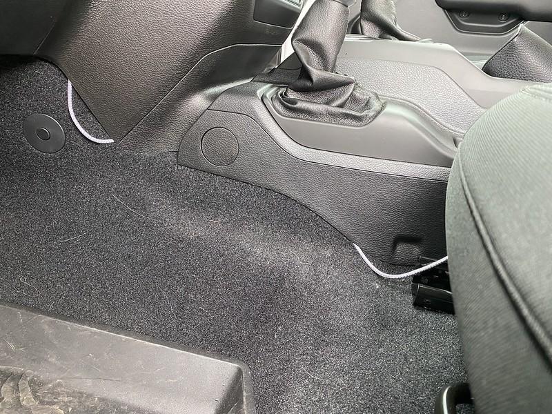

The next hole was done after seeing another member’s very clever placement of their phone charging cable. Simply punch a hole in the center console behind the gasket for the parking brake. From there you have a much easier to work with cable than having it dangling from the dash. Plus it allows me to keep it permanently plugged in and let other’s use the forward USB ports when they need.
Jeep Gladiator 2 holes in a brand new Jeep... Perfect Phone mount setup! 49913832868_cd13a00964_c
From there I tucked the wire behind the plastic molding. It hides extremely easy. Tuck it behind and then shoot it up the back side of the dash.

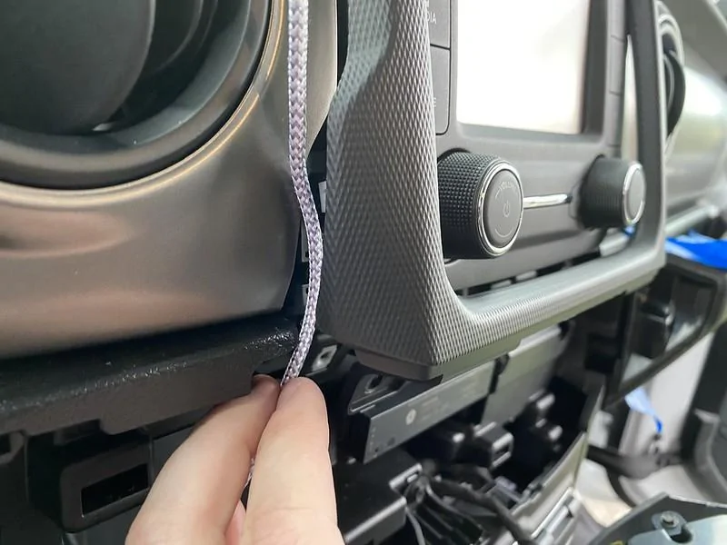

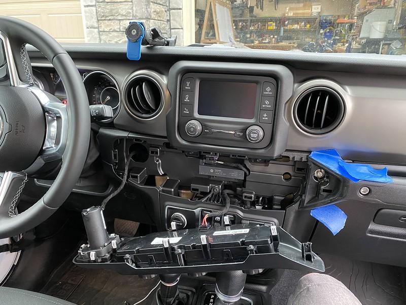

The next task was to pop out the climate control. I followed a tutorial on Youtube and everything went smoothly. It is quite tough the first time you pop it out, and it will feel like you are about to break it. Just go slowly and it will eventually break free.
Jeep Gladiator 2 holes in a brand new Jeep... Perfect Phone mount setup! 49887077173_c697e9ab92_c
From there snake the wire up and behind the bezel for the screen, which requires 2 screws to pop off.
Jeep Gladiator 2 holes in a brand new Jeep... Perfect Phone mount setup! 49887906062_96f7b76358_c
Jeep Gladiator 2 holes in a brand new Jeep... Perfect Phone mount setup! 49887906057_aedcf71b0d_c

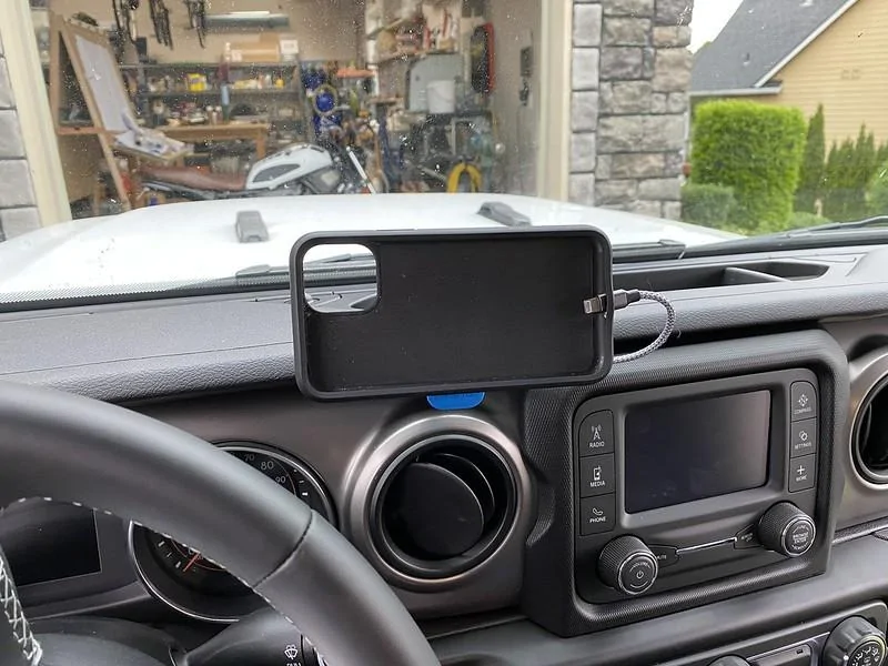

At the top of the bezel is just enough space to pop the wire out, and viola, the cable is right next to the phone mount. I measured the wire so that I have a bit of flex and don’t put strain on the phone/wire, then buttoned everything back up.
Jeep Gladiator 2 holes in a brand new Jeep... Perfect Phone mount setup! 49887593306_68d2d31c0f_c
Since this is my daily driver, having a phone mount is an absolute must for directions, traffic, calls and music. This is one of the cleanest setups I’ve seen, and far better than how I had it originally!

True, but the plan is to get one of the security console inserts, which negates the use of those side holes. I wanted it to be as out of the way as possible.

How long does the phone cable have to be to reach from the console up to the dash mount?
Oh forgot to mention that. I used a 6 foot cord and that left me enough to work with. Might be able to use a 5 foot cord to make it work, I didn't pull it super tight.

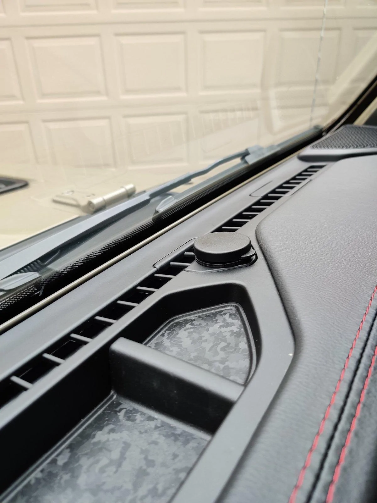

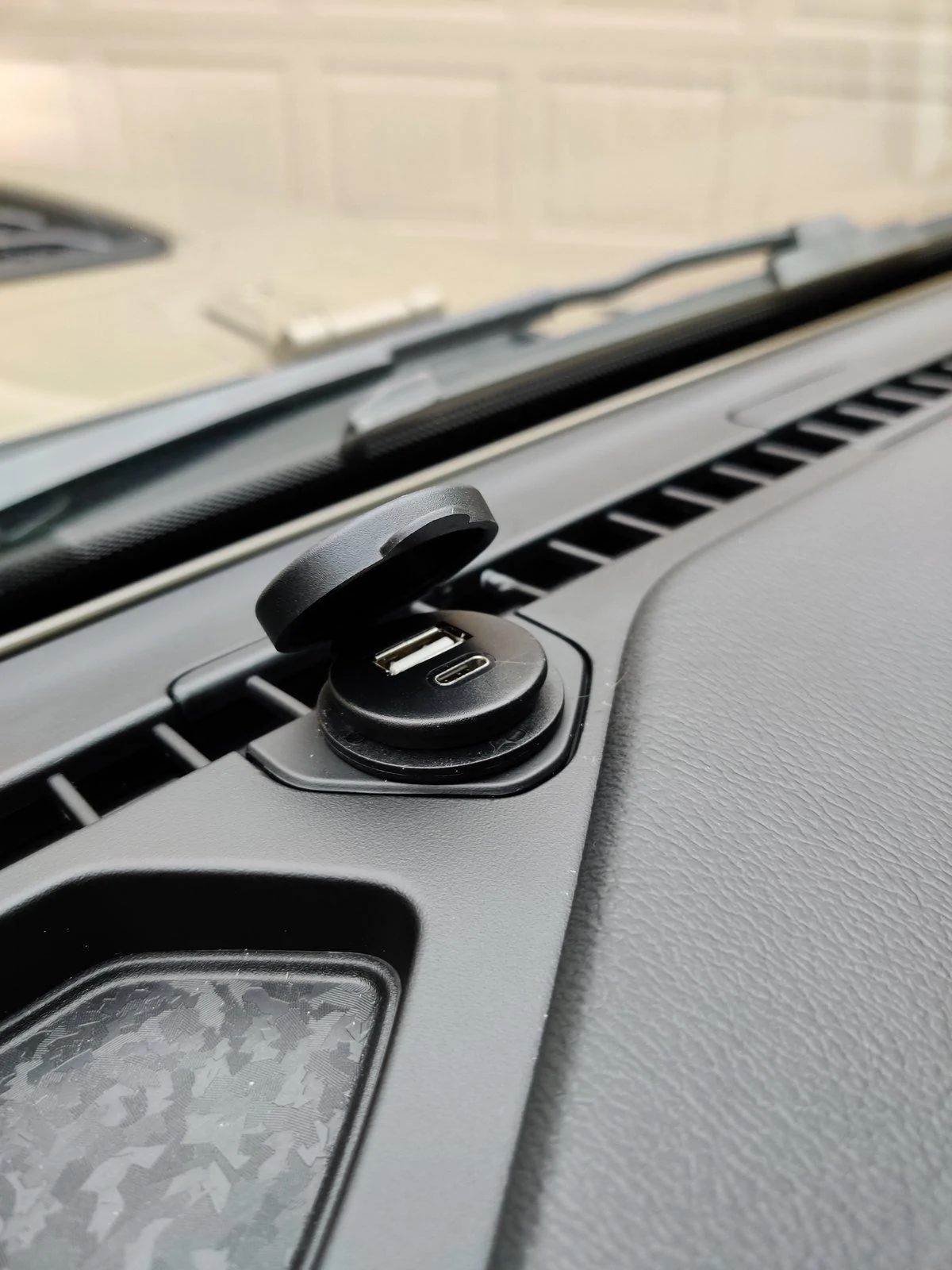

Just added a USB and USB C to the dash and spliced into the back of the "Media" USB and USB C to give me Android and Apple at the center of the dash for phone holder, dash cam, radar detector, etc...

Mind sharing a link and how to for that?

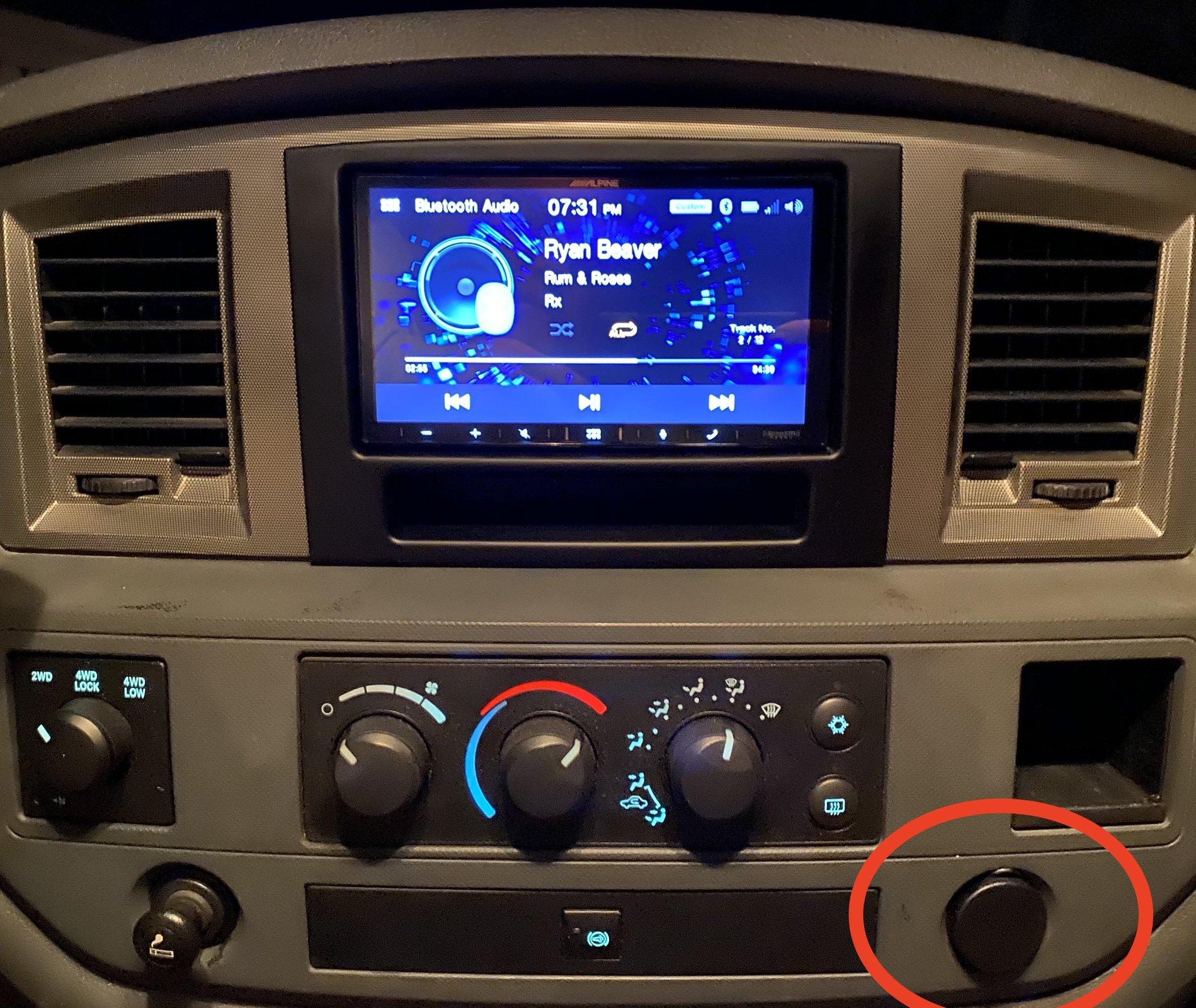

Same here! I like that idea! I did something similar in my 2007 Ram 2500, were I replaced the passenger side 12v plug with a USB 3.0 plug that plugs directly into the back of my Alpine ILX-W650 head unit so it charges and does full Apple CarPlay/Navigation/iTunes and full phone control through the head unit.
Red circle bottom right screen...

Hey bud. Gladiator noon here. Hate to resurrect this. Can u share how u did this? Thx in advance.

Yep, really interested in how you dis this. I am also looking at doing this with a 12 volt plug as well.
