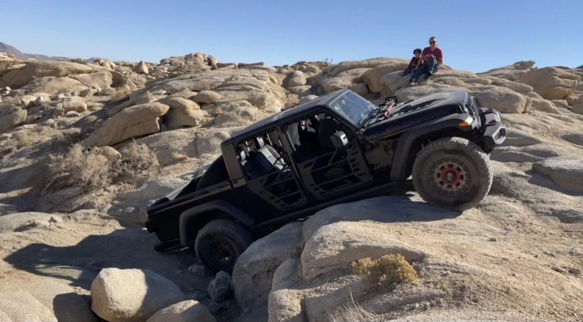

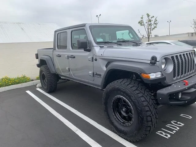

I have a 2ā€ mopar lift with 37s. I do get an occasional rub when flexed. But nothing crazy. One thing I would recommend is an adjustable track bar just to make sure your geometry is correct. I havenā€™t updated mine just yet and Iā€™m getting a rub on my front passenger inner fender line. Againā€¦ Itā€™s nothing crazy. In fact I didnā€™t even notice it was happening til I saw it when parked. Iā€™ve actually only heard it rub ONE TIME at cougar buttesā€™s bullfrog and I belive it was in the rear. But when o checked everything was fine. šŸ¤·ā€ā™‚ļø
Iā€™ve been looking into a little fender chop myself. Definitely inexpensive compared to an entire fender swap and it does provide a slight clearance with a more agressive look.
I donā€™t know about leaving the inner fenders off like what he did in that vid though. I havenā€™t experienced it myself but from my understanding the engine bay would get pretty bad & potential damage from All the debris.
below, Iā€™ll post what I did fit 37s on a 2ā€ lift.
-mopar 2ā€lift
-wheels 4.5 back spacing w/ -12 offset
-ko2 AT3
-alignment
-recalibrated speedometer
thatā€™s it! I believe the lift comes with bump stops. If not make sure you ask for them. They definitely help. I also made sure I went with a Look and weight I was comfortable with. I went with k02s because I tried to trim as much rolling mass as possible to still run my 4:10ā€™s. Does it help?? Not to sureā€¦ but I am getting 19mpg. Part of that also comes with the weight. Thatā€™s also why I went with k02ā€™s. I originally wanted FALKENS but noticed they are SUPER HEAVY. All in all- I believe I it was a +29lbs per tire/wheel (including spare) added. Iā€™m pretty happy with my set up so far. Iā€™ve been to Moab like 3 times, Arizona, and a tome of local trails. Iā€™ve added a winch Andy RTT and Iā€™m still going string in the 4:10ā€™s. Iā€™ll run it it for a little more to determine if the 4:88s are a must. Ohā€¦ and I do see 8th gear unless Iā€™m climbing up hills. From there Iā€™ll basically stay in 5th-6th. Which is fineā€¦ I mean I am driving a Jeep right? Lol
