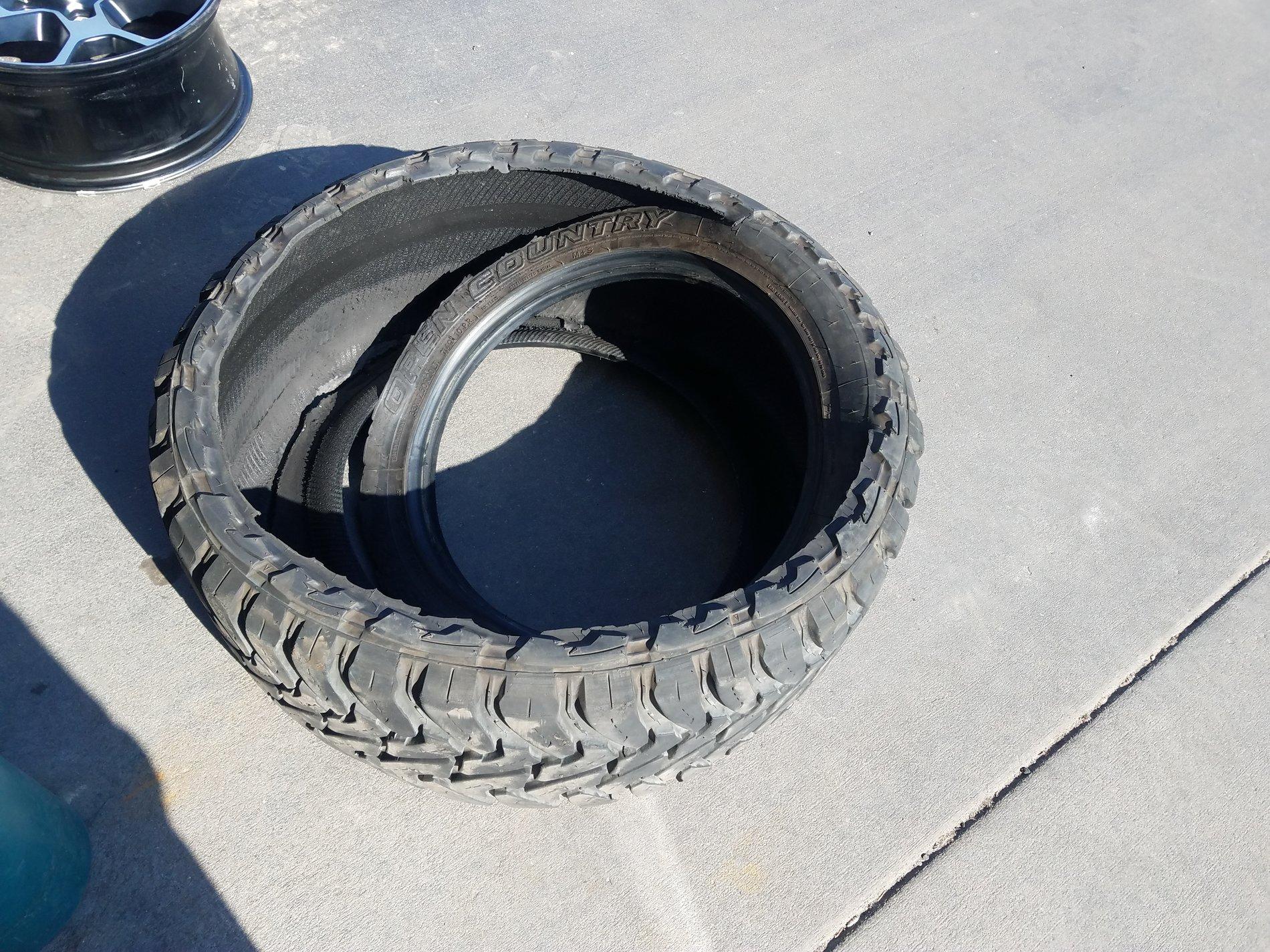

Jeep Gladiator 20 inch Fails 20200722_170558

Airing down?.... I'm of the belief that one should not run larger than a 18" for any type of off road driving
I agree for the reasons above plus less tire more wheel is just asking for a cracked wheel on the trail

I can tell you EXACTLY what caused that....Other than douchebaggery projected from blatant stupidity...
That is what happens when these idiots put a 33x12.50 tire on a 20x14 wheel, where the tread is narrower than the sidewall... And the sidewall is open to receiving ANY and ALL FOD on the roadway, or offroad. Because the sidewall is getting stretched-out like a "cat" in a whore house trying to maintain bead contact, it's just asking for something like that to happen.
Stupid is as stupid does... Forrest Gump's momma was right.
Not everyone who runs 20's has no clue what they're doing... I've been running (and off-roading) with 20" wheels for over 15 years...Never once had a single issue. But I also ran a minimum of a 36x13.50 tire, and a maximum of a 10" wide wheel.
That is what happens when these idiots put a 33x12.50 tire on a 20x14 wheel......
Took you long enough to reply. A whole day!:LOL:
It is a 33x12.5x20 Toyo. I didn't see the wheel it came off of. I was getting new wheels mounted and came across it.
Agreed, 33" tire is not near enough sidewall for a MT tire on a 20" wheel.
