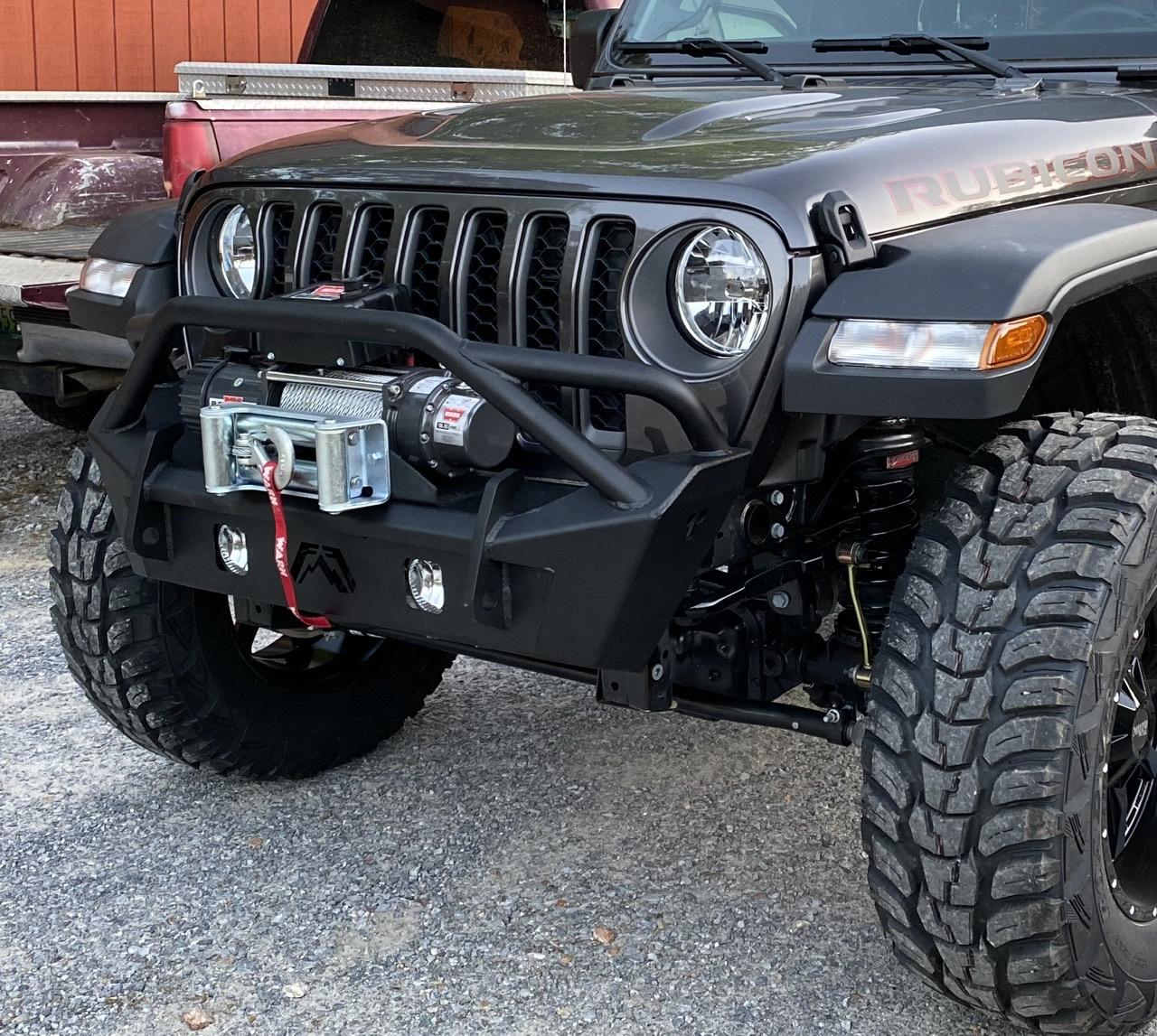

My Fab Fours Stubby is made for 2018-2020 JL/JT...

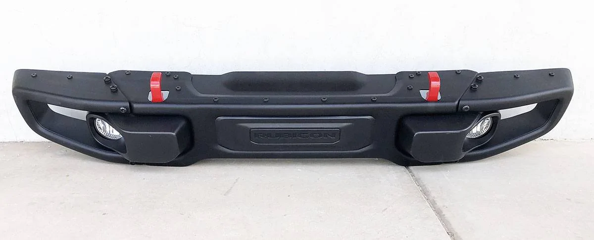

I still have the steel front bumper in mint condition from my 2017 Recon, in Vegas for $400 but the only interest in it has come from too far away for reasonable shipping costs.
Too bad I'm in Kansas.
