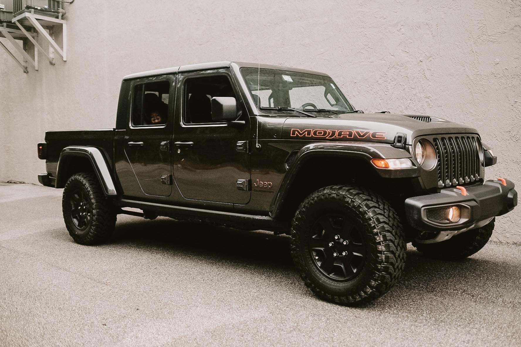

First post here, thanks for having me!

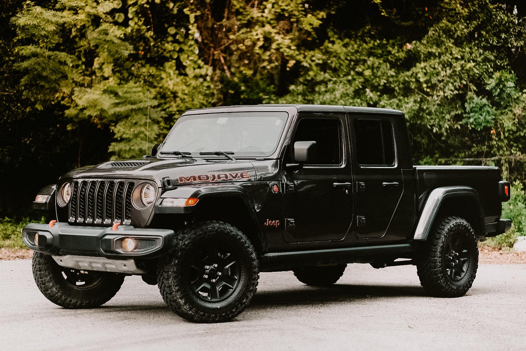

my family just switched from a 4Runner to the new Mojave and after 2 weeks are loving it!
came with the hard top and 8.4” screen and mud terrains, and so faR i couldn’t be happier.
my two big questions are:
does the mojave skid plate effect which after market bumpers i can use? It doesn’t look like it attaches to the anything I’d replace with the new bumper but i thought I’d see if anyone has had figment issues, but I’d like to get my winch on ASAP
my other question that keeps popping up is in regards to lift. I don’t want to mess with the ride quality or designof this incredible suspension but i may want an extra inch or two of clearance. Are spacers the way to go?
thanks for having me! Really exited to see where this takes us!

Welcome and good looking Mojave you have there!
The accessories aftermarket (bumpers included) is a bit of a new frontier for Mojave owners at the moment. A couple members have installed OEM steel Rubi bumpers but the Mojave skid is not a perfect match and I’m not sure if the Rubi skid will work. 4wd.com differentiates Mojave trim and excludes many of the aftermarket bumpers available stating “this will not fit your vehicle”. Clearly there is a fitment issue with either the factory skid, lack of skid or placement of shock bypass reservoir. There certainly are options available that are winch capable though, I just haven’t found the perfect solution for me yet. New Mojave specific products will become available in time but supply lines have been so choked that even getting existing products to customers has been a beating. We also seemingly learn new things about the Mojave everyday, yesterday we learned the cowls and hood height make existing accessories unusable.
In regards to lift options you are dead on! Several companies including AEV make spacers lifts that will retain all the things you love about the Mojave suspension while providing a bit more height and clearance. At least one member has installed the Daystar kit and several others have fitted 35’s and now 37’s without any additional lift.
Welcome aboard and have fun with your new Mojave!

Thank you for all of the detail and for taking the time!
which accessories aren’t working under the hood? I’m definitely considering a snorkel, but not much else Under the hood.
I’m leaning towards the FabFours stubby bumper but if it means losing my skid plate i think It would be a deal breaker, but i end up wheeling alone more often than I’d like and really want the winch on, and this creates quite a pickle. I can’t figure out where the problem is just by looking but it seems that the skid plate mount is Independent of the bumper mount but I’ve never done this install so i could definitely be wrong.
Oh, last question, in regards to height, considering the Mojave is already 1” higher than the rubicon, (in the front only i believe) Do people consider it already lifted? Like would 35”s tuck ok? I imagine it’s probably 4-6 inches taller than a factory sport, and people are running 35 on those. So far I’m happy with clearance but i do plan on making the trip to Moab this year and want to be prepared.

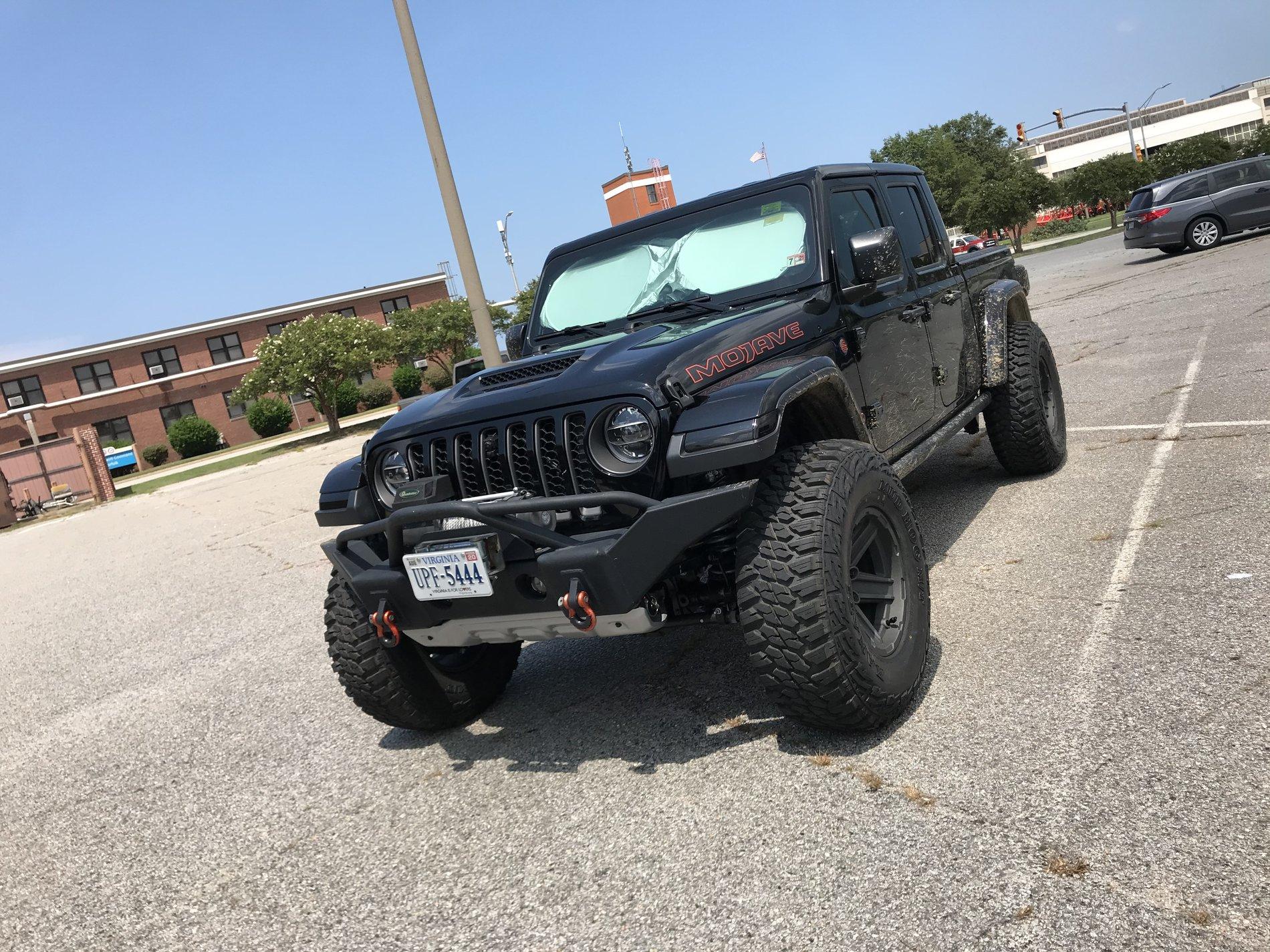

You’ll be fine! I used the after market bumper off of my JKUR and it does not interfere with the skid plate. Hope this helps!
Jeep Gladiator 2020 Gladiator Mojave I just picked up, as well as a question about bumpers 55953DF5-BEB0-49A2-8A0D-21F720D8C576
That’s gorgeous!
Did you have to consider the wheel offset to keep the width right for the suspension?
did the Jk bumper mount right up or require modifications?

That’s gorgeous!

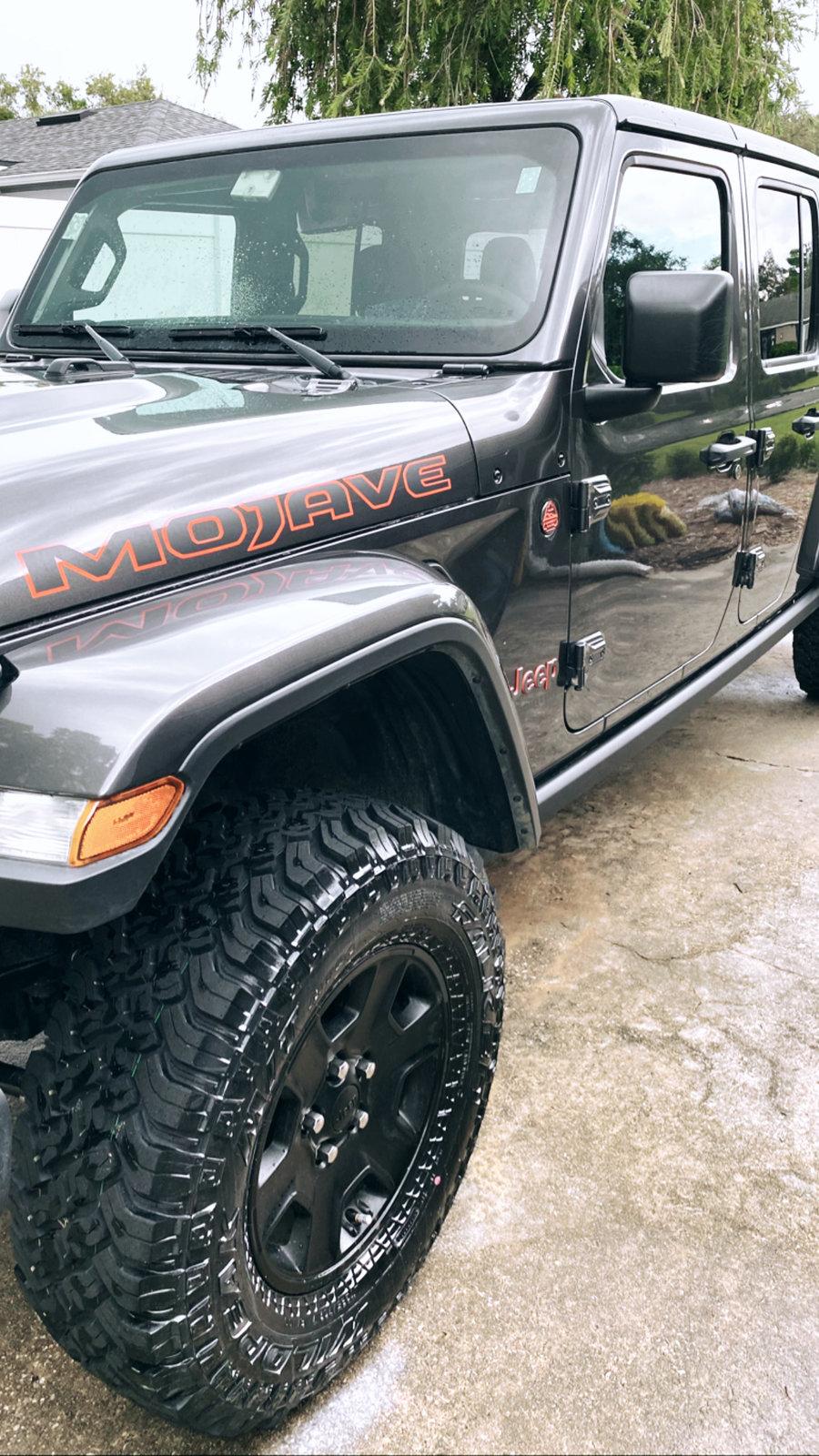

thank you! And not at all! Could’ve went with a wheel closer to the stock back spacing and I still would clear. And yes the bumper mounted up without any mods.
Edit: I forgot to add I installed a teraflex 1.5” front leveling kit and daystar .75” leveling kit. But I’m sure The tires will would’ve cleared the bumper
Great to know... any fitment issues with the leveling kits?
also i want to add a sway bar disconnect but don’t know ifthe factory lift means it won’t fit. I think the teraflex is adjustable but i wasn’t sure whichoption to go with because of the Mojave’s unique height

No fitment issues at all with the kit, I been looking in sway bar disconnects also. I’m in the same boat as you as to which kit to go with. But as of now, I’m interested in the JKS endlinks
