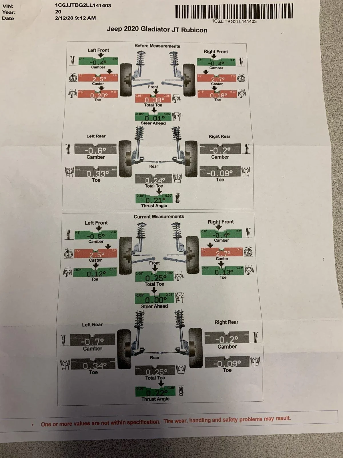

these are my specs from alignment shop

Your front caster appears way off. Rock Krawler recommends 5.0-5.5 degrees with a 5" kit. Caster being that far off alone will give you horrible handling. The steering will wander and there will be a lot of bump steer. That could also set you up for death wobble. As others have said you need a full set of upper and lower control arms. Adjustable tracbars would be good as well but with 6" of lift you will need tracbar brackets. That doesn't address the draglink as that may need to be flipped on the knuckle to keep it in phase with the tracbar. It looks like the kit has drop brackets for the front control arms but none for the rear. Not sure what they are using to correct the rear pinion angle and the rear axle will be moved forward in the wheel well also.
Not trying to flame you but it never ceases to amaze me how many people buy an inexpensive kit and expect it to ride and handle as well as stock. Those who know are not spending 2-3x the cost of that kit and more because we want to. We do it because we know what the vehicle will need to function properly lifted and want a complete kit engineered to provided it. Ultimately, if you buy a complete set of adjustable control arms and heavy duty trackbars, you will of spent as much as most of spent for an entire kit....and you will still have Rough Country shocks.
