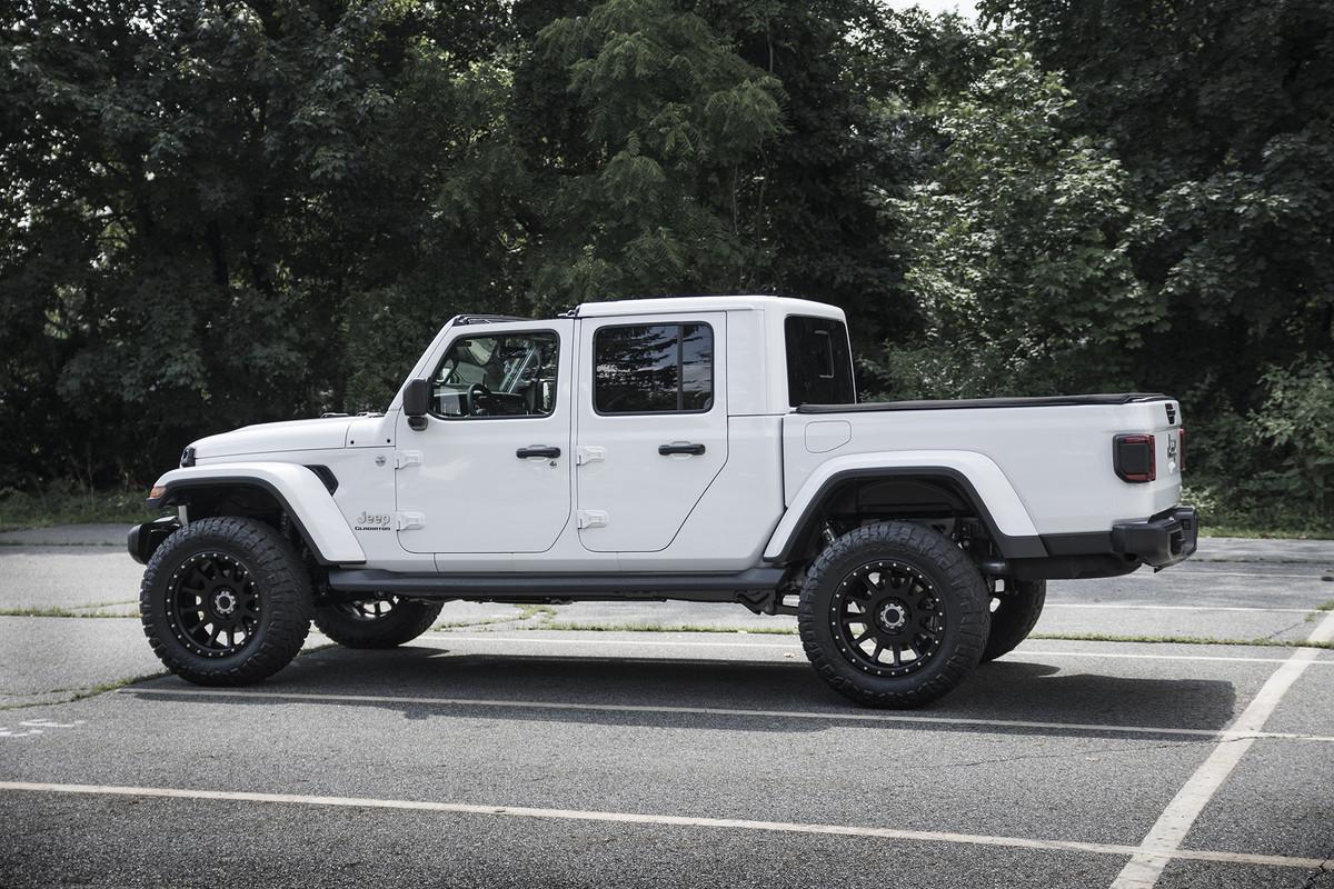

There is a lot of contradictory advice out there for my Overland, and I'm trying get a definitive answer. Any help appreciated!
I don't believe my Overland has the tow package although it has a wired trailer plug. I've read that my truck's towing capacity varies anywhere from 4000lbs to 6000lbs depending on options. I need to know an exact number though.
Can anyone confirm by the pics below that I do/do not have the towing package, as well as what weight I would be able to comfortable tow if I installed a hitch?
I am looking to tow around 4700lbs over a 700 mile journey so I want to make sure I don't run into trouble. Thanks.

You do NOT have a towing package. You simply have the Class II hitch and wiring, which is standard equipment on all Gladiators.
You can drill out a hole in the plastic bumper cover and mount a ball directly to the hitch you've got now. The plate under that area of the bumper gives reinforcement.
If you want to use a receiver style hitch instead, you'll need to unbolt the Class II in order to bolt up the new Class IV.
According to the owners manual version 2, you are currently capped at 3,500 lbs. towing maximum due to the hitch your truck came with. If you replace the hitch with a Class IV, you can then tow 4,500 lbs. with your truck.

That's correct. WITH the towing package added to the Overland, it can tow 6,000 lbs.
However, without the towing package it's capped at 3,500 lbs. due to the rating of the hitch. After upgrading the hitch to Class IV, the truck then becomes capped by the drivetrain rating, not the hitch rating, which then takes it to 4,500 lbs. towing capacity.
In the case of the OP's truck, as it sits right now, the hitch is the limiting factor. 3,500 lbs. maximum.
