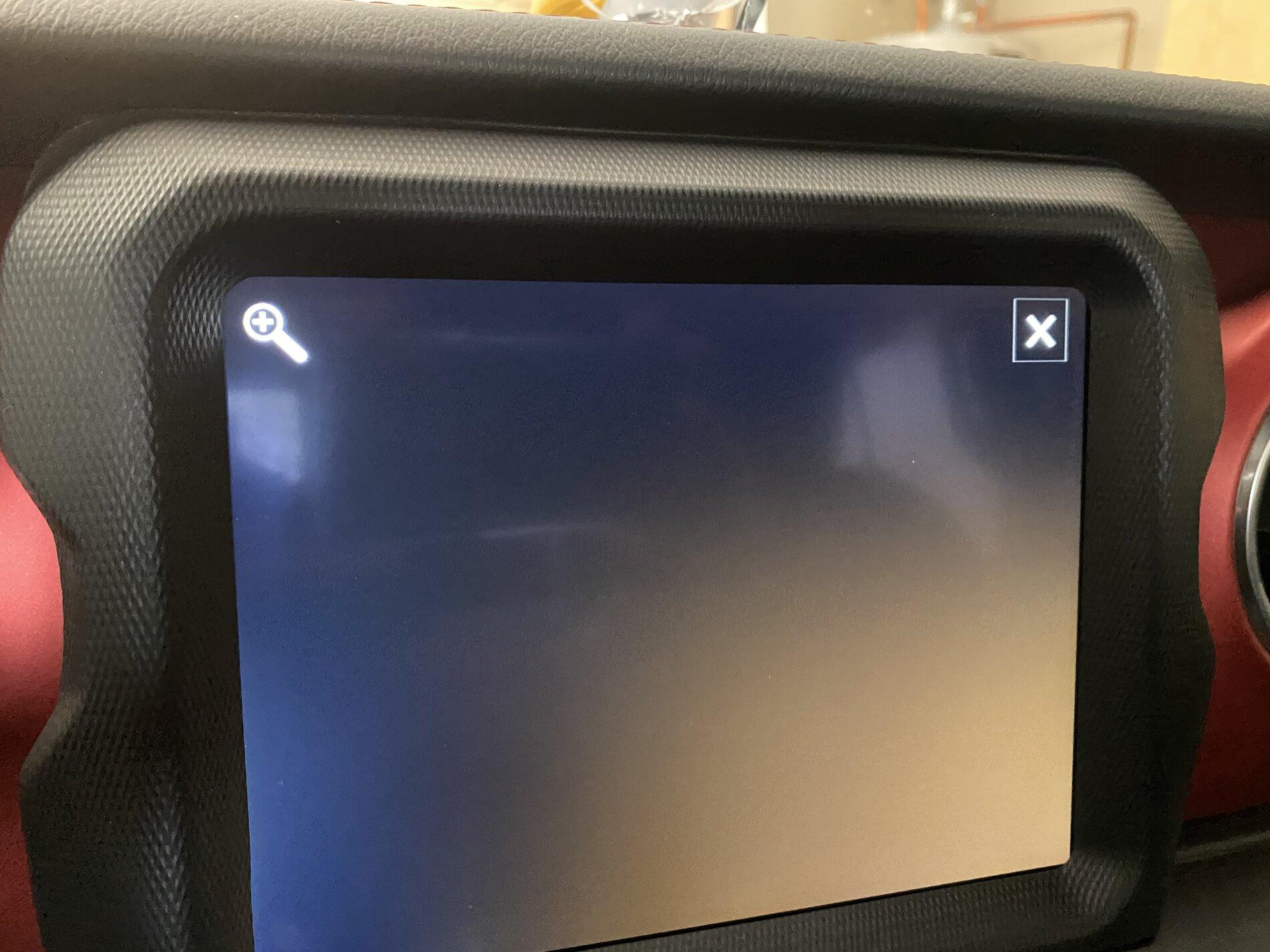

Went out for some errands today and all was well until I hopped back in to go home and back up camera screen was blacked out when put in reverse.
Any thoughts on this? It’s not the blue screen of death, but just blacked out as in pic.
Also, which fuse is the camera on? Fuse detail really doesn’t say that I can find.

Turn off the engine. Park. Come back in 20mins.

Did that. Had to make another trip. Roughly 30 minutes after I returned first time.
Just returned again ....Will let it sit overnight and what the morning brings.
It must not like 100 degree temps. :)

Mine did that last week. I turned it off and on (all variations). Then I opened and closed the tailgate, but didn't test. Came back on. So I'm not sure if it's sitting and resetting, or a position of the tailgate. Or maybe a loose wire that needed to be jogged.

Update, pulled Fuse 97 and waited 10 seconds. Uconnect rebooted and problem is resolved. Quick fix but if this continues it's going to the dealership.

I've had this happen a couple of times.
First time I unmarried and removed my Tazer to the stock configuration, pulled fuse 97 for a few moments, ran some errands where I had some drive/park cycles, didn't start working again until the next day. I was getting ready to take the JT in for service, so when it started working again I knew Jeep service department couldn't fix or find what's not broke.
Second time I did nothing and it started working again the next day.

The latest uConnect update fixes this faster—a shorter time between off and on.

I searched YouTube and there is a video on how to reset the Uconnect system. If I remember correctly, with ignition on but engine not running, hold the big knobs on either side in for like 20 seconds then release.
for exact directions, google it. I’ll try to search again if I get a moment.

I had that happen once. After I removed the rear bumper to add the passenger side hook. Guess I disturb the wires that come down from the tailgate. I removed the access panel on tailgate and disconnected the wire and then reconnected it. That was over a month ago and it hasn't happened again. The connector could have been loosened from closing the tail gate also.

My backup cam went out yesterday. I cycled power several times, including after a 45 or so minute interval, and no joy. Today, I went outside and it came back on, so can confirm that, in at least some cases, it takes quite a bit of time for the thing to start working again.
Without being a total drama queen, I will simply state that, if this is caused by some sort of over-air ongoing update, killing safety equipment for the duration of the update is a completely unacceptable process flaw. Quite shocking, actually, from the standpoint of a company getting sued if heaven forbid some dope forgets how to back out with mirrors and smashes a pedestrian.
If there were some sort of warning, or perhaps message from the UConnect stating, "hey, hit this button when you're done for the day, we got some updating to do and things might get wonk for a few hours" at least drivers could be prepared for crippled feature functionality. It's reasonable to wonder, "if they shut off this equipment that I can see, what else isn't going to work properly for the next 12-24 hours, and will I be unlucky enough to find out?"
