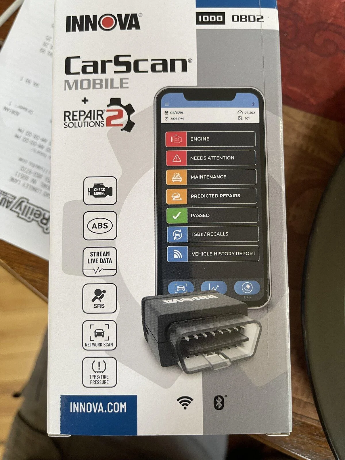

Well, quick update (tip), the Innova OBD2 1000 will not work with the Jeep. I could get it to do a live monitor of a few of the systems, but it would not do a scan. I contacted Innova tech support. They said none of their products will work with anything newer than 2018 (I'm assuming this was specific to the Jeep), but they may have compatibility by the end of the year. Sucks as this is only a $100 investment. I think I've found some Mopar compatible devices, but I need to do some additional checking.

you may want to try the OBD Jscan on the google play store and see if that blue tooth obdII adapter you got pairs with it.

I went back to the O'Reillys and returned the dongle. We tried their store handheld diagnostic Innova 5512, and it would read the system. That model comes with some cables I did not need so I purchased the 5410 https://www.oreillyauto.com/detail/c/innova/innova-obd-code-reader/inn0/5410?pos=9&manufacturer=true Checked it out in the parking lot, and it connected with the system just fine. It showed the stored error message from the first issue I had so that is promising. For now this looks like it will be what I need, and maybe as the year progresses they will have updates that allow it to see more of the system.
