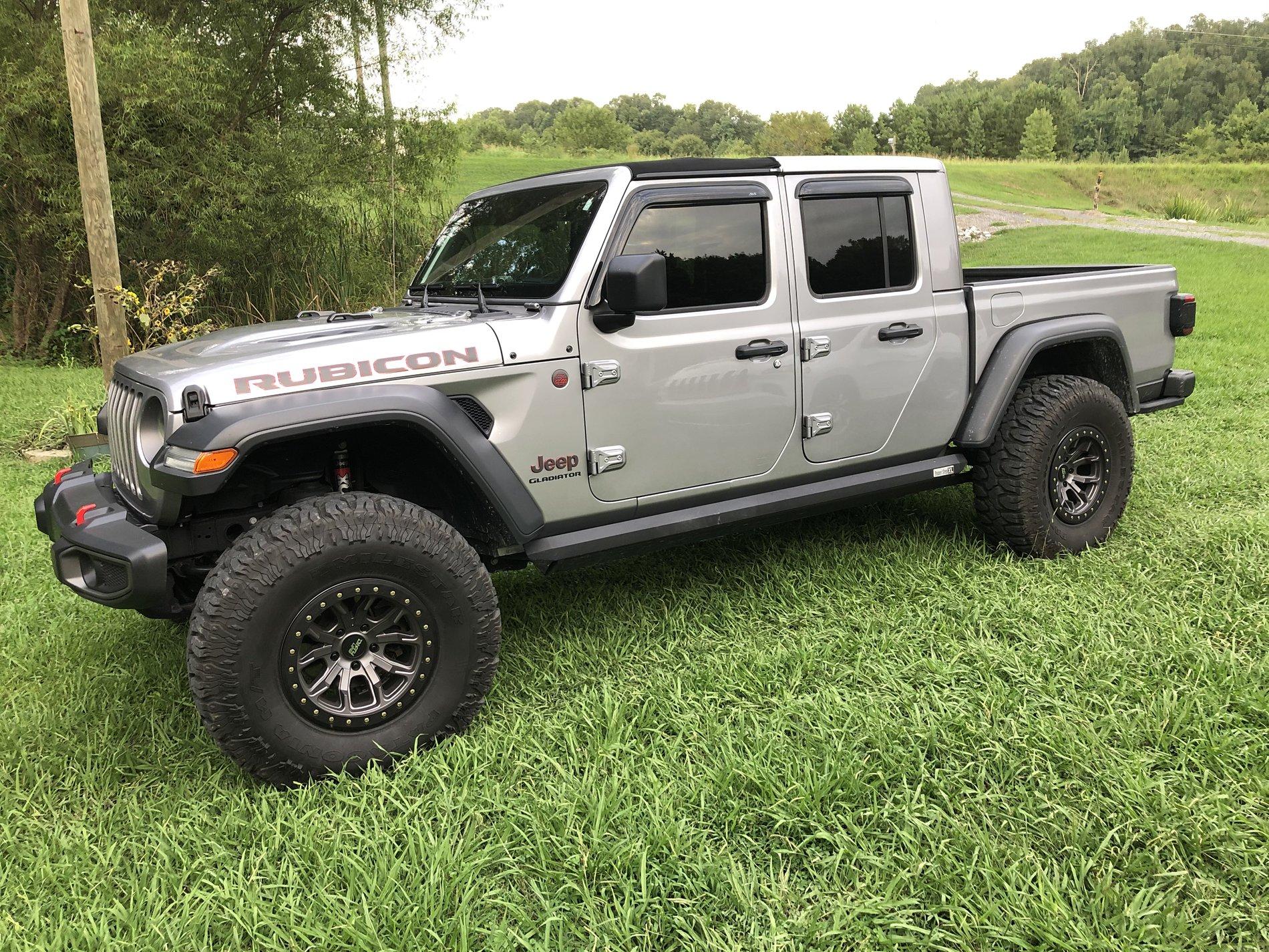

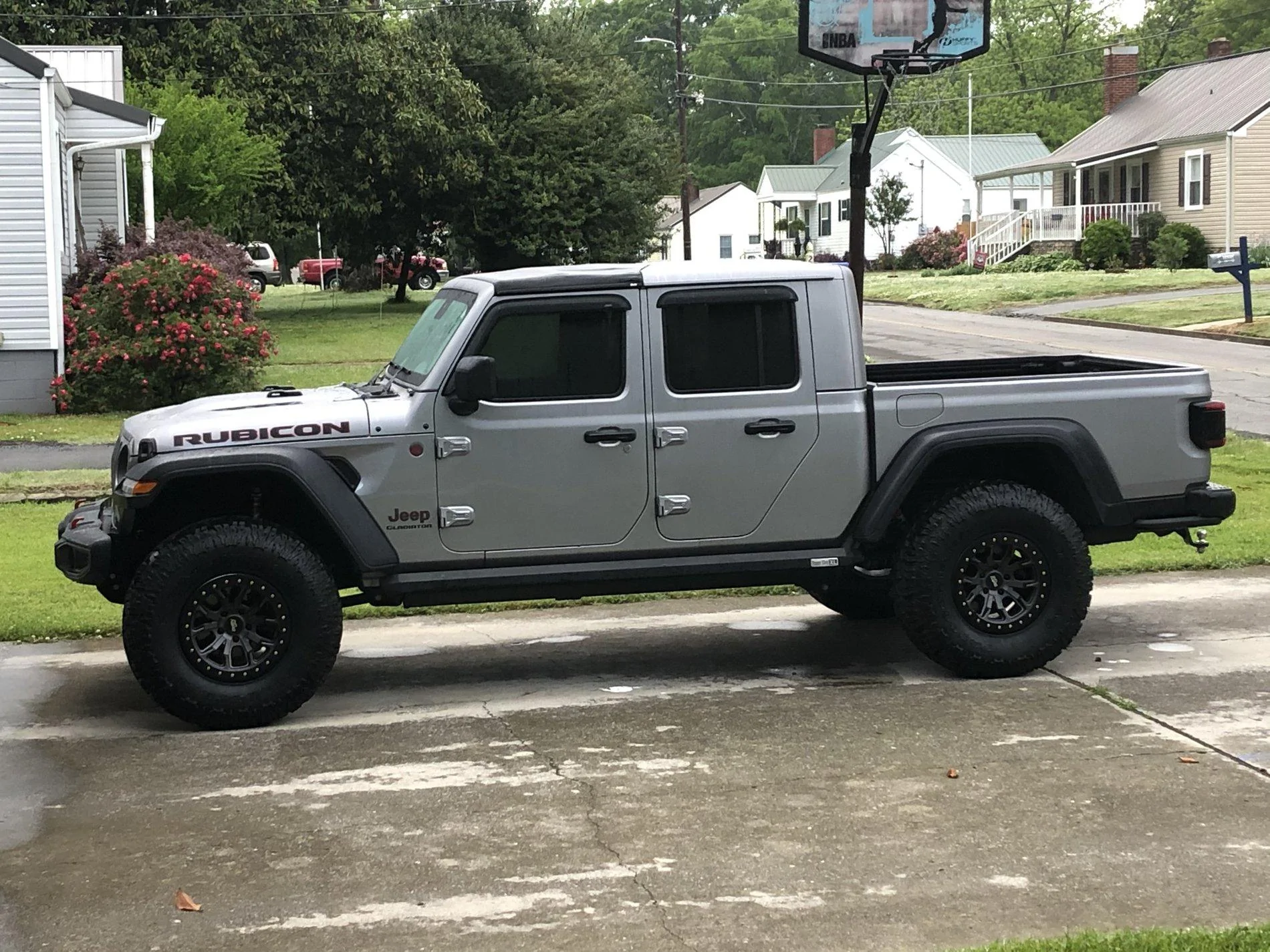

The 2.5 inch leveling kit from rough country comes with shock extensions and the ride is great I don’t do any off-roading these gladiators cost to much to tare up

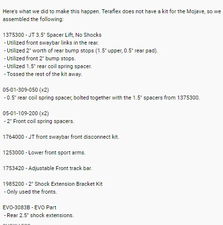

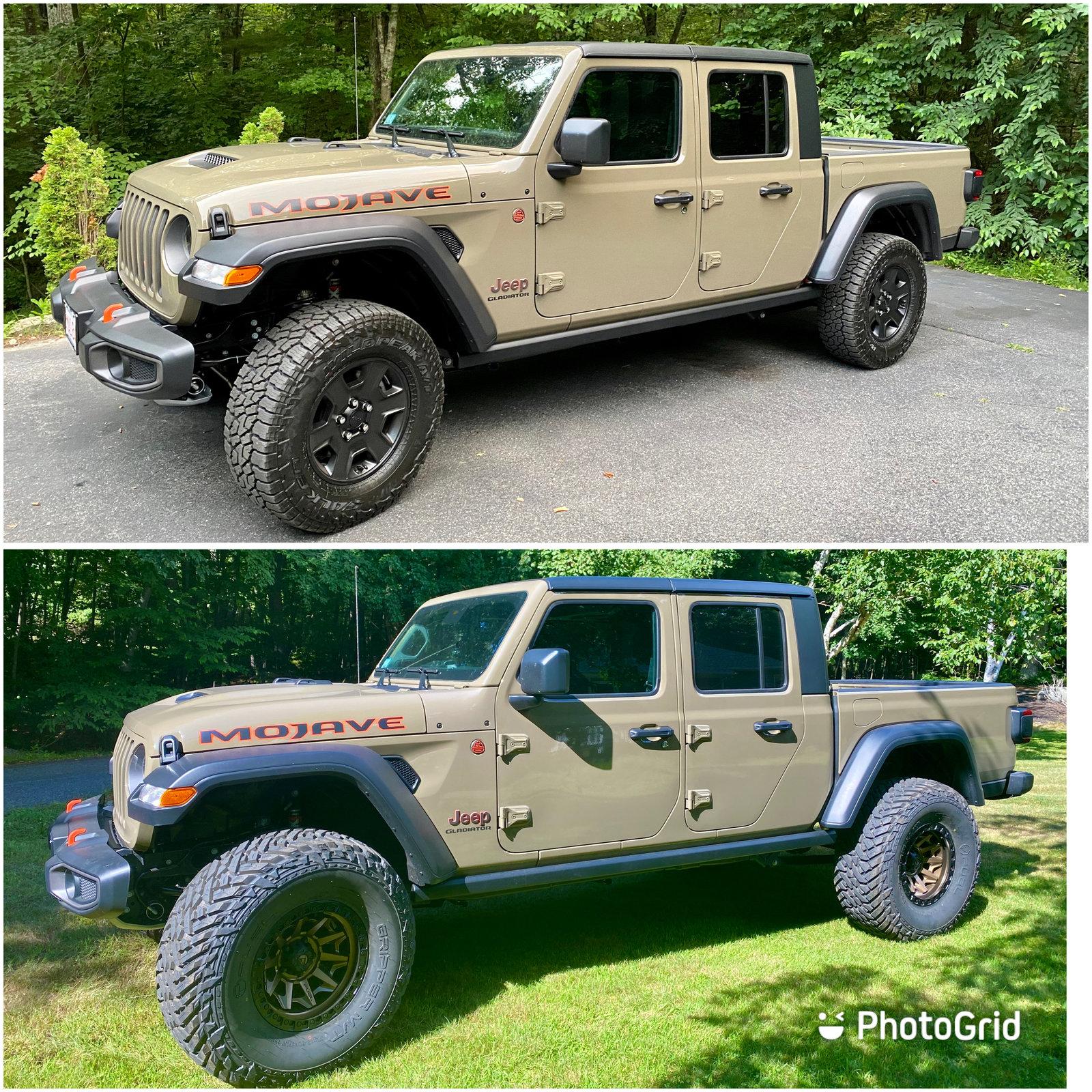

We went with 35s on our Mojave build. Spacer lift using parts from Teraflex and EVO. Drives awesome. Check out our build video:
Very interested in this...could you kindly provide a parts list?

Likely the reason for this is the lift put the shocks out of the proper rest position for the internal bypass, that's why we lifted our 2" with 2" bumpstops, 2" shock extensions and a trackball and lower arms. Drove like a dream.

Jeep Gladiator 2021 Gladiator Mojave Spacer Lift for 37s? 1604120399664
very impressed, thanks to Christian & Paul for the parts list and video.
This really seems to be the way to go for Mojave lift,
looks like the parts total comes out to around $1K.
You Bet! Maintaining the ride quality as FCA designed with our assembled parts list is the way to go for some added ground clearance and larger tires.
Cheers! ~ Paul.
