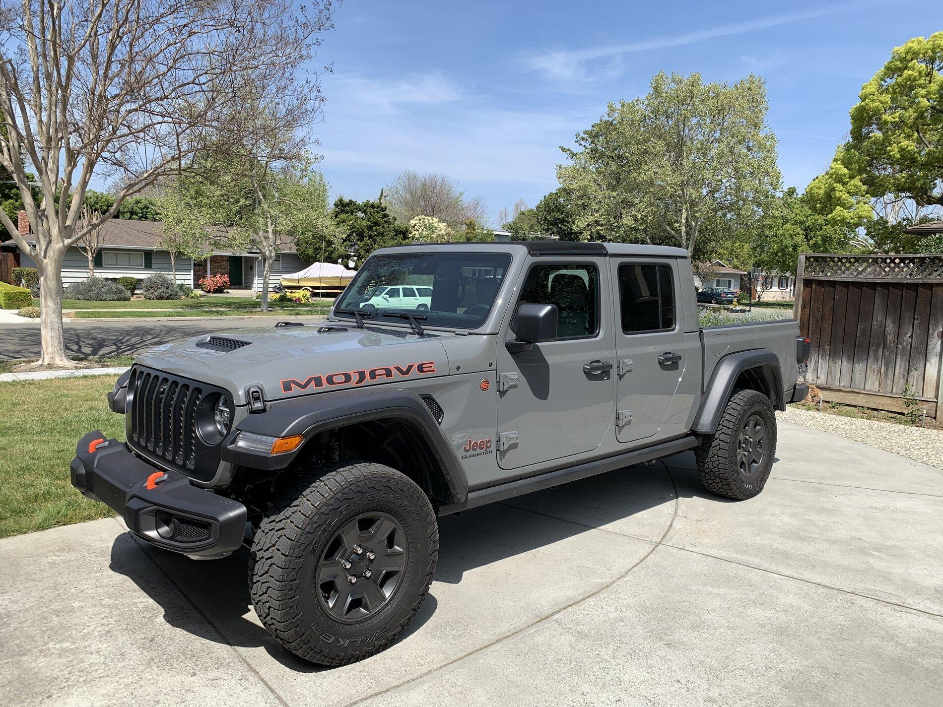

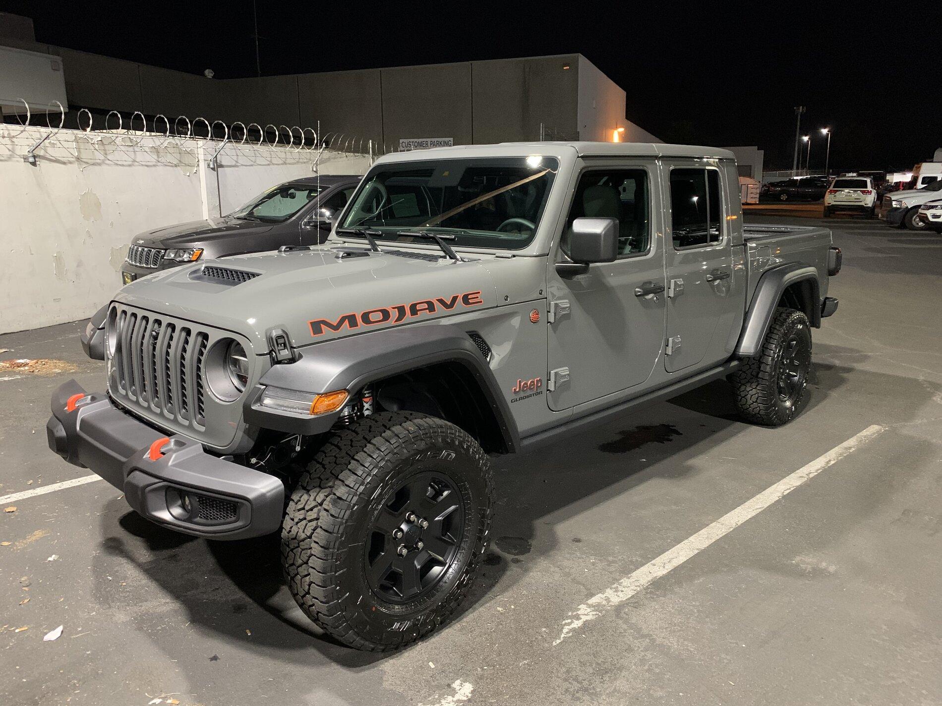

I've been following the forum for a while now and figured I'd start my build thread.
We just got our 2021 Mojave in December and have been planning out our overlanding build. The goal is to build an overlanding rig that is off-road capable and can sustain us off the grid for a few days. Every modification will need to be evaluated in the context of reliability, weight/payload, and handling.
Relevant factory options
  • 8-Speed Automatic
  • Selec-Trac Full Time 4WD
  • 4.10 Axle Ratio
  • Trailer Tow Package
  • Hard Top
  • Trail Rail System
  • Truck Bed AC Outlet
  • TrailCam
  • Auxiliary Switches
Completed mods
  • RLD Canopy
    • String Gray body
    • String Gray windowed back door
    • Black solid side doors
  • Camp King RTT
  • Mopar Trailer Brake Controller
  • Mopar Satin Black Grille
  • Mopar All Weather Floor Mats

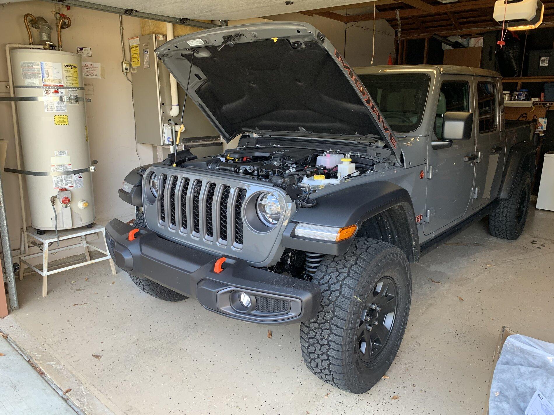

In progress suspension mods
  • AEV 2" Spacer Lift
  • AEV Geometry Correction Brackets
  • Clayton 2.5" Springs front and rear
    • Single rate front, 188 lb/in
    • Triple rate rear, 280 lbs/in
  • Method 703 Bead Grip Wheels
    • 17x8.5
    • 25mm offset/5.78" backspace
  • 37" BFG T/A KO2
    • Load Range C
In progress axle mods
  • Dana 4.88 gears
  • OX Lockers front and rear
  • Yukon chromoly rear axle shafts
In progress body mods
  • Curt front receiver hitch
  • Warn Zeon 10-S Winch
    • Receiver hitch mounted
    • Front and rear Anderson connectors
  • Coverking Hardtop Headliner
Possible transplants from other trims
  • Front ParkSense - EU
  • Sway bar disconnect - Rubicon

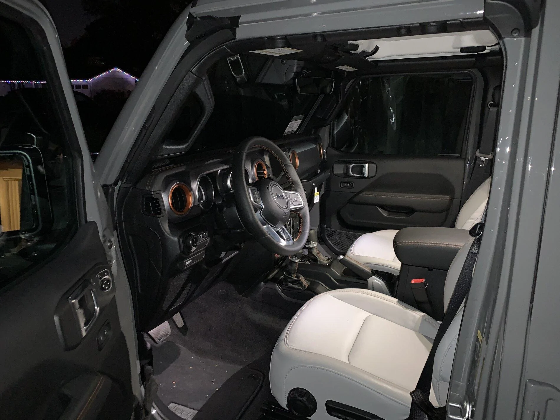

Just off the truck in December. Sting Gray exterior, Steel Gray interior.
Jeep Gladiator 2021 Mojave Overlanding Build IMG_9944
Jeep Gladiator 2021 Mojave Overlanding Build IMG_9949

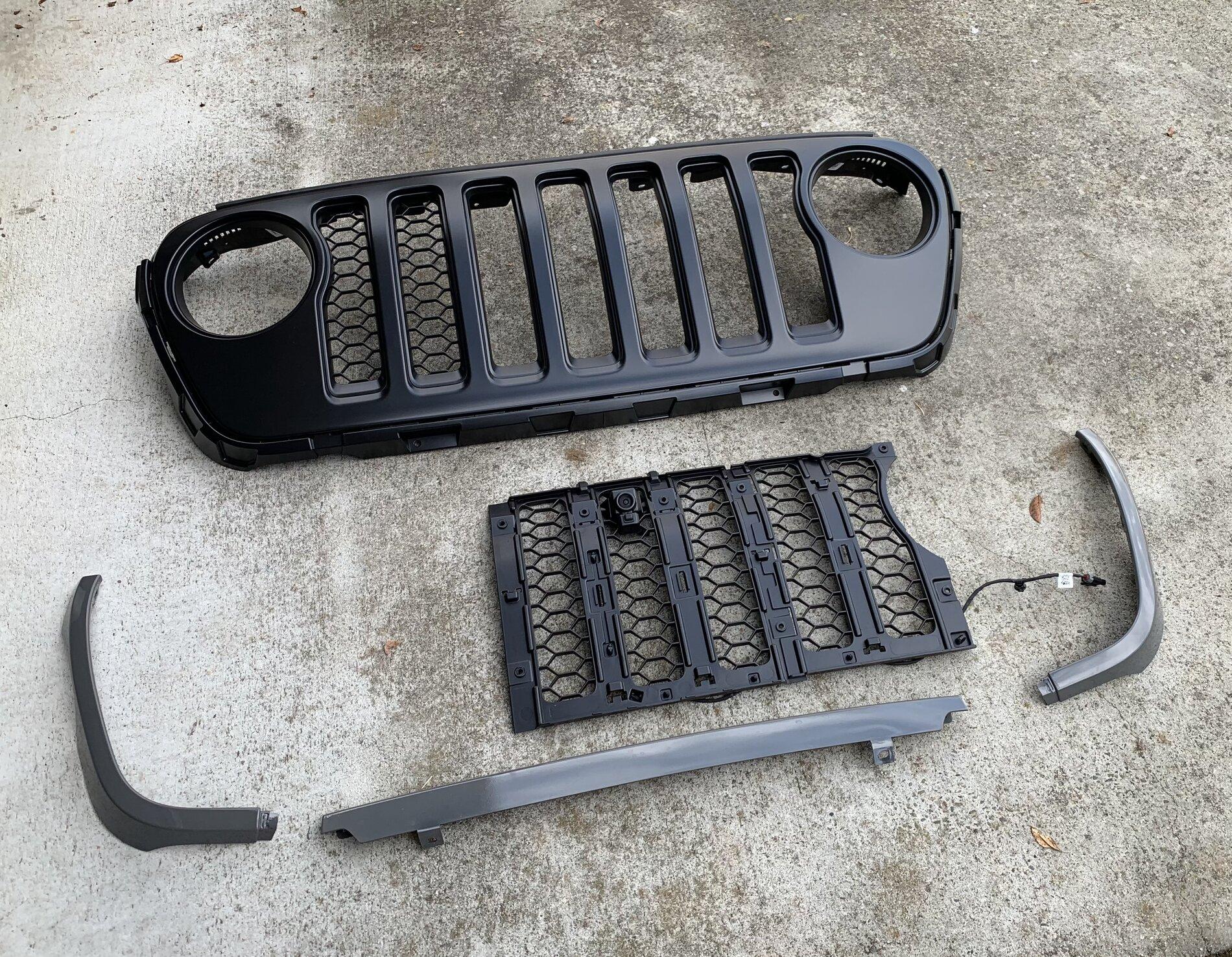

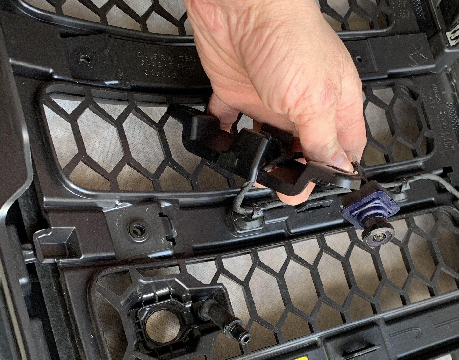

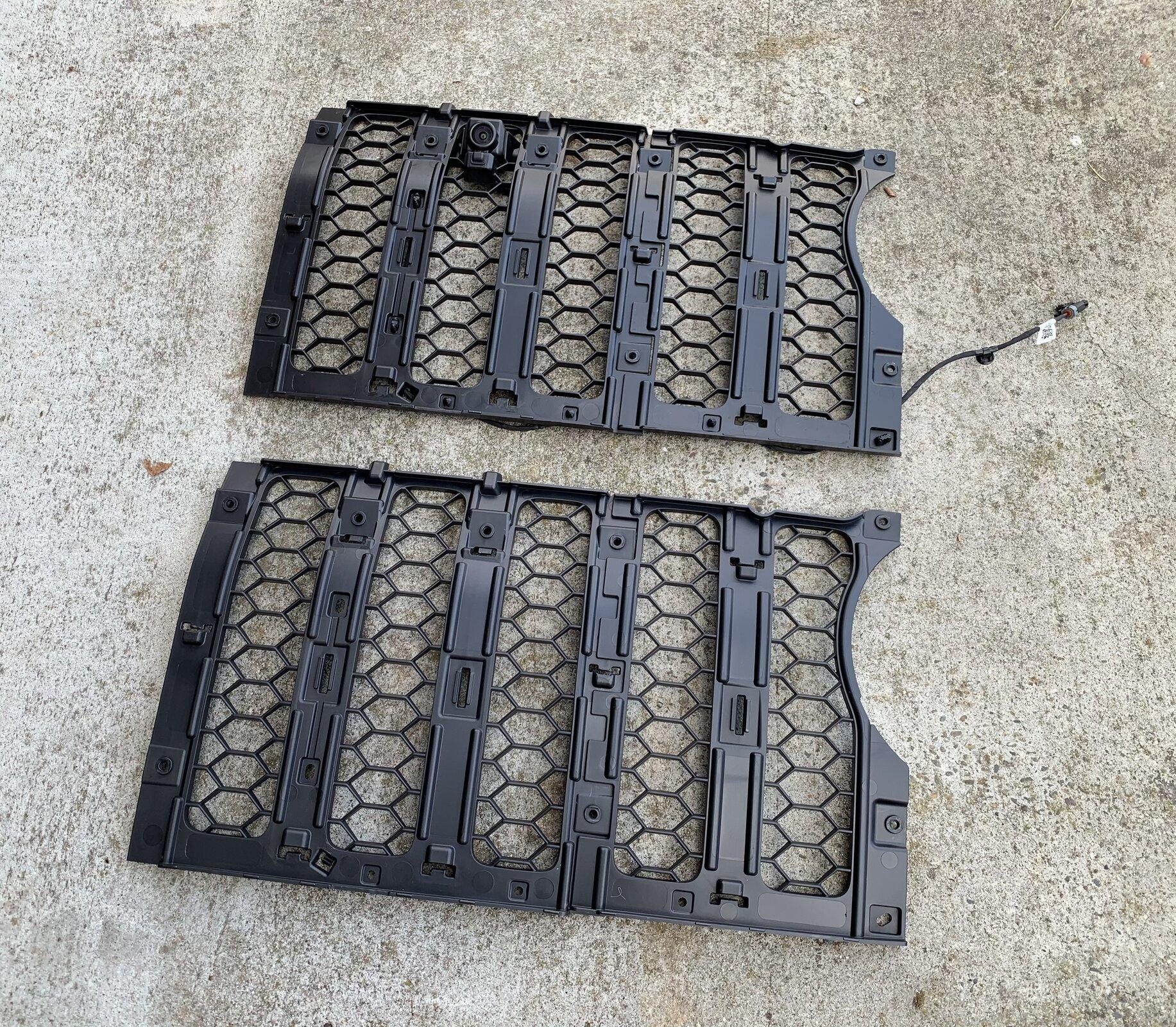

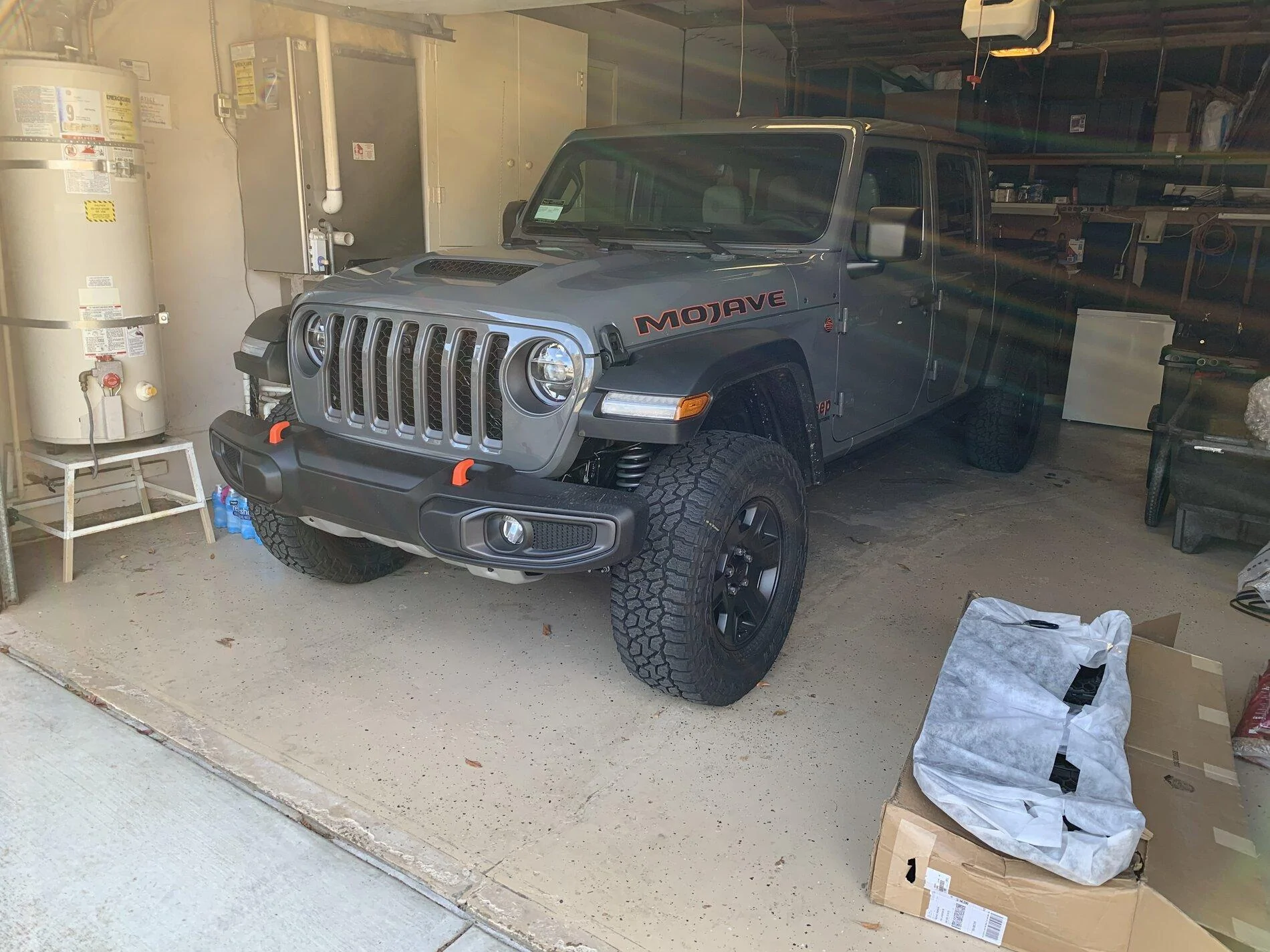

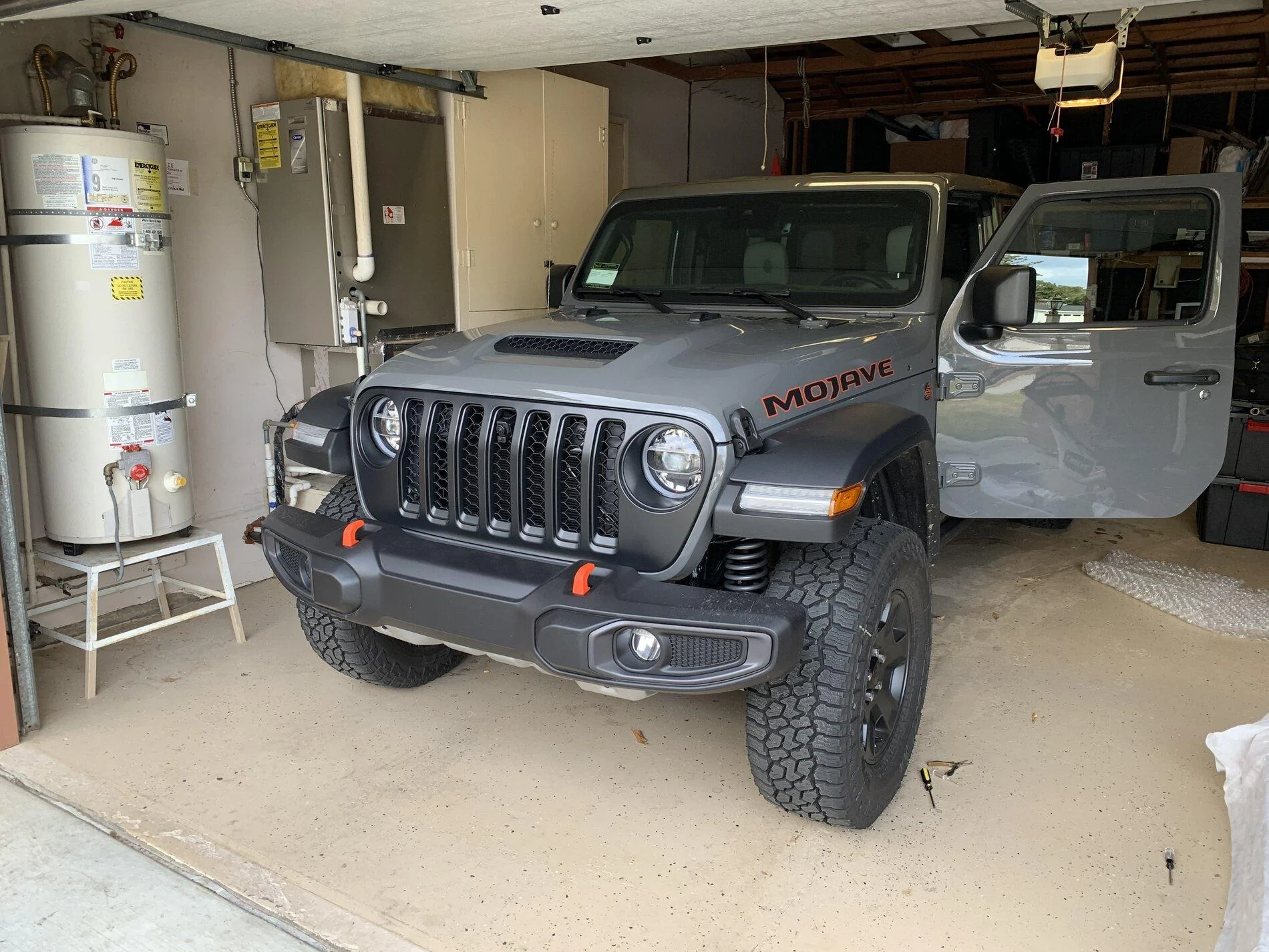

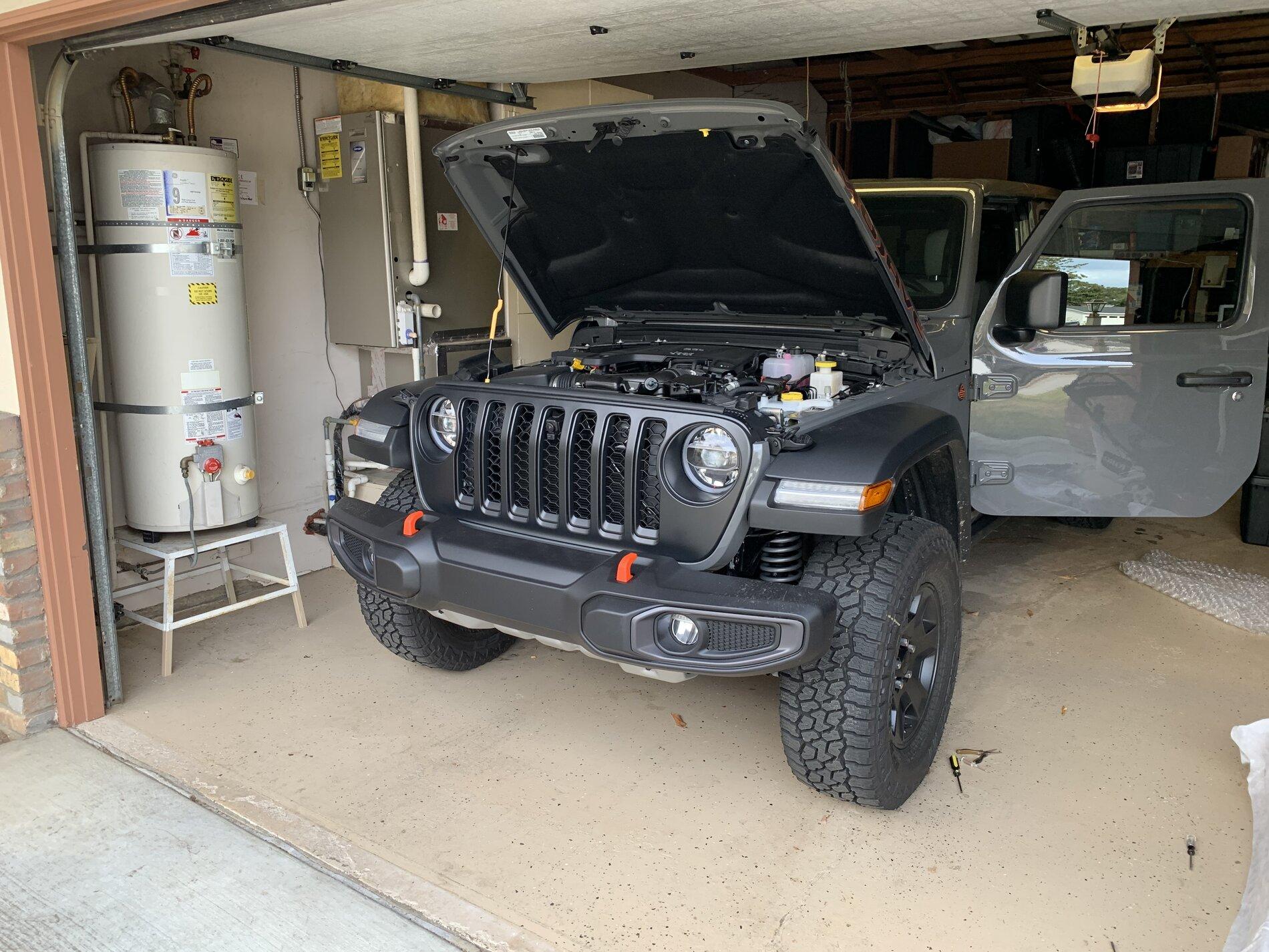

Our first mod was to swap the stock paint matched grille for the Mopar Satin Black Grille. We wanted the satin black from the factory but it can't be ordered with the TrailCam. Had to transfer the TrailCam from the old grille to the new grille.
Got the grille from @AllMoparParts.com
Jeep Gladiator 2021 Mojave Overlanding Build IMG_0252
Jeep Gladiator 2021 Mojave Overlanding Build IMG_0253
Jeep Gladiator 2021 Mojave Overlanding Build IMG_0332
Jeep Gladiator 2021 Mojave Overlanding Build IMG_0333
Swapping the original trim pieces and TrailCam mesh into the new satin black grille.
Jeep Gladiator 2021 Mojave Overlanding Build IMG_0281
Jeep Gladiator 2021 Mojave Overlanding Build IMG_0292
Jeep Gladiator 2021 Mojave Overlanding Build IMG_0304

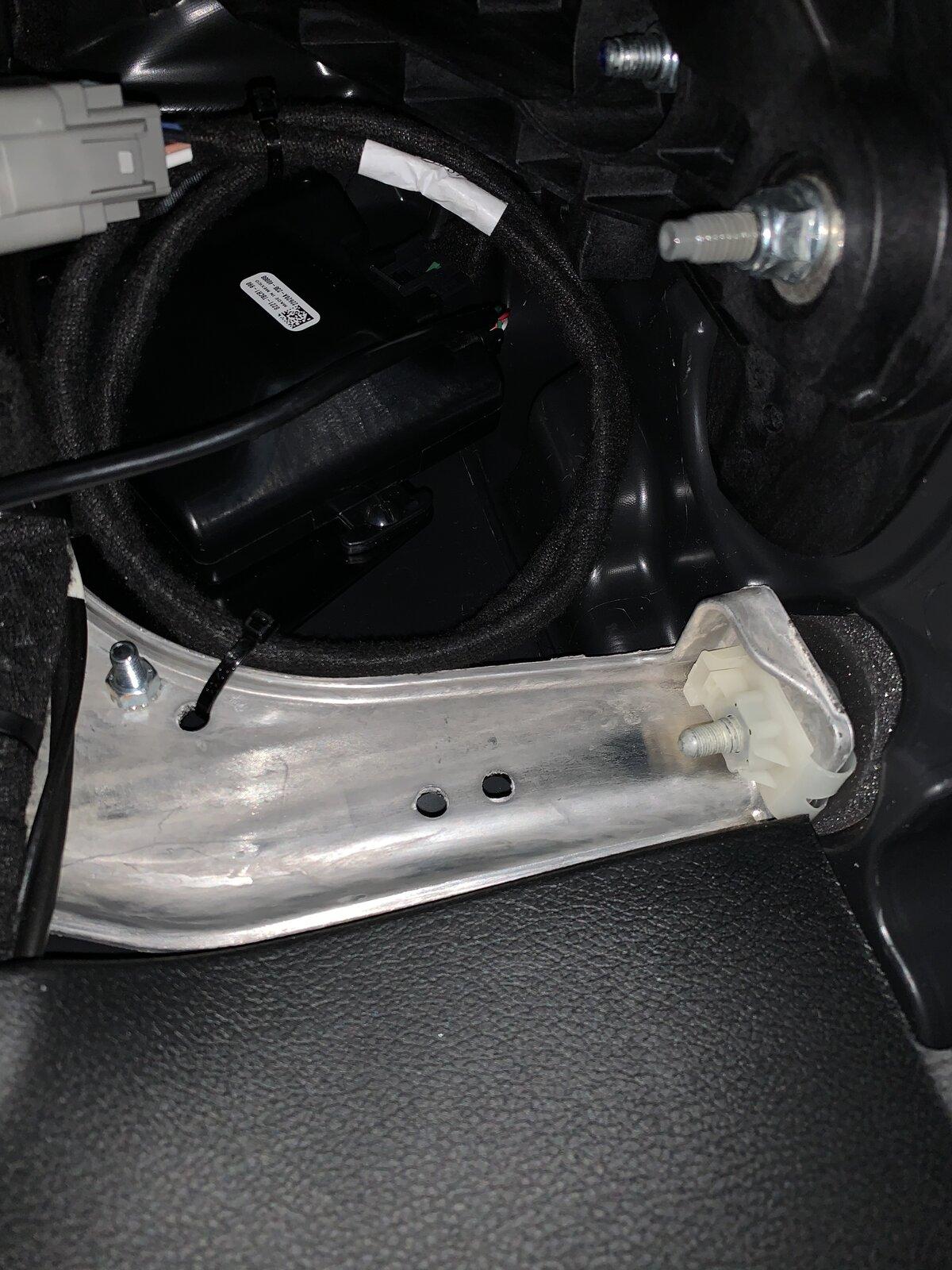

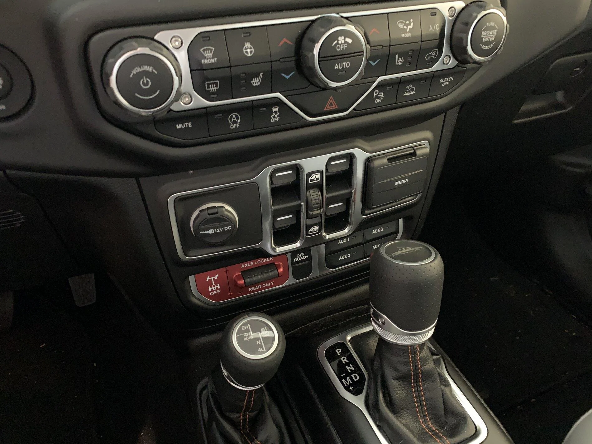

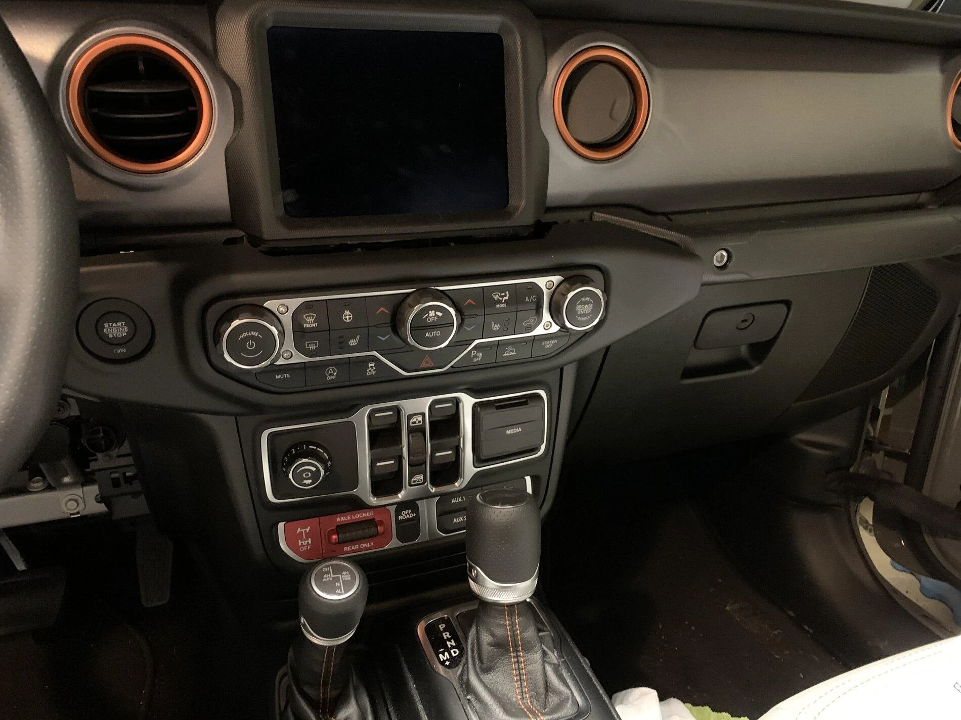

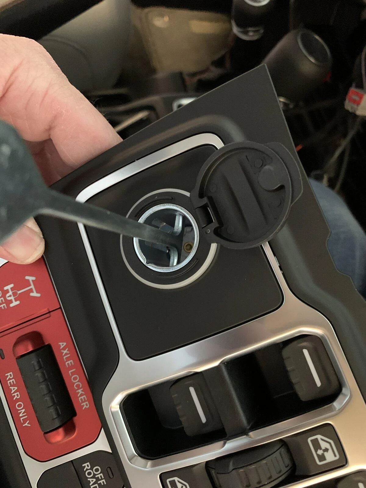

Next the Mopar Trailer Brake Controller. Getting the 12V outlet out of the dash panel and mounting the controller and wiring under the dash at the height of the master cylinder was interesting...
Got the brake controller from @AllMoparParts.com
Jeep Gladiator 2021 Mojave Overlanding Build IMG_0346
Jeep Gladiator 2021 Mojave Overlanding Build IMG_0424
The knob wiring is barely long enough while the brake wiring is excessively long. Also, not sure why they went with Deutsch looking connectors and Tesa tape for the brake wiring and barely automotive grade connectors and sheathing for the knob wiring.
Dorman 57450 Lighter Socket Removal Tool
Jeep Gladiator 2021 Mojave Overlanding Build IMG_0377
Jeep Gladiator 2021 Mojave Overlanding Build IMG_0423

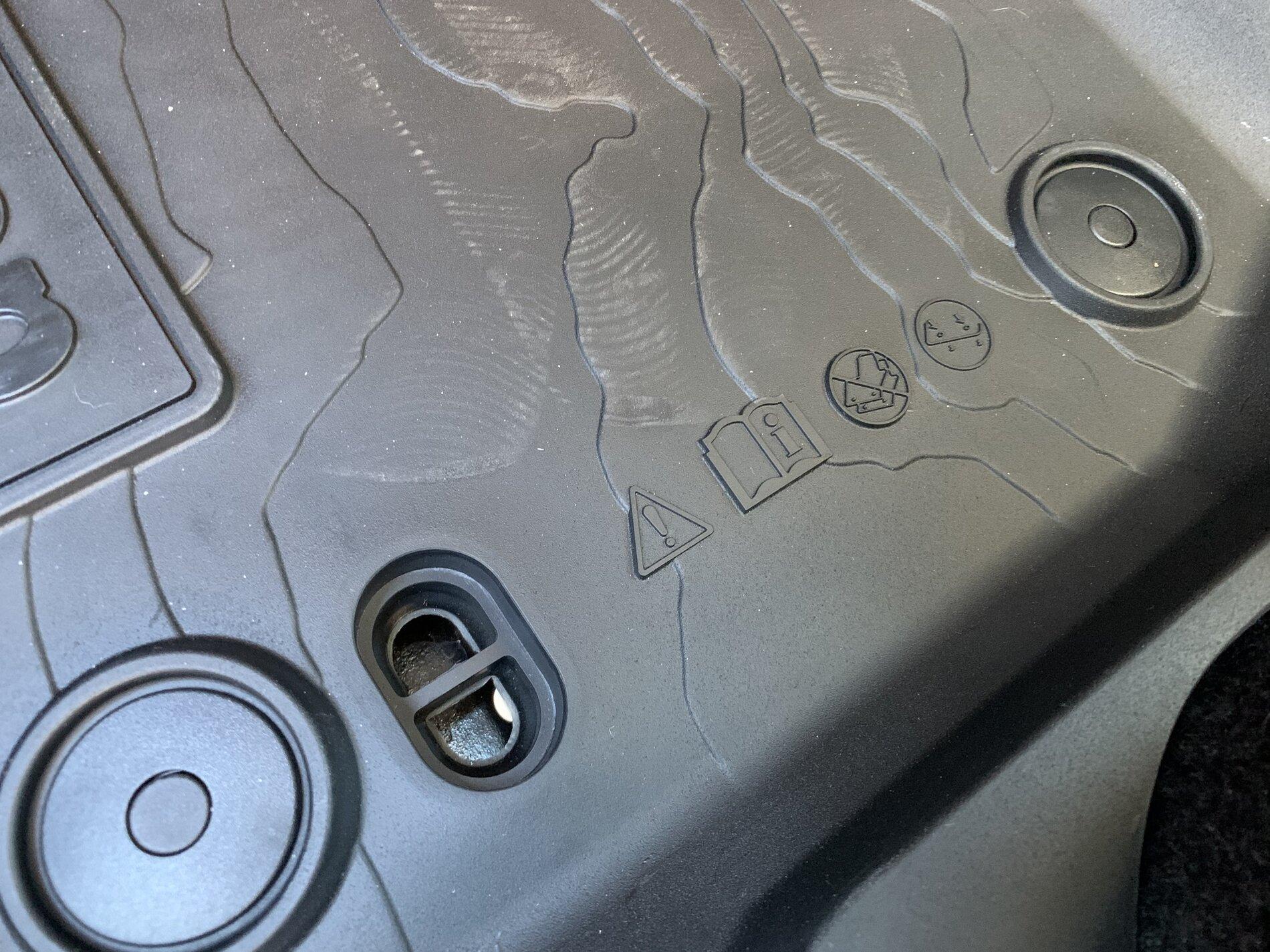

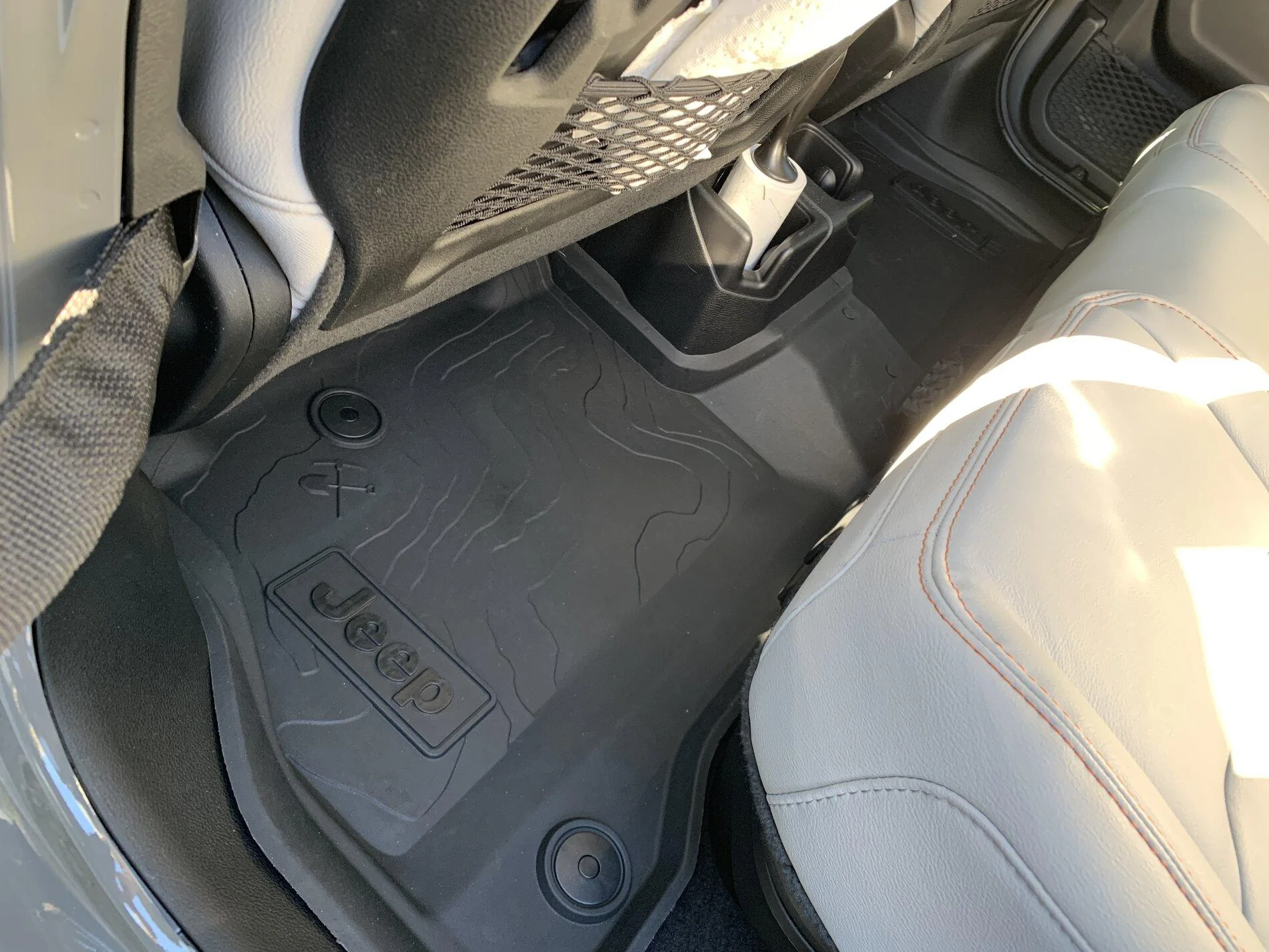

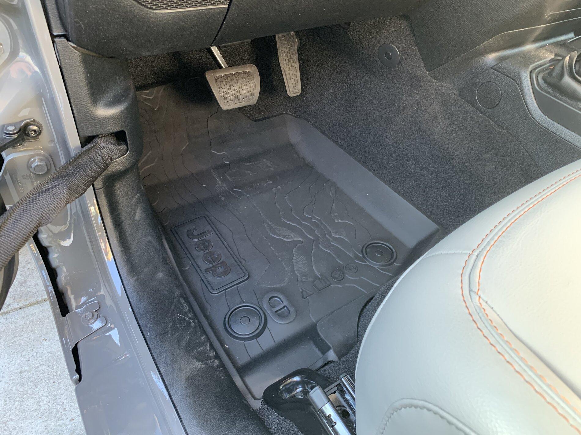

Installed the Mopar All Weather Floor Mats. Went with the black lettering instead of the red to not clash with the orange Mojave accents
Jeep Gladiator 2021 Mojave Overlanding Build IMG_0591
Jeep Gladiator 2021 Mojave Overlanding Build IMG_0593
The floor drain in the front mats is very cool.
Jeep Gladiator 2021 Mojave Overlanding Build IMG_0592
