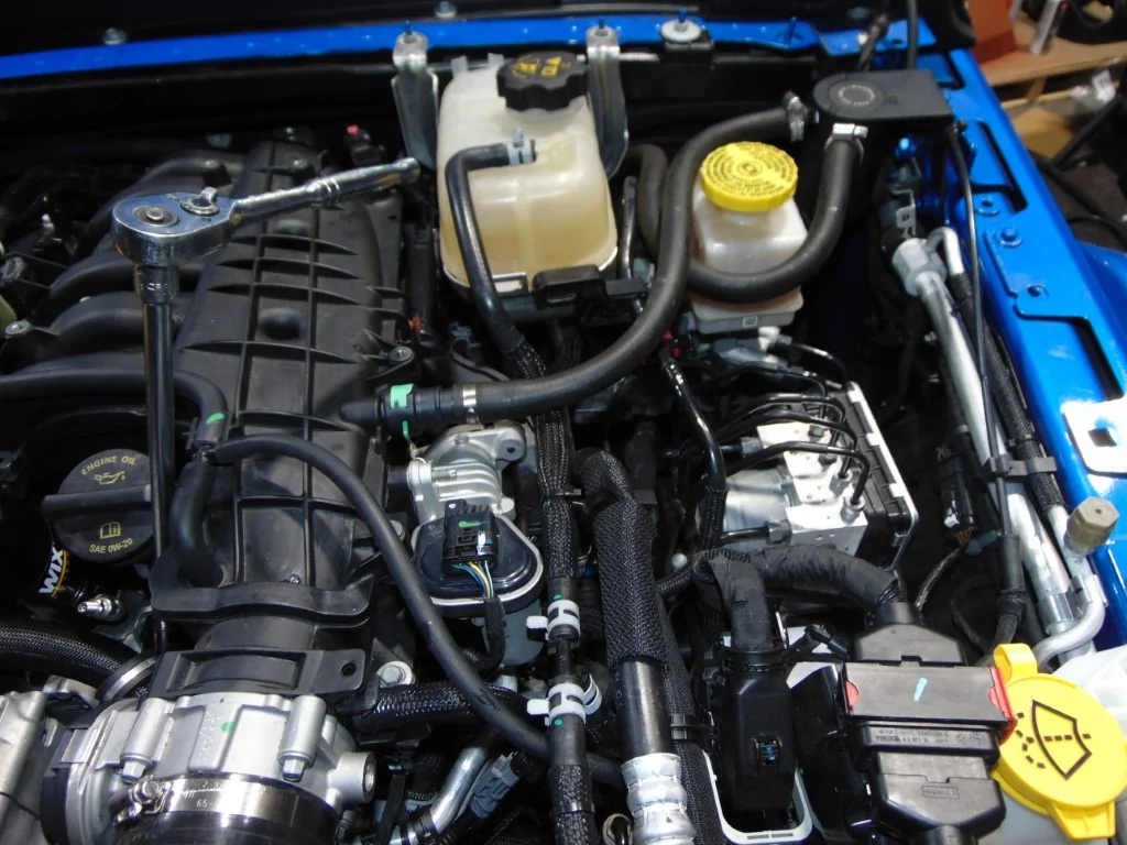

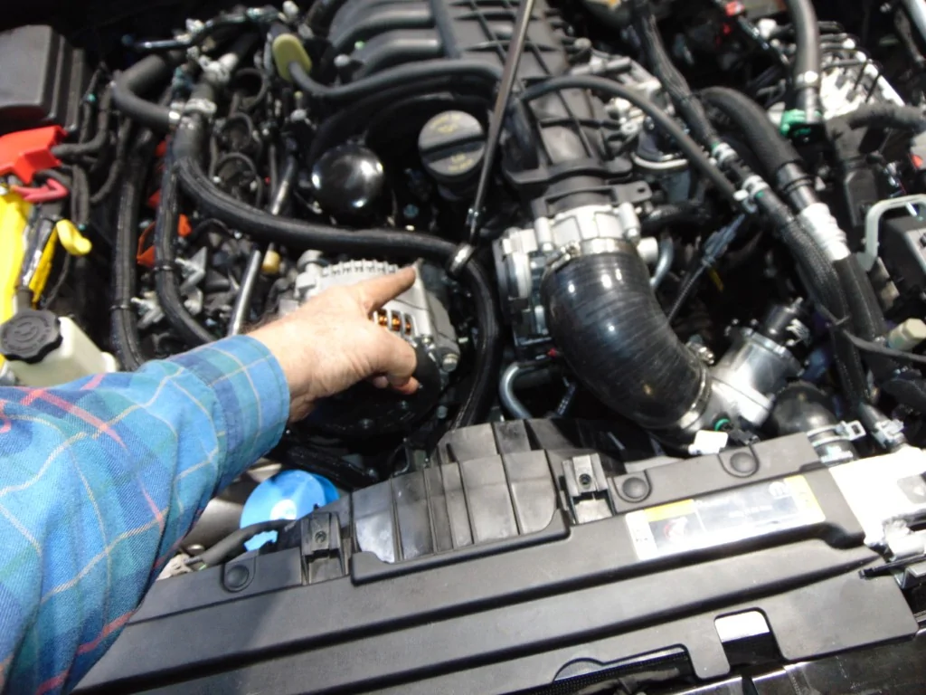

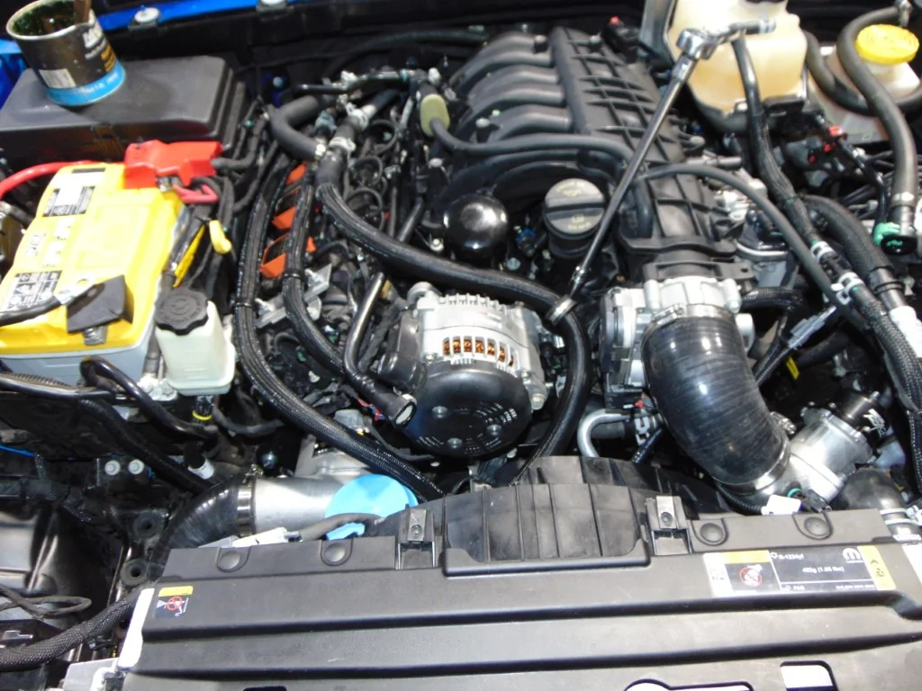

Then I went after the hose re-routing and securing all the various lines, hoses, and cables.
I'm getting perilously close now. Just a couple more hoses, modifying the grill, popping back in the ECM, programming, and firing it up.
I tossed the Ripp-specified line routing and came up with something that is better and more organized. I had to move those heater hoses because I will need room to fab up something to connect the supercharger to the existing air box. I always planned to do that so that I can keep it a true cold air system and utilize the snorkel.
Jeep Gladiator 2022 AEV Gladiator Rubicon build DSC03139 (Medium)
Jeep Gladiator 2022 AEV Gladiator Rubicon build DSC03140 (Medium)
Jeep Gladiator 2022 AEV Gladiator Rubicon build DSC03141 (Medium)

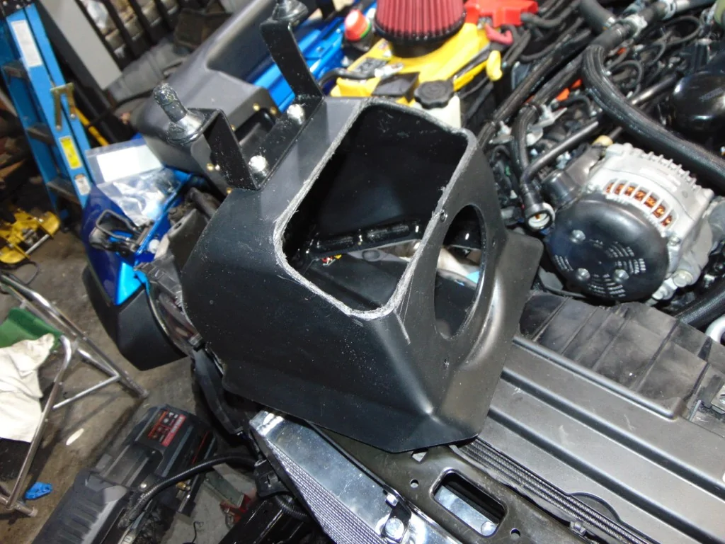

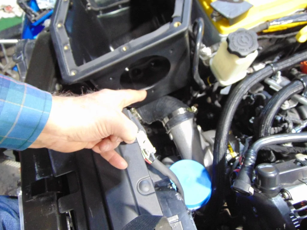

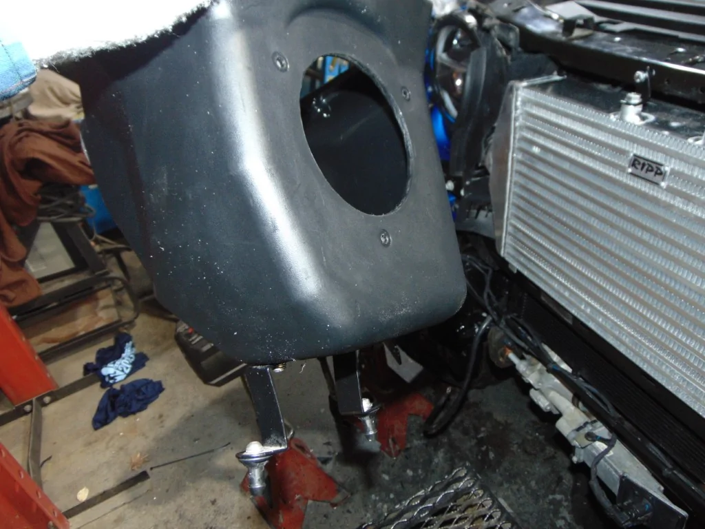

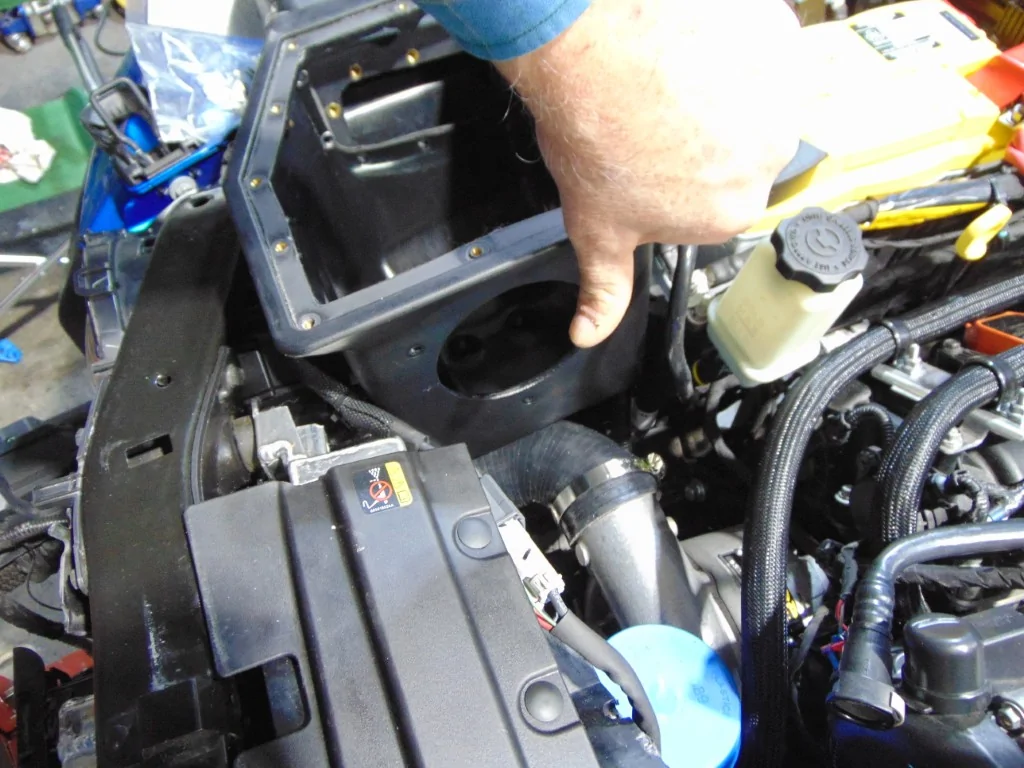

And speaking of problems, here's the next one. The air cleaner box will no longer fit because the intercooler hose occupies part of the space the plastic box used to occupy.
Jeep Gladiator 2022 AEV Gladiator Rubicon build DSC03143 (Medium)
Jeep Gladiator 2022 AEV Gladiator Rubicon build DSC03144 (Medium)

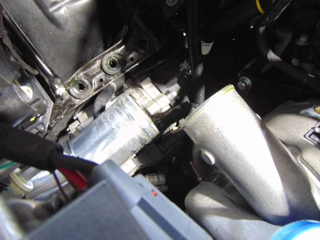

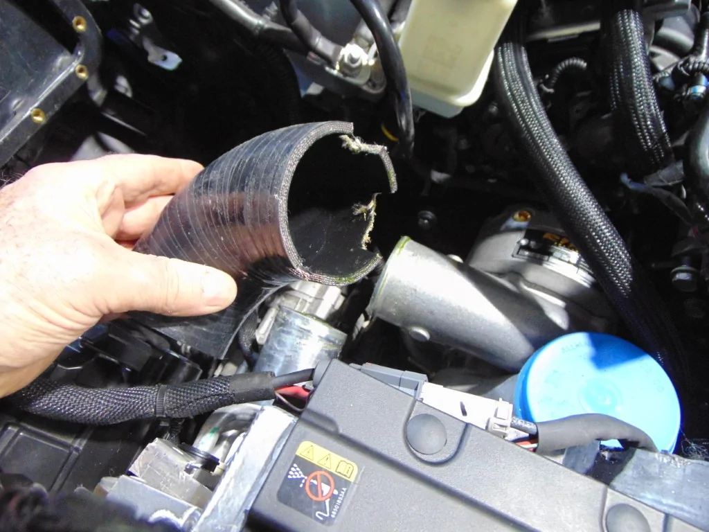

The first part of solving this issue was to notch the intercooler to supercharger elbow to allow me to shove it on an additional 3/4". Yes, we are playing with things being that close!
Then push the hot-side pipe toward the radiator.
Jeep Gladiator 2022 AEV Gladiator Rubicon build DSC03146 (Medium)
Jeep Gladiator 2022 AEV Gladiator Rubicon build DSC03147 (Medium)

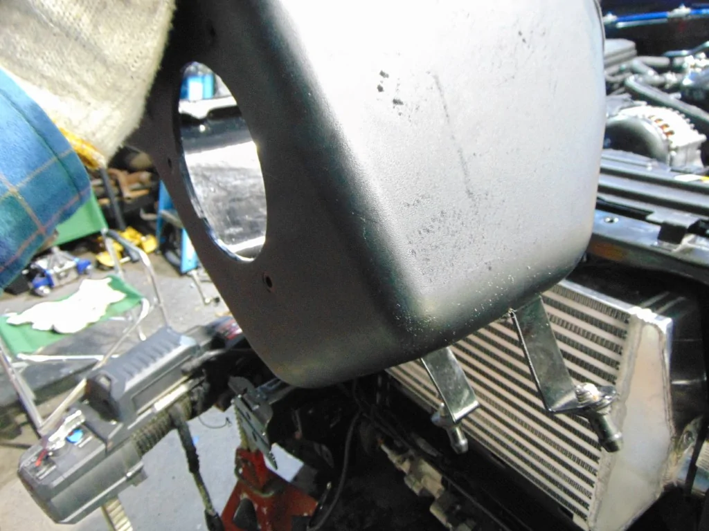

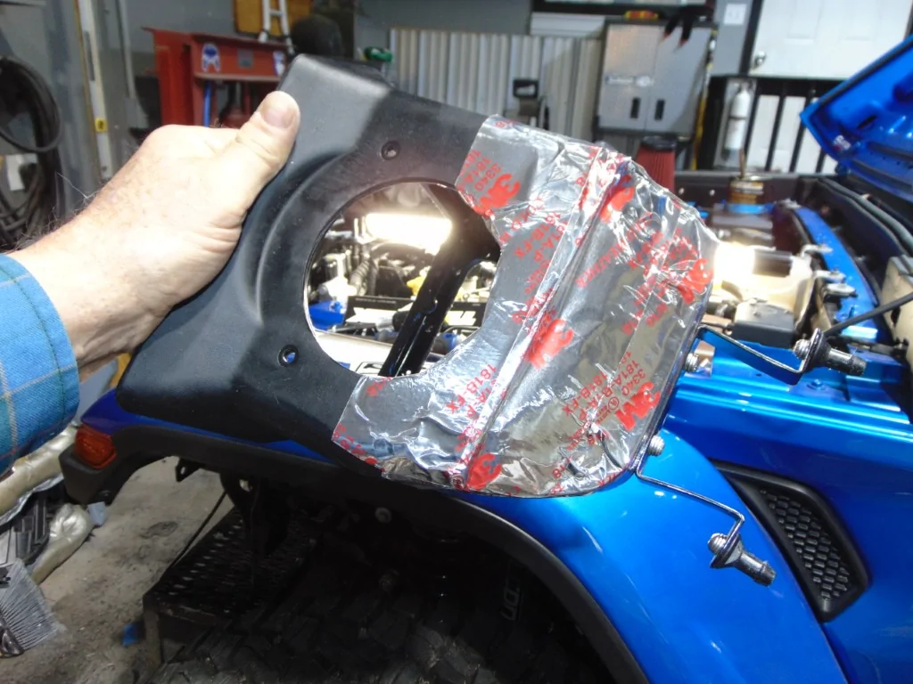

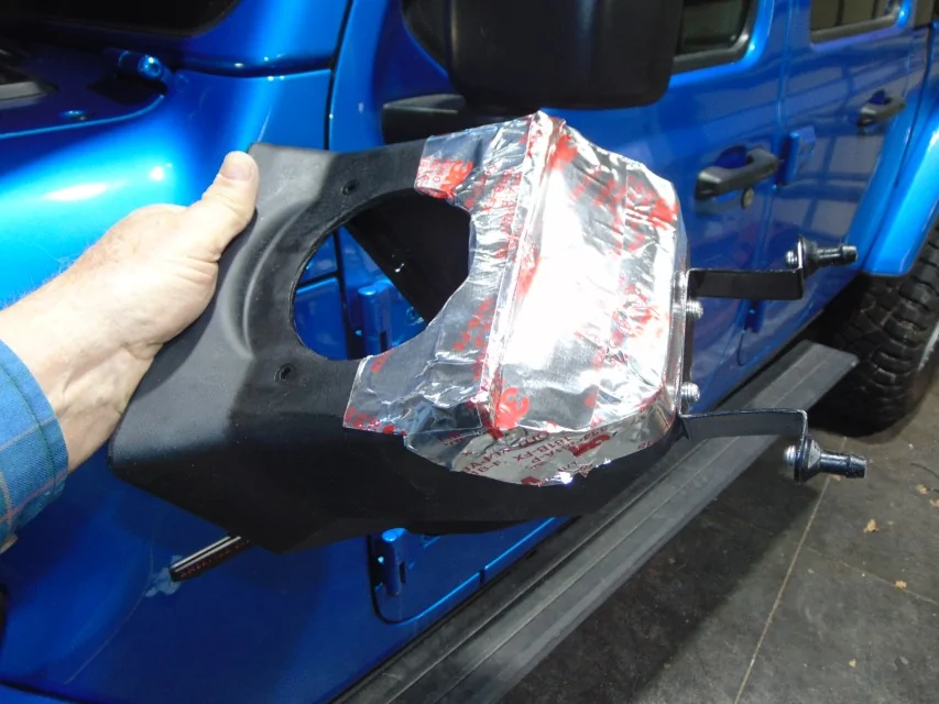

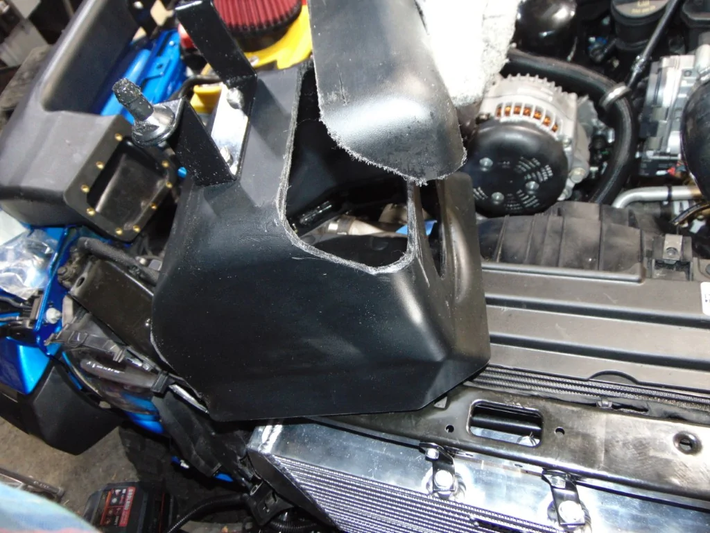

Then I had to section a small piece from the bottom of the air box to clear the IC pipe.
Jeep Gladiator 2022 AEV Gladiator Rubicon build DSC03148 (Medium)
Jeep Gladiator 2022 AEV Gladiator Rubicon build DSC03150 (Medium)
Jeep Gladiator 2022 AEV Gladiator Rubicon build DSC03151 (Medium)
Jeep Gladiator 2022 AEV Gladiator Rubicon build DSC03152 (Medium)

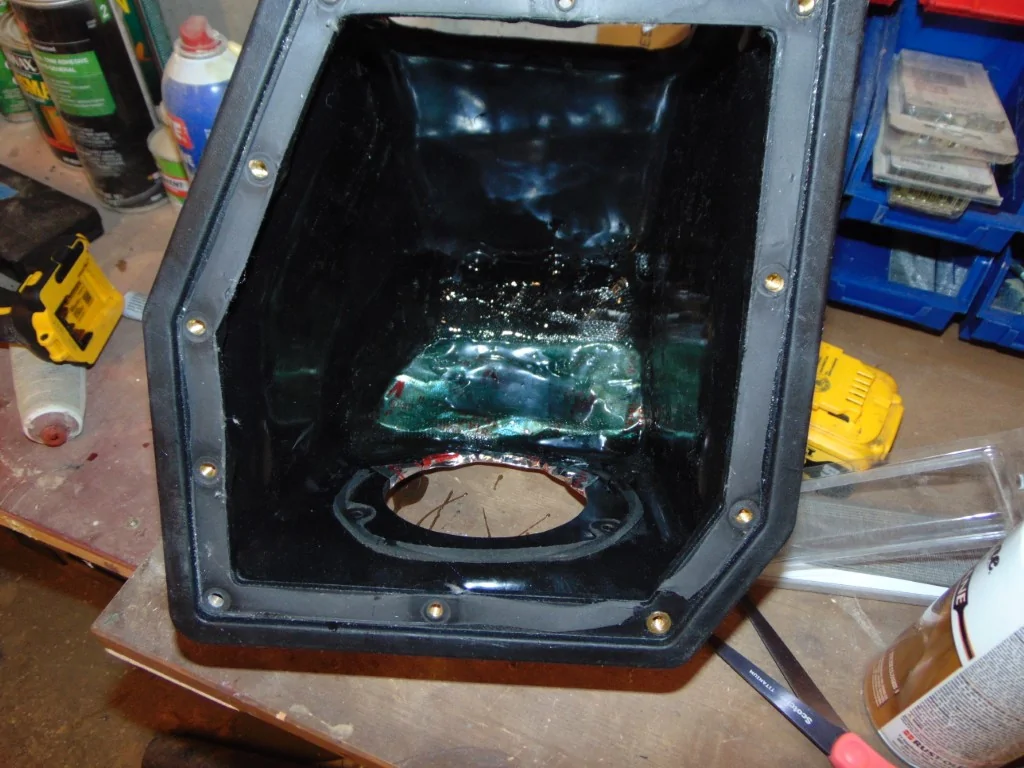

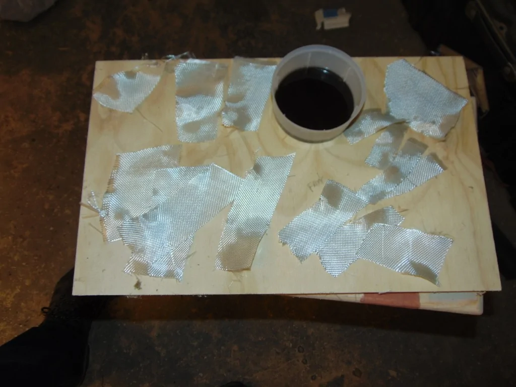

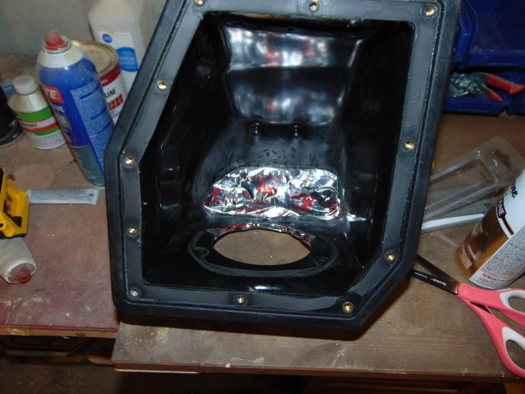

It would bolt right up at this point, but would render the snorkel system useless. I scuffed up the inside, covered it with aluminum tape, and fashioned a patch on the inside from fiberglass mat and resin.
Jeep Gladiator 2022 AEV Gladiator Rubicon build DSC03154 (Medium)
Jeep Gladiator 2022 AEV Gladiator Rubicon build DSC03155 (Medium)
Jeep Gladiator 2022 AEV Gladiator Rubicon build DSC03157 (Medium)
Jeep Gladiator 2022 AEV Gladiator Rubicon build DSC03158 (Medium)
Jeep Gladiator 2022 AEV Gladiator Rubicon build DSC03159 (Medium)
