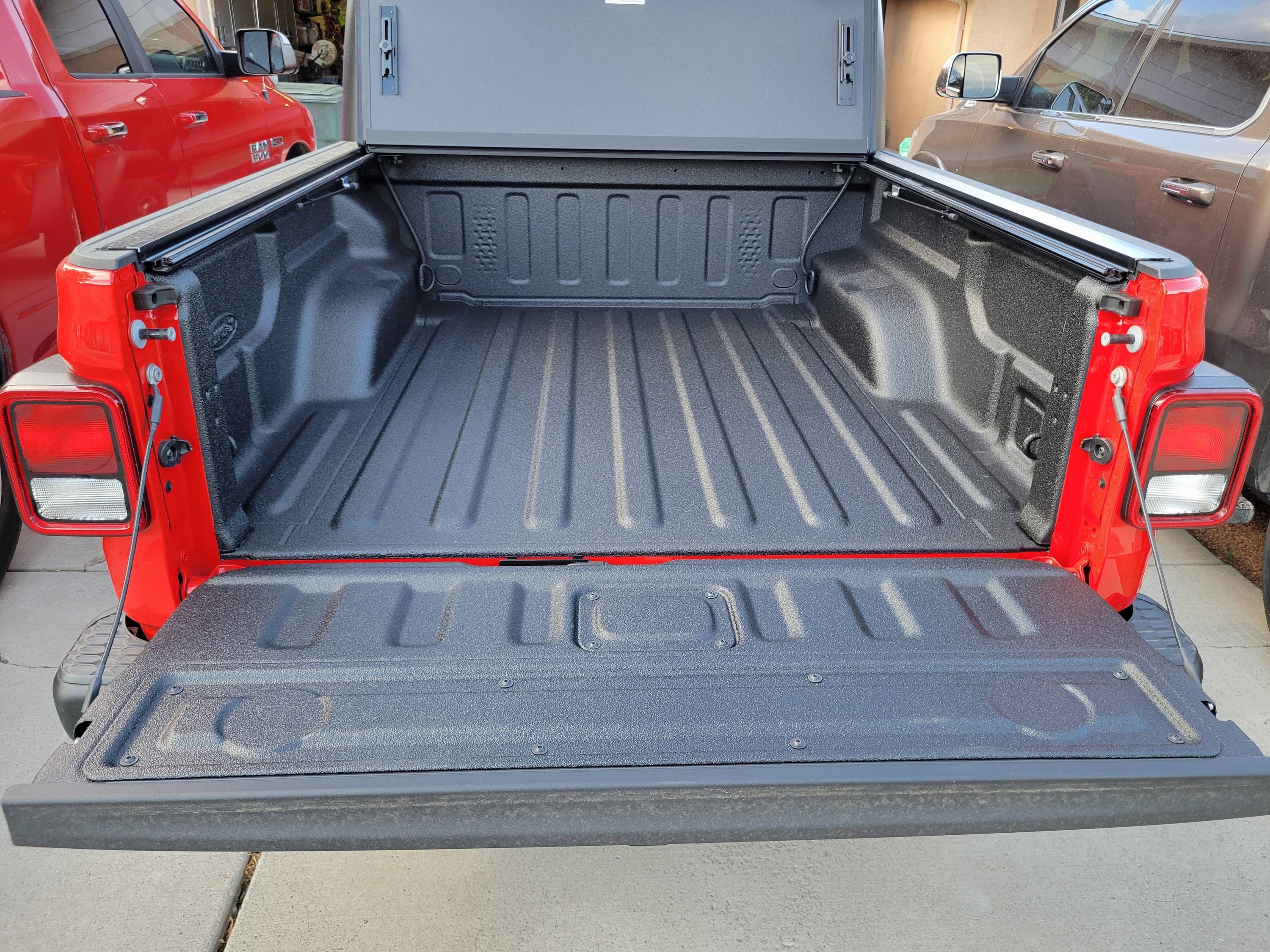

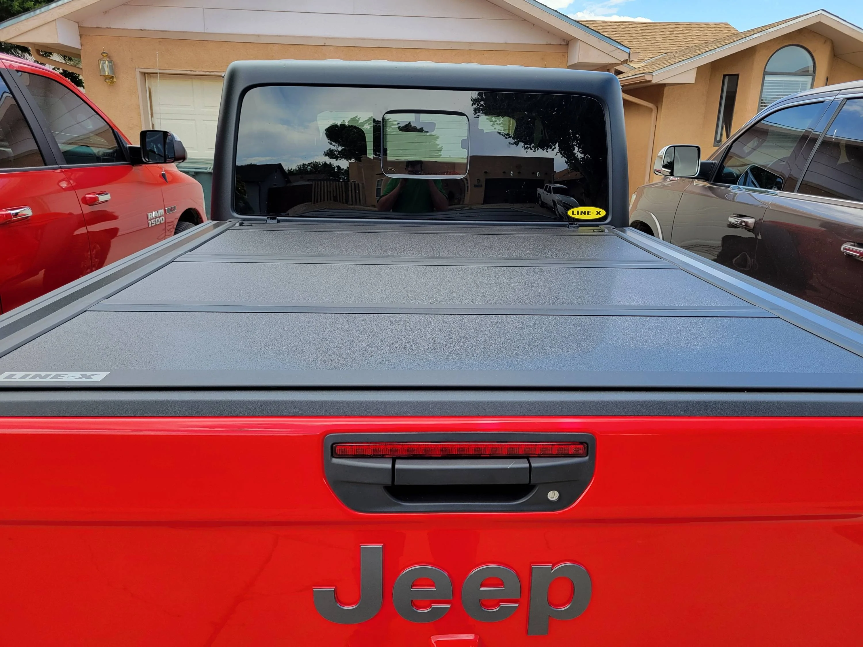

We had Line-X sprayed on the bed/tailgate and a tonneau cover installed. If I understand correctly, the tonneau cover is made by BAKFlip but Line-X is sprayed on the panels. Interestingly, the Line-X version of the tonneau cover was slightly cheaper than BAKFlip and came with a lifetime warranty. I have since removed the Line-X decal from the cover and from the rear window.

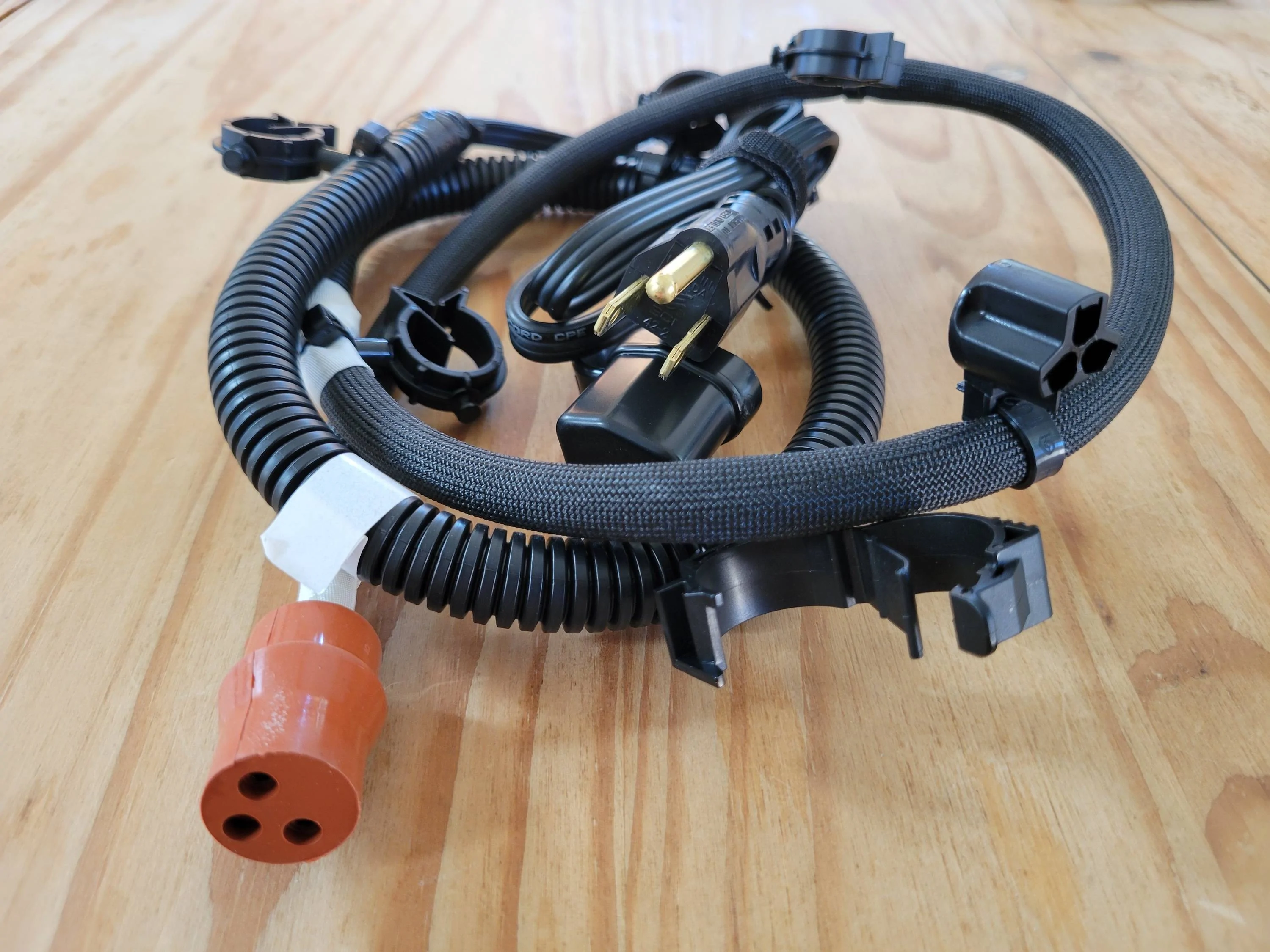

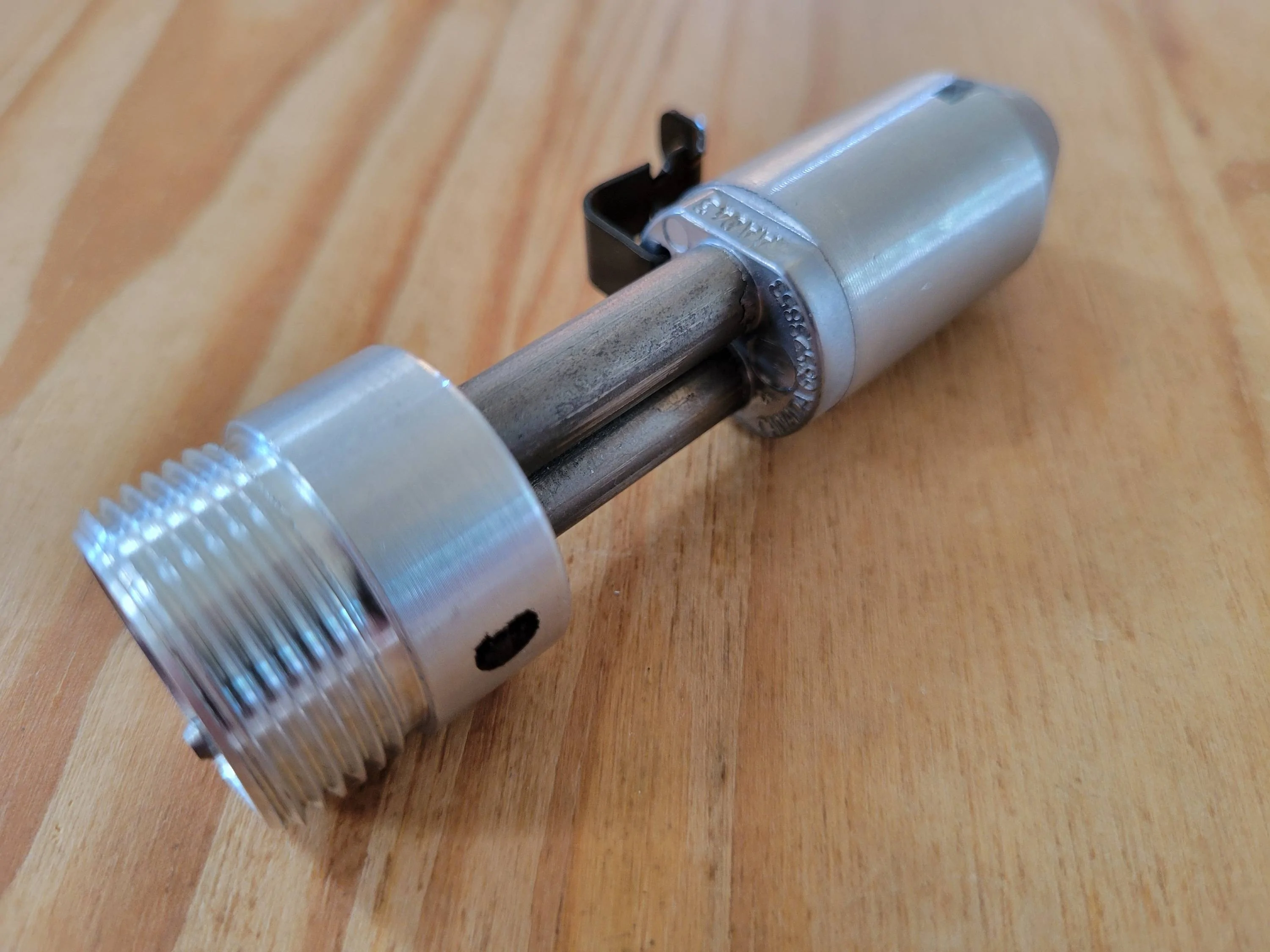

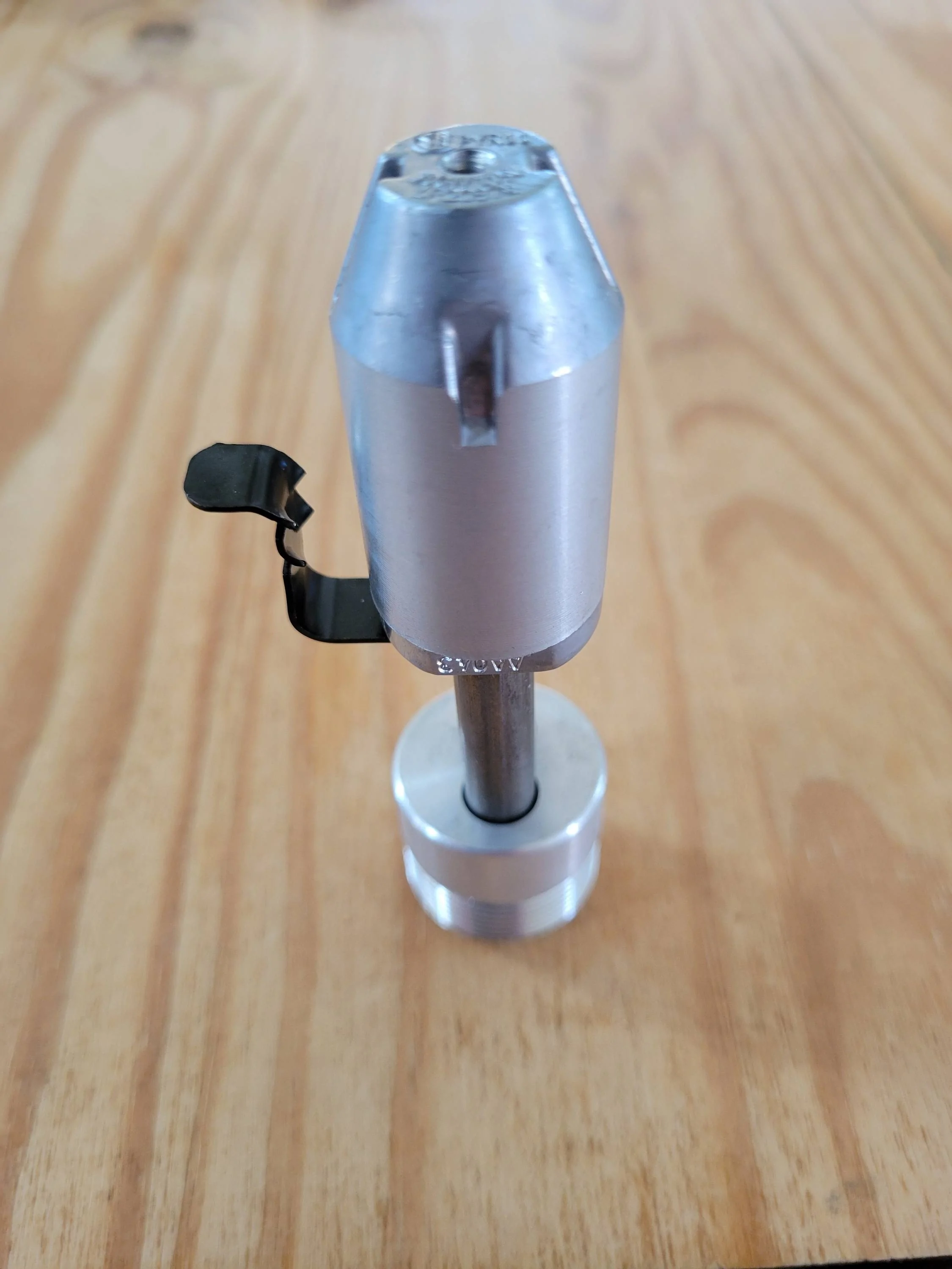

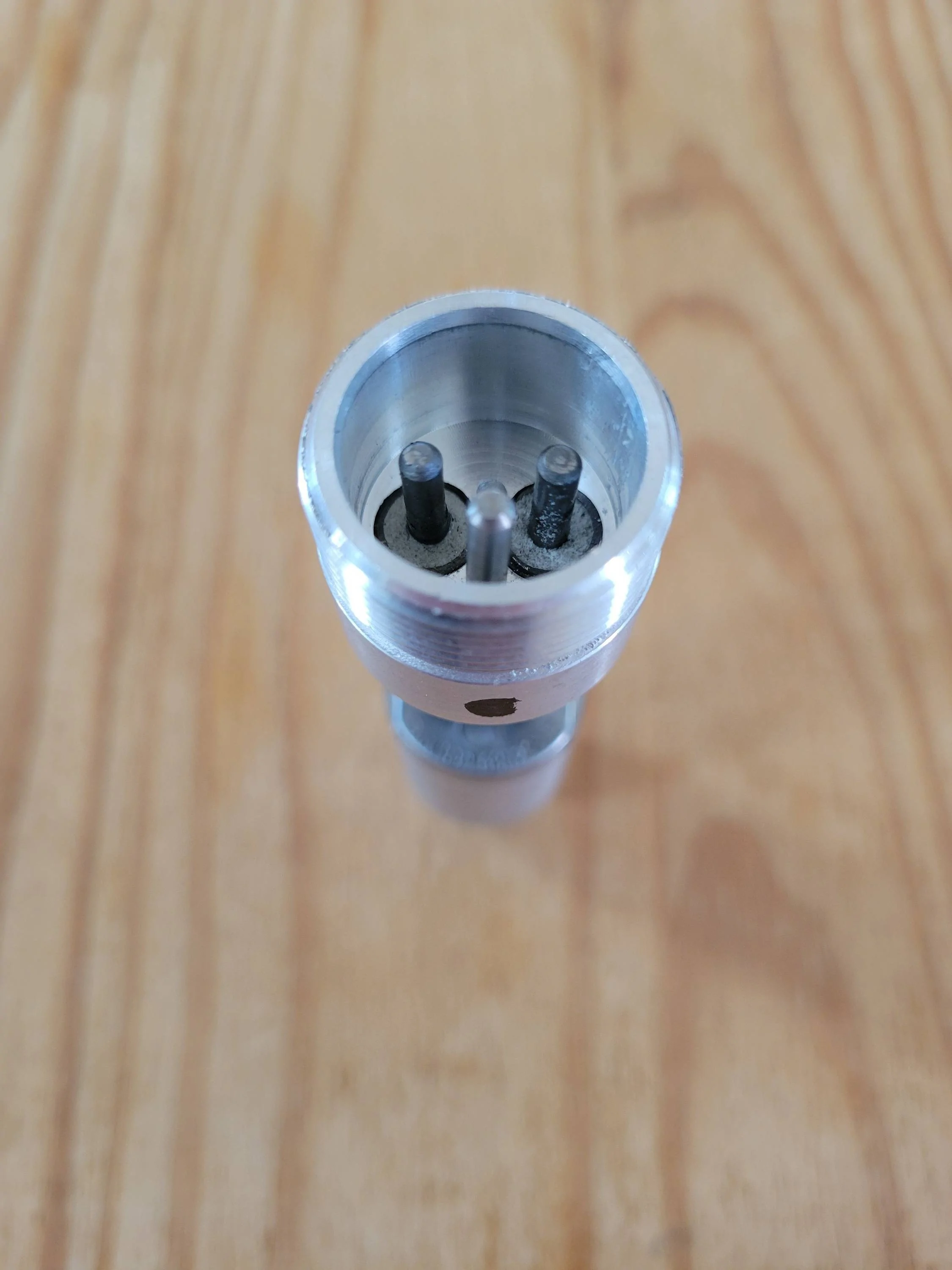

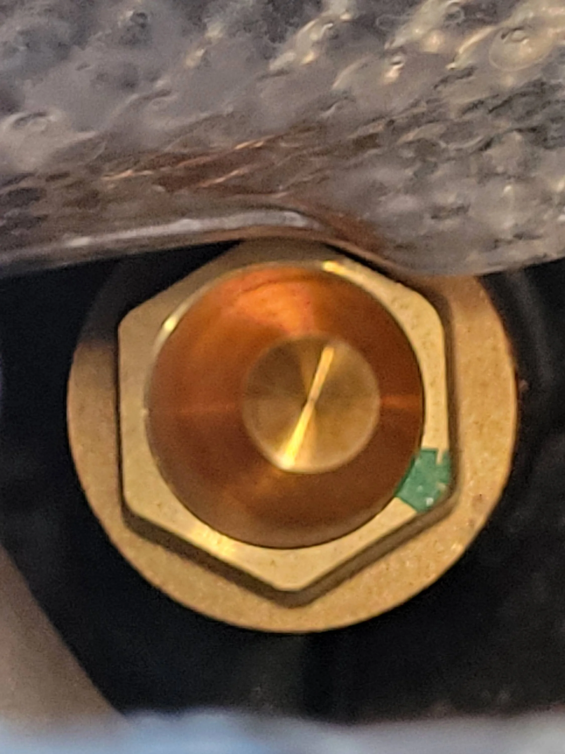

Unlike the older style of block heater, the 2023 has a brass socket on the engine side that requires a plug heater. It was a very easy install. The plug pushes into the socket and is secured with the built-in clip.
Could you share the part number on that block heater?

If you live in a very cold area, I would consider adding an oil pan heater (silicone pad). The block heater is only 300W, the old style block heater was 400W…neither of those are going to preheat the oil.
if you live in a cold climate (I'm in Alberta Canada) I would install a coolant pre heater. I have a heating pad installed underneath my battery and the OEM block heater as well.
Last winter when it got down to 0F. Have my block heater on a timer. It comes on 2 hrs before I leave the house in the morning. My temp gauge reads 100F when I start it.
