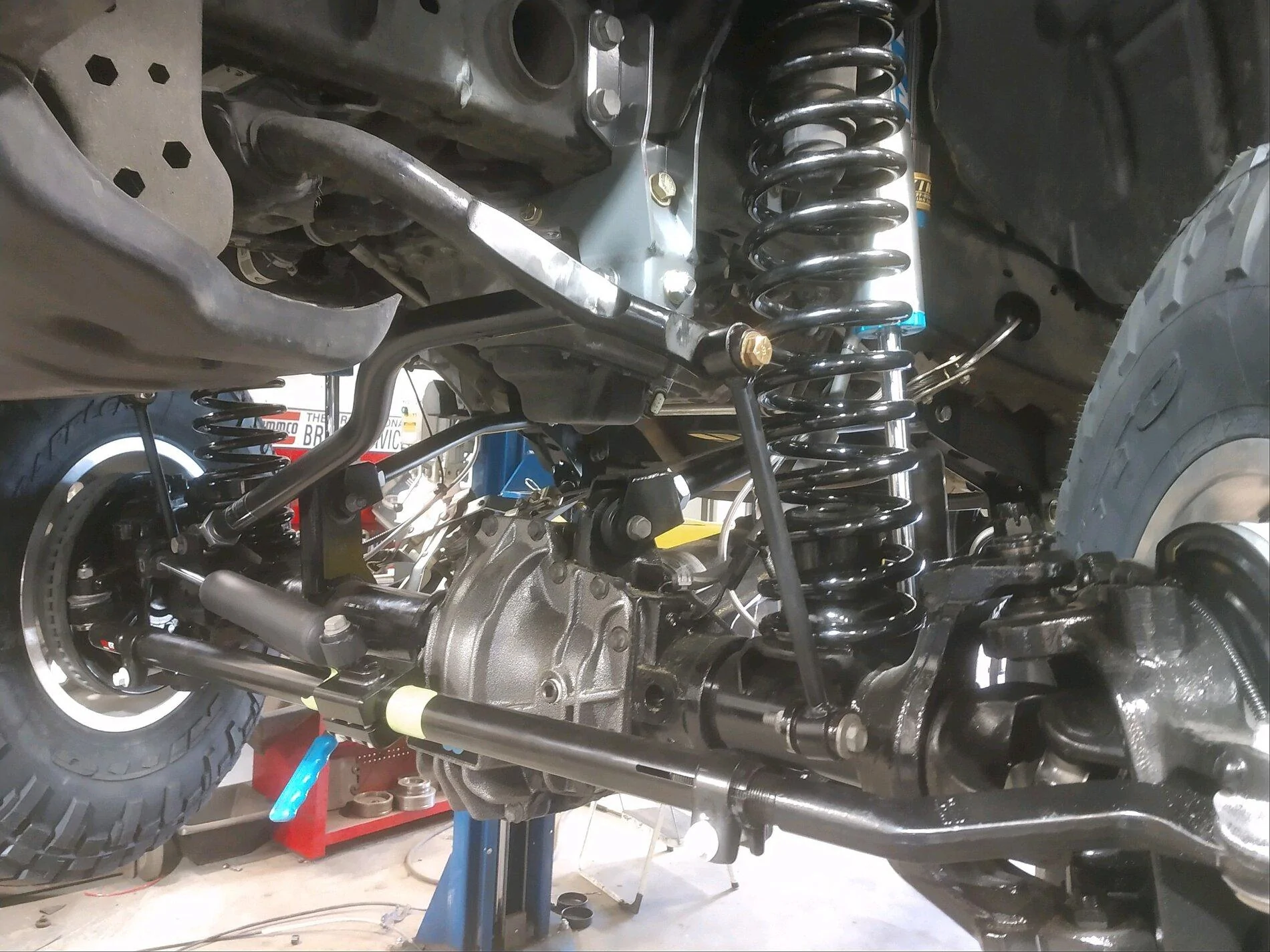

And there is the first look of them in. We get our first oh oh moment.
Rebel has installed so many of these axles over the years, its rinse and repeat to them, with the exception of this being a diesel. Well , Dana changed things up a bit on them. Among the few things that we did not know, we needed to use a JK tie rod and the drag link pitman arm on my upgraded steersmart was too short. See images.
Steersmart overnighted the piece needed and Rebel sourced a JK Tie rod. The last missing piece to the puzzle was the e brake lines were too short.

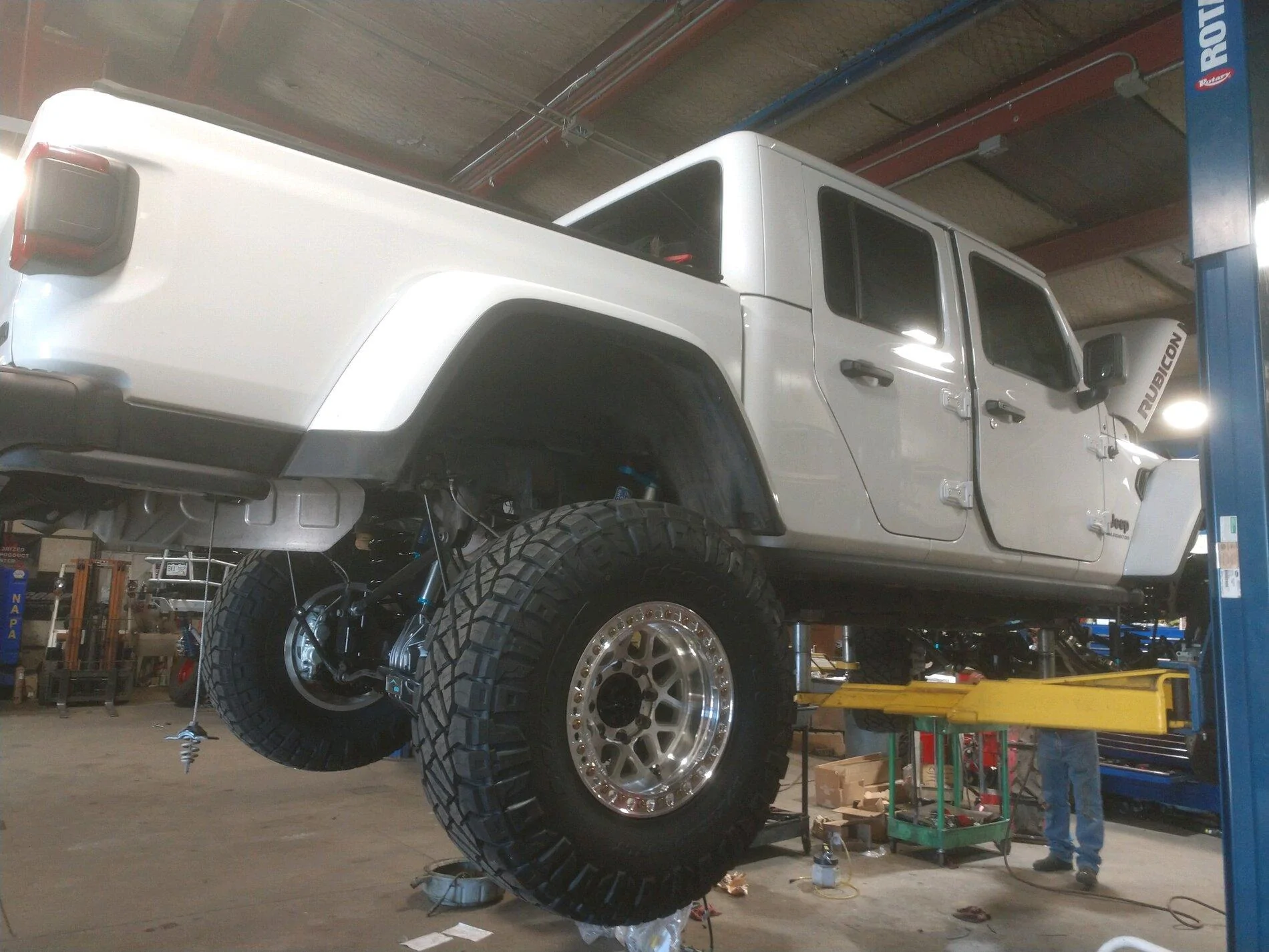

Now on to the tires. So the inhouse giant at Rebel decided to make a call out to all other shops to lift a 42" Nitto onto the truck lifted up. Little did he know in a few days he would get over 100,000 views.
So onto the next challenge for myself by going to 42" Nittos. The process to put these tires on my rims was not easy because I opted for a 20x12 and should have done a 20x10. The tire spec calls for no more than 11.5 width rim. Thankfully I have a rockstar wheel and tire guy in SO CAL that can do things like this. But what if I was in the middle of no where and needed a fix or my spare went out too on the road. Running non beadlocks was a big concern. I am in the process of going to bead locks so I at least have the ability to fix / change things on my own.
Mounted and ready to install. Rebel spent the better part of half a day checking fitment of the new axles and wheels tires.
