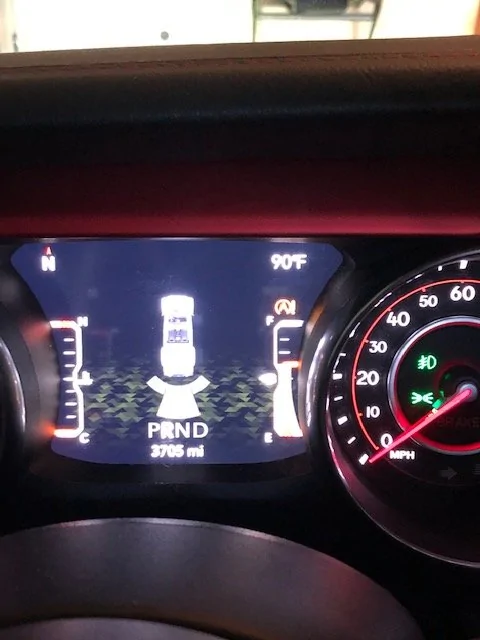

Also to add on prior to the check engine light the a with a circle around it and the ā€œ!ā€ Comes on the day prior. I believe itā€™s the light that indicates something wrong with the auto start stop feature. Could that possible be connected to the cylinder misfire code that keeps coming up

Related - a misfire on restart could cause it to kick into disable ESS.... but I'm not sure how they have it programmed exactly

Tacoman03
Apr 26, 2019
329
417
NW ARKANSAS
2020 Bright White JT Gladiator Rubicon; 2018 Range Rover Velar; 2017 Jaguar F Pace
My dealer thinks they narrowed my ESS Warning Light down to a faulty door switch. Pic below for reference of warning light on my dash...
