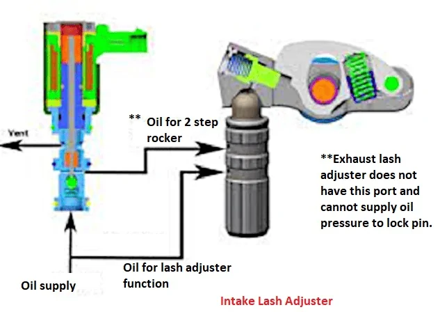

I swapped the cams and found the bank 1 lobes to be consistently ground whereas bank 2 was more erratic.
There has been some assessments that Jeep installed the exhaust lash adjusters on the intake cams. Based on my tear down, this is not the case. The lash adjuster part numbers have been updated to a new rev and look different than the old adjusters. But there is no way the exhaust lash adjusters would work on the intake side. The height is just too different. The exhaust adjusters also have no oil paths whereas the intake does.
Lash adjuster photo:
Jeep Gladiator 3.6 Cam Self destruction Intake vs Exhaust Lash

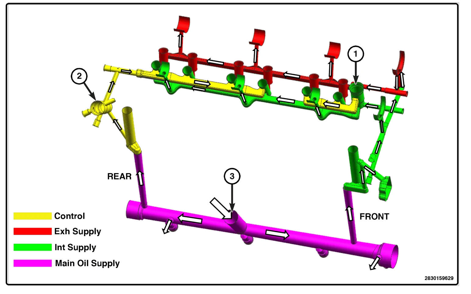

The wear pattern along the cam is really puzzling. It does not align with solenoid control circuits. It's as if the control channels aren't enabling the same oil pressure across all lash adjuster pockets.
I am tempted to get the adapter to test oil pressure at the solenoids to understand if they are receiving the necessary pressure.
While I don't mind the diagnostic journey, I am most interested in finding a final repair. Rather than swapping cams every 5k miles or heads, etc
VVL Oil Circuit

I had to replace a right intake camshaft on a '22 Grand Cherokee 3.6 this week. It had one high lift intake lobe wiped out, another one just starting to wear. I believe that the heat treatment of the rockers may be partly to blame for these failures. If there were an oil supply problem, the rollers on the same rocker should show signs of oil starvation, and there are no signs of this happening. Also coming into play is the fact that the high lift section of the rocker does not rotate like the old cam in block flat tappets did. They always have the same contact with the camshaft on each revolution. This would definitely accelerate wear. Just my observations, but I have worked on thousands of engines, including several hundred 3.6 Pentastars, so I have some experience with the failure points of different engines.
There could be oil starvation to the yellow channels (shown above) which control the low-lift pin retraction. The oil restriction could be from a casting issue and/or blockage from channels simply being too small. I doubt the channels are designed too small, if they were this would be happening on every 3.6.
The lash adjuster and other oilers could be receiving acceptable oiling but the port for the 2nd step activator is now.
There is no doubt the non-roller contact surface is a terrible design. I figure the engineers didn't expect the engine to run in high lift mode all that often so they skimped on the High lift wear surface.

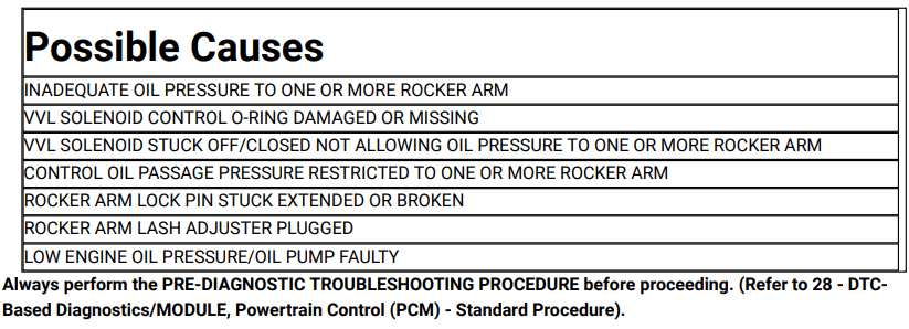

This is an excerpt from the diagnostic tech guide. I tried running the VVL test sequence with my Micropod II but the sequence would error out each time.
Jeep Gladiator 3.6 Cam Self destruction 1664582140926
Jeep Gladiator 3.6 Cam Self destruction 1664582286758

(glad someone found the image I posted useful - it's been out there for a while but people still toss out guesses instead of looking at the actual design like is happening now, finally)
The way this works is that if the PCM through self-testing sees that any rocker is stuck on high lift mode, it drops them all into high lift mode. It won't allow only one to operate that way.
That being said - why wouldn't the left bank also have the exact same issues?
Could be a difference in oil supply.
As far as lash adjusters in the wrong holes - a couple of people I trust totally in these engines showed what he found and yes, they were messed up in his engine.
