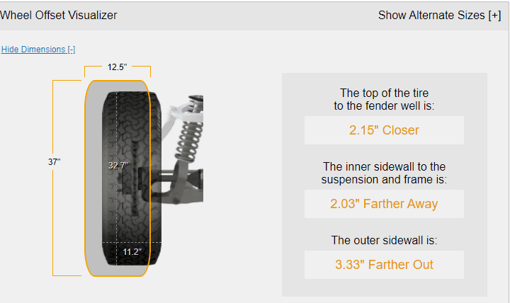

I ordered a new suspension kit for my rubicon, so i'm trying to figure out the best wheels to go with.
The manufacturer suggests less than 3.75" on the backspacing, but I know the dana 44s come with about an extra 1"-1.5" in length (can't remember exact length).
Could I get away with say, 17x8.5, -24 offset, and 3.81" of backspacing? With a 37x12.5 tire, how much will they be sticking out past the flares?
I'm not sure if the manufacturer recommends that based on a non-dana 44 or what, so I was hoping to go with said wheels.
Thanks!

Man your talking about training wheels sticking way far out there.. Stock compared to the 37x12.50r17 at just the -25 offset is going to widen your truck by over 6" as it is. I would look for what other people have ran on that kit or pick a different kit if it was me as I dont appreciate the training wheel look. Then again your a chiefs fan so that may be a little more natural for you.

Hey what kit is that... The number seemed weird so I pulled up the EVO website & couldnt find that you have listed. What I did find was this
"All models will require wheels spacers or aftermarket wheels with 5” or smaller number backspacing. "
http://www.evomfg.com/technical-doc...5.pdf?_route_=technical-docs/EVO-3062S4PK.pdf
On an 8.5" wheel that would be an offset of +6 which means that the vast majority of aftermarket wheels out there would be fine as most are 0. I seem to remember someone here also running the Evo system on the same AEV Borah wheels I have which are +25 even (My clayton lift kit called for no more then 4.75" backspacing if I remember right & I am at like 5.73" with an ever so slight amount of backspacing).
