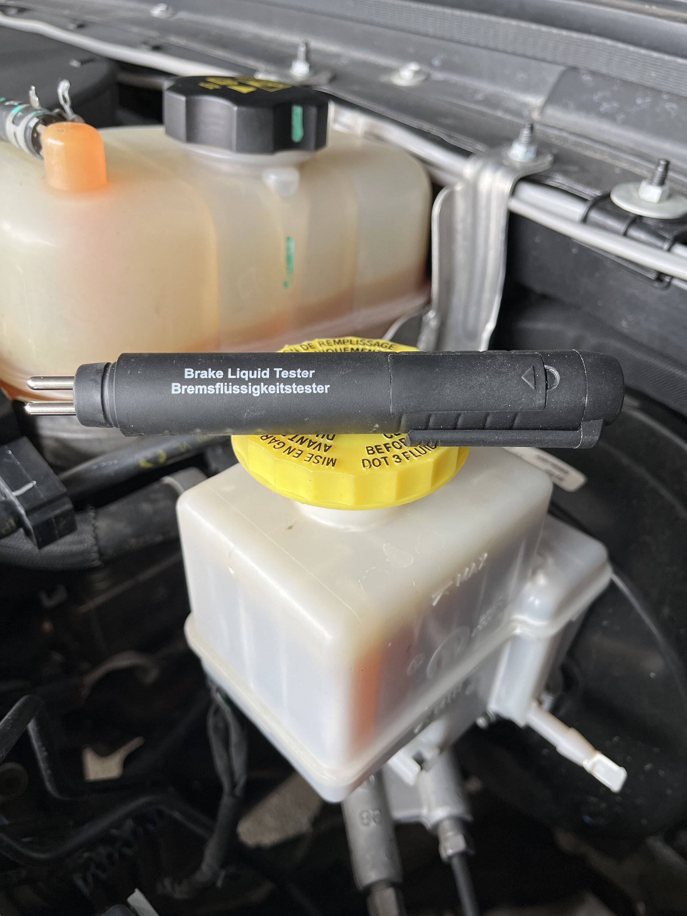

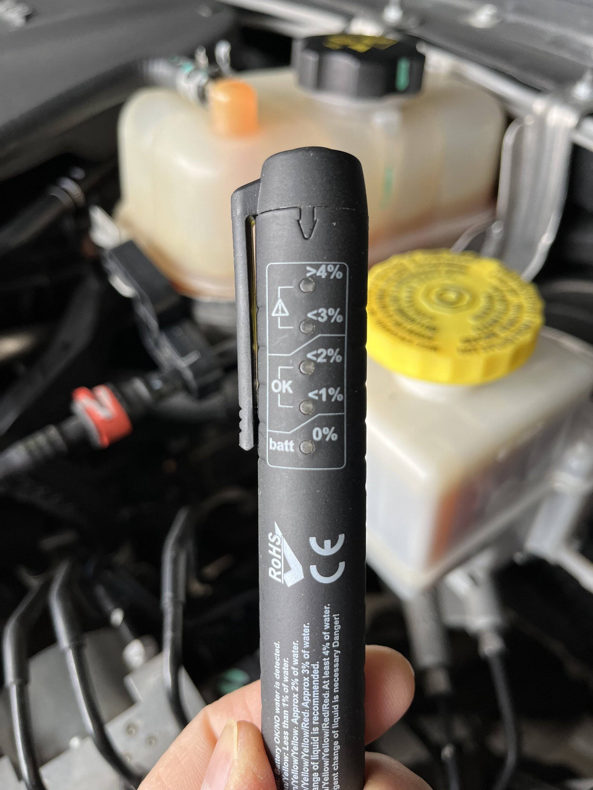

As far as the brake flush goes, go to your local auto store and pick up one of these gizmos that reads the moisture content in the fluid. Let it tell you when the flush is needed.
I actually went out to do some pics for you when I read this thread but when I went to use the tool on the brake fluid, there’s a screen just under the lid and the fluid has dropped just under the screen so the tool probes can’t touch the fluid to do the test. 🤬 So I’m off to get some DOT 3 Fluid and top it up to the max line and after a while, I’ll check the condition of the fluid with the brake fluid tester.
Don’t assume! Get tests done, do your own stuff, have the right tools to check stuff like this and you’ll never be at the mercy of guesses, opinions and pressure tactics.

I just do it because H2O content is part of the story (and measured only at the reservoir)
If you add fluid, you'll have to do a heck of a lot of driving and braking to get a decent reading.
