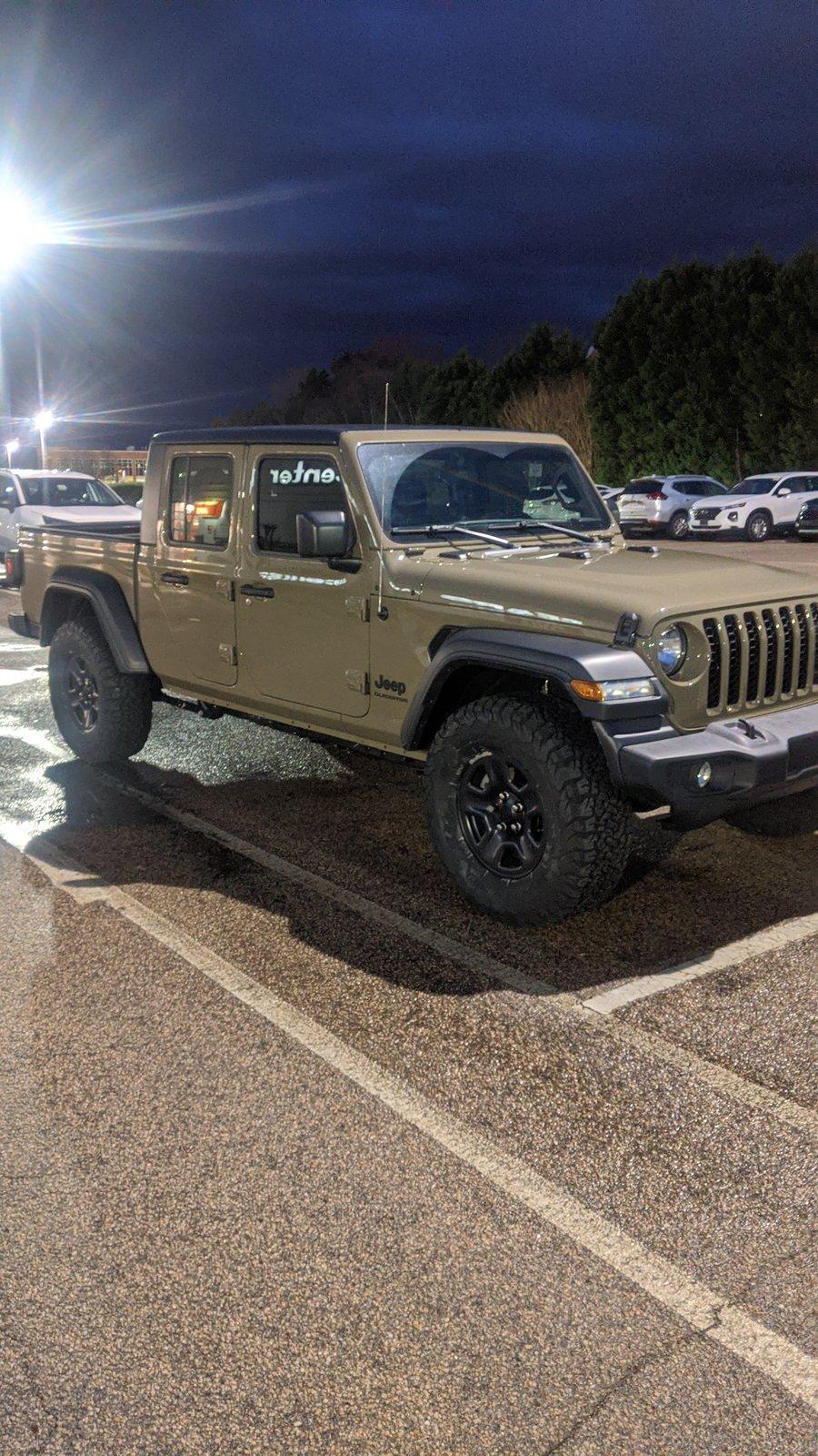

I trim the air dam section last night on the bottom didn't really care what it look like when I got done. I'm planning on removing that bumper anyway. 35's going on today and 2.5 inch ReadyLift SST going on tomorrow, didn't need the 2.5" but just in case the 37 bug hits me.

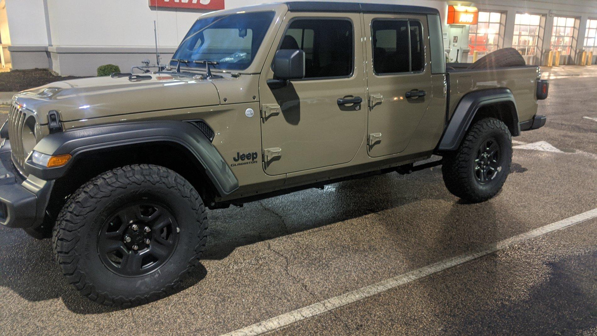

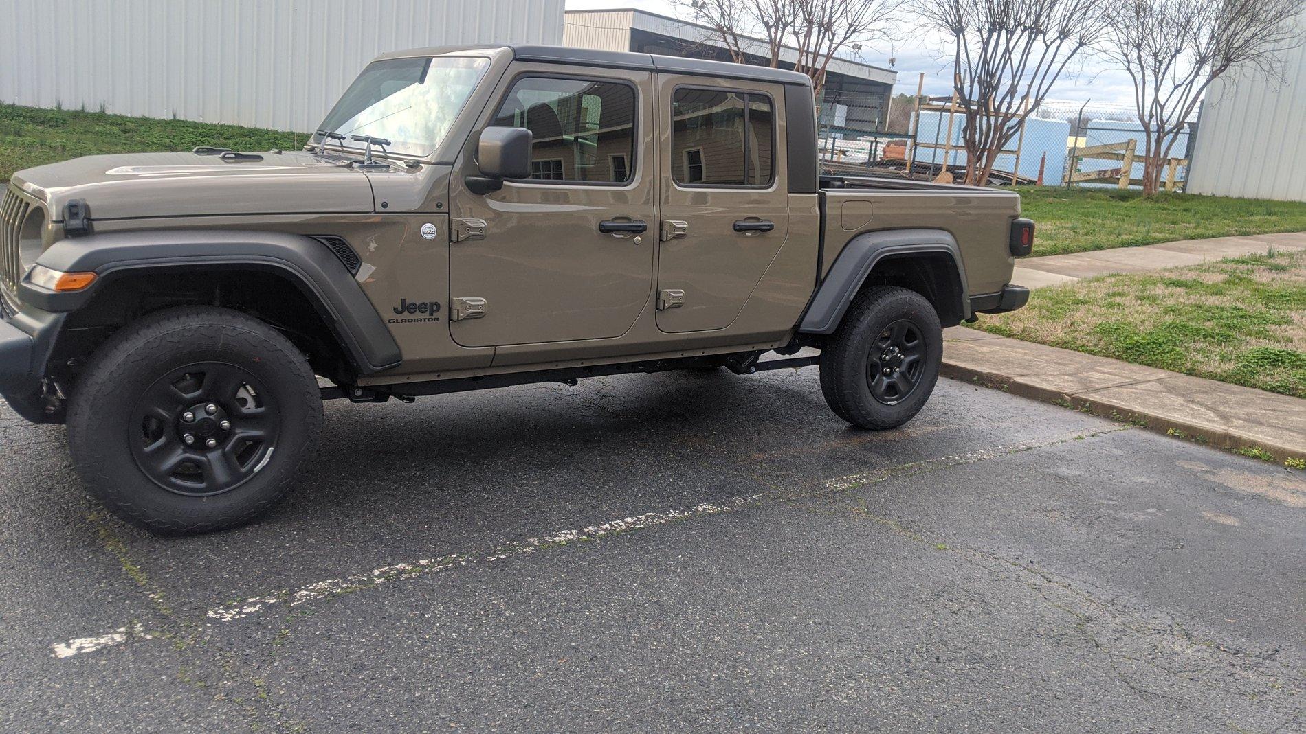

Tires being installed as I type. Before and after coming. I'm excited to get these stock tires off the JT. Glad my wife is on board. After having the JKU lifted and big tires, first thing she said the next day was, you gotta get bigger tires and lift it. Lift going on in the AM

Looks fantastic as-is! Are those the 285/75-17s? I think I'd leave it just like that!
Thanks! I got the lift going on today, 2.5" ReadyLift SST. I'll probably bump up to 37's after these wear out but who knows. These are 315/70-17 BFG K02 All terrains. They Are pretty much the same as a 35 12.5-17 BFG K02 all terrain, just slightly lighter. Basically considered a 35. I'm super pleased with how it turned out. Only some minor trimming on bottom of the front air dam to get them to fit stock on my sport s with Max tow.
