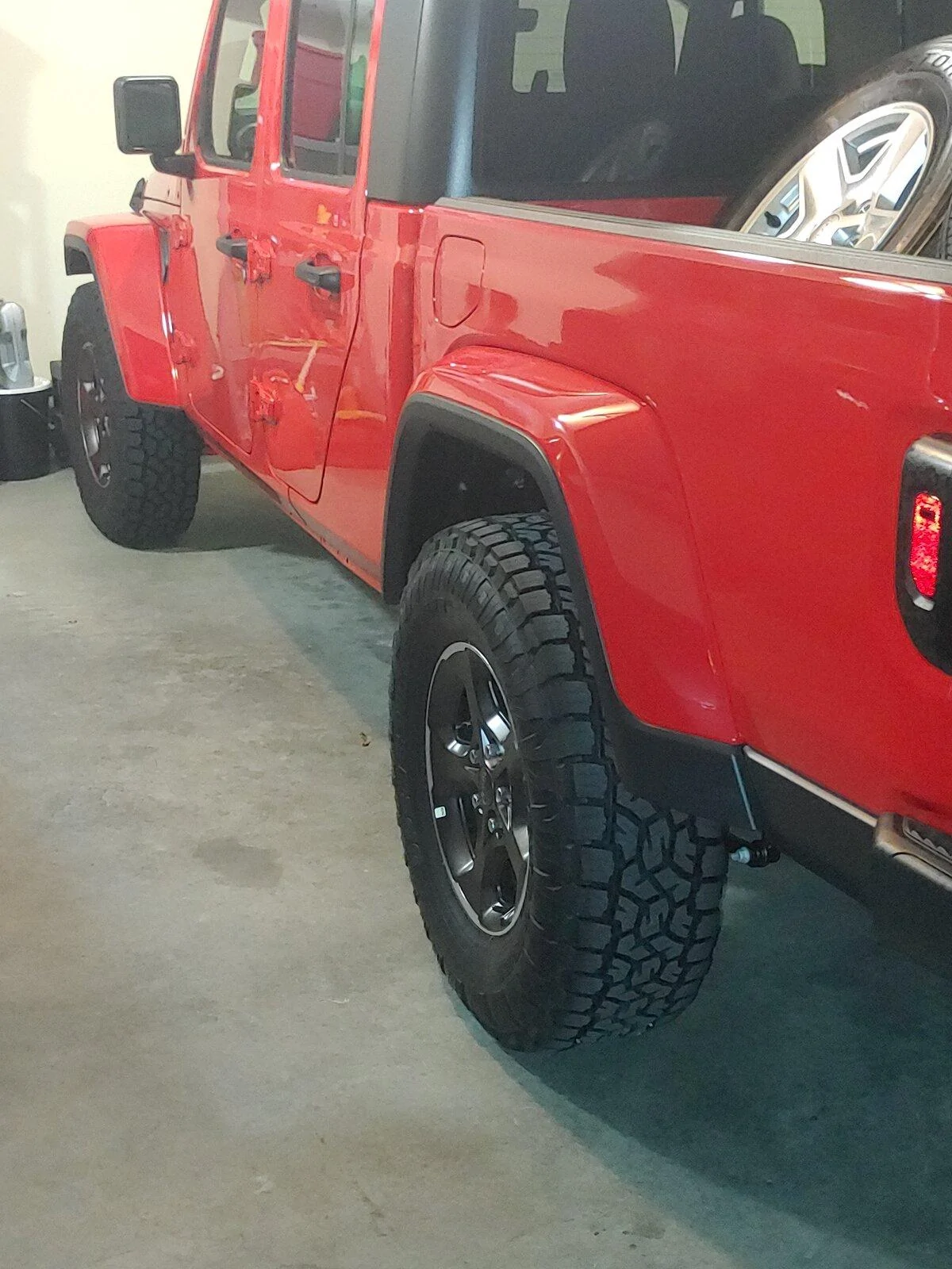

I am running 285/75r17 Toyo Open Country at3's on my Sport S with 3.73s. I noticed a slight decrease in pep, but it is not bad at all. I am very happy with it. I do recommend recalibrating the speedometer using jscan or tazer etc.

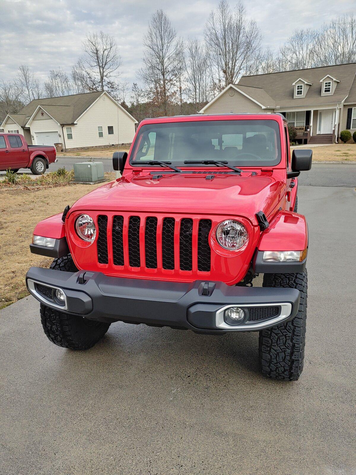

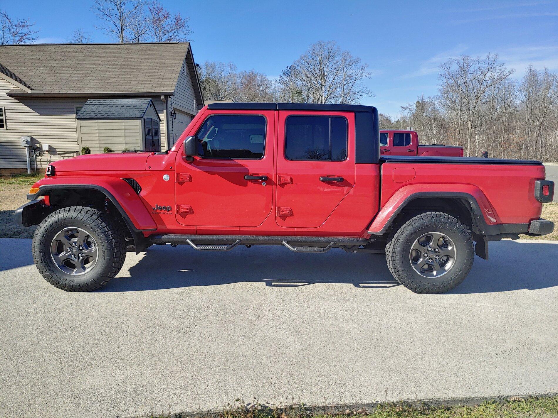

First picture is right after I got them before the leveling kit went on.

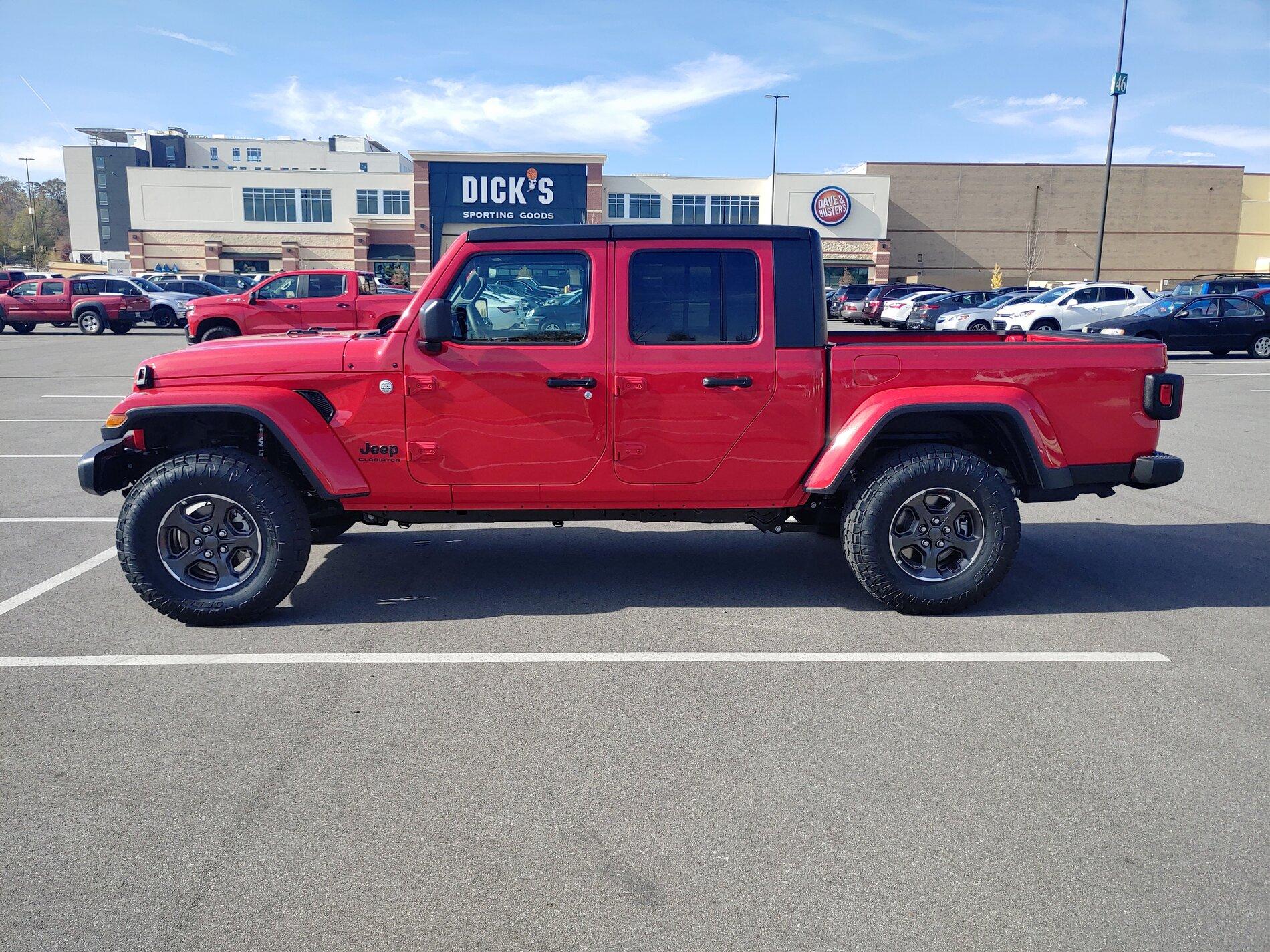

Jeep Gladiator 34 inch tires with 3.73s 20210308_154730_HDR
Thank you!! Those look like they fit well.
In the final pic, is there something in the bed or does the leveling kit cause a little “nose high”?

No problem! There was nothing in the bed in the last picture. It is hard to tell, but my driveway has a slight slant towards the road that makes it look more nose high than it really is. I put the Rough Country 2.5" leveling kit on it, and I may end up putting a .75" spacer in the rear to bring the back up a little. If I measure from the bottom of the Jeep in the front and back it is completely level, but the rear fender flares have a smaller gap than the front, and I believe that makes it look nose high. This picture was taken on a more level surface.
