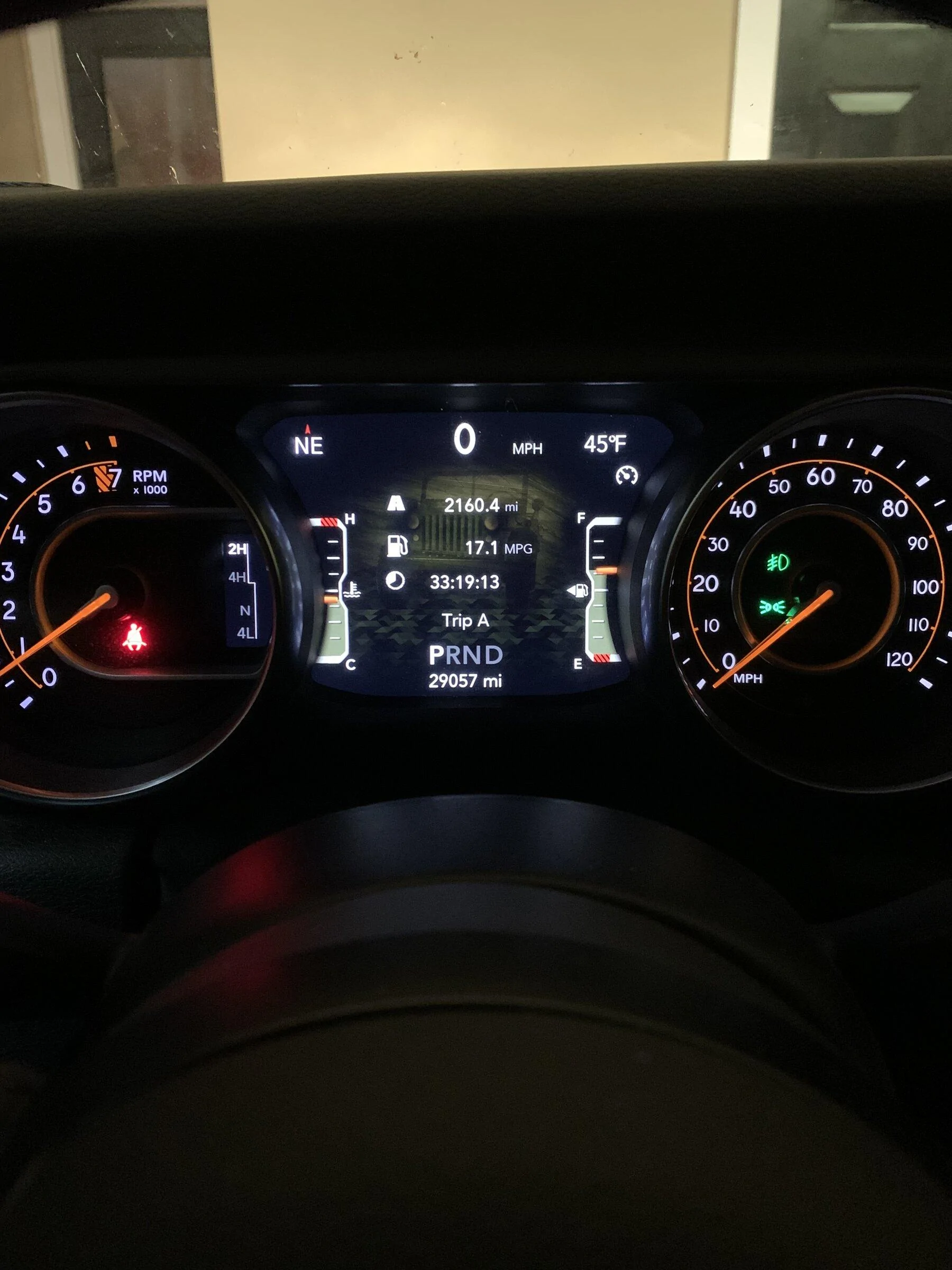

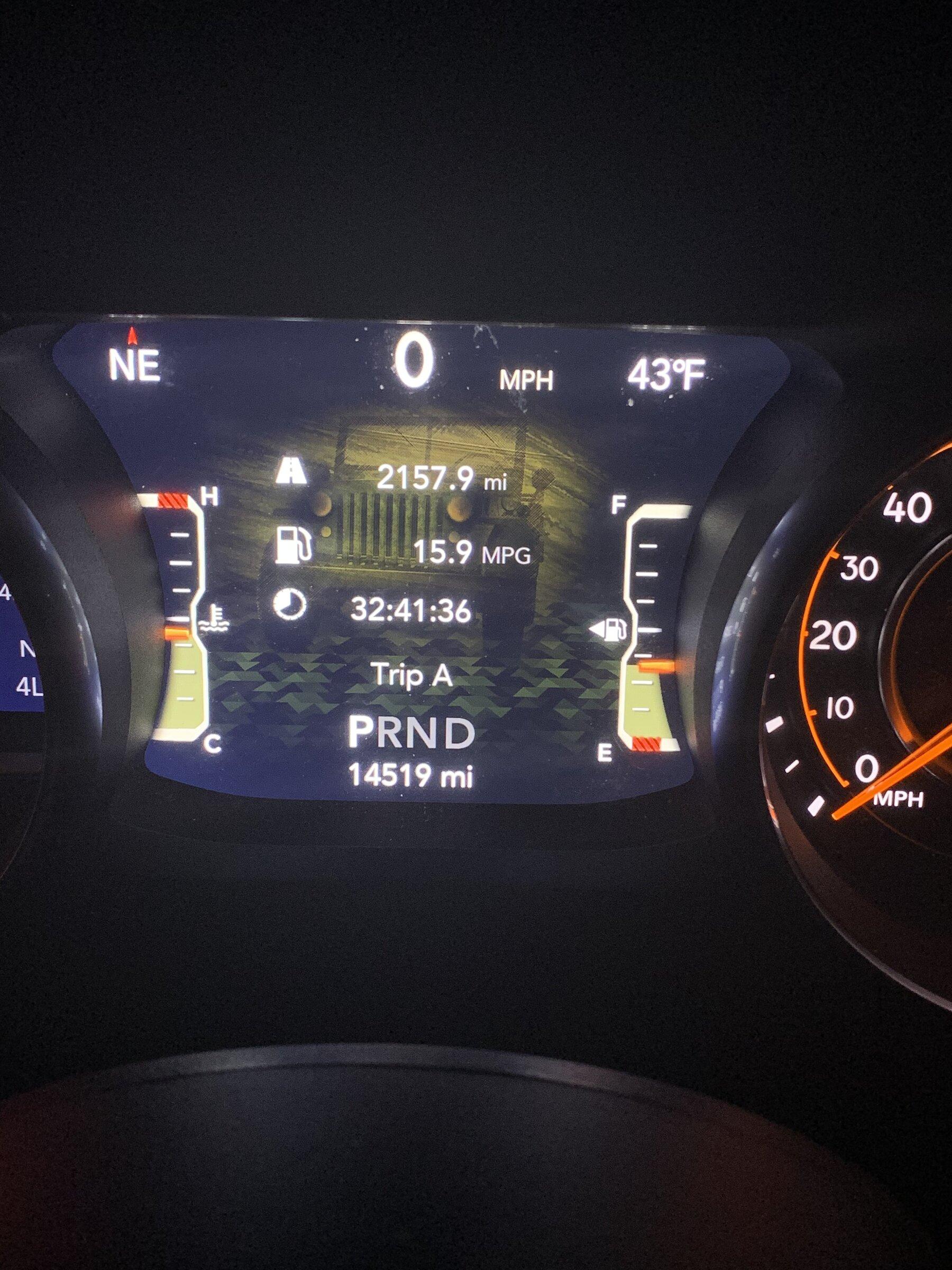

Been running 4.56 for almost two years.
3.73 with 35’s on mine … 6th gear damn near ALL the time, saw 7th very rarely and didn’t even know that 8th was there
my fuel economy sucked stock never saw over 19mpg and saw 19mpg once… on my very first tank.
I tend to drive the speed limit and with cruise… I’m in La. … pretty flat
Going back and forth to Ohio during late October/early Nov with 35’s and 3.73 first pic, a year later , same drive with 4.56
I really like the 4.56, the biggest shock to me was the first time I put it in reverse after the gear change. Big difference
