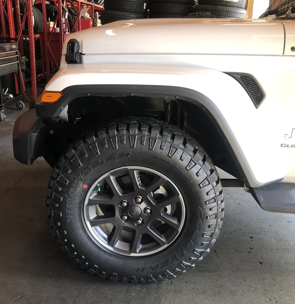

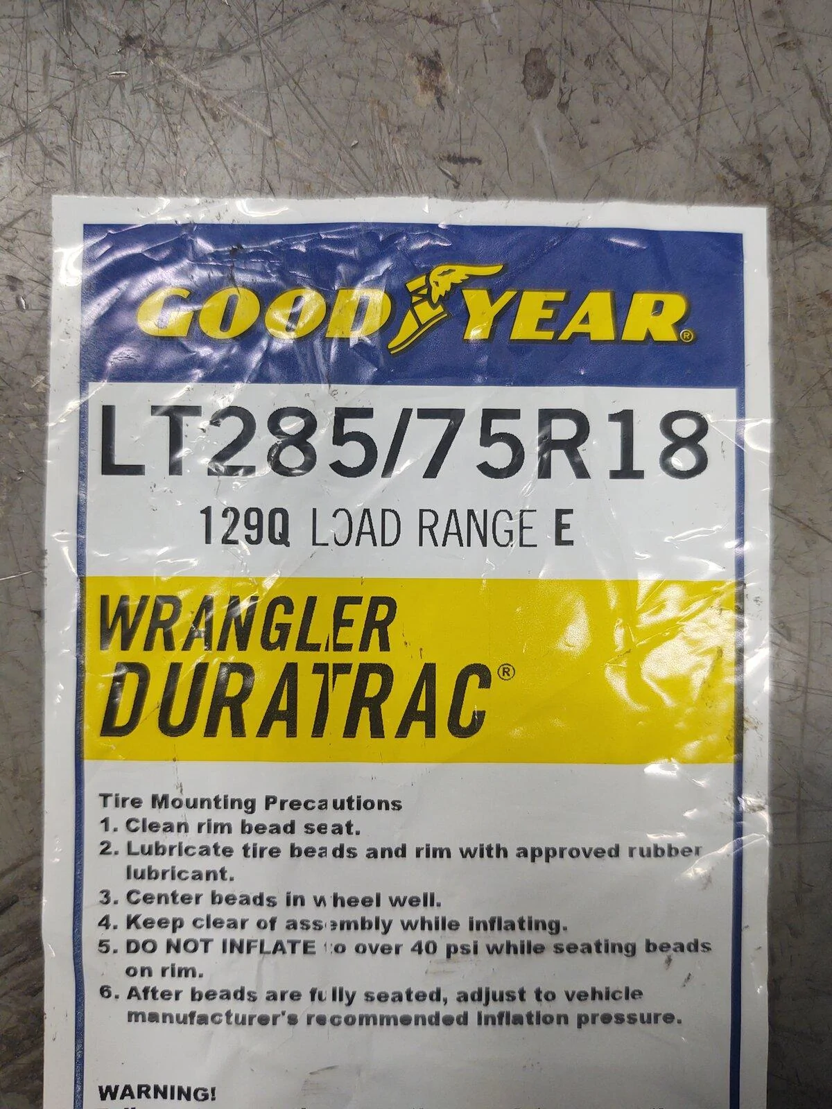

So I was scrupulously searching for the right tire size on my my gladiator and found the best set,( in my opinion.)
I purchased some Goodyear wrangler duractrac’s, 285/75R18.
I kept the stock gunmetal 18 inch rim and it looks so nice!
I Hope this post helps those out there looking for bigger tires.
Oh yeah don’t forget to recalibrate the speedo after.

I have the exact same setup. Same tires and all. Looks great!

Appreciate the specs and pics. Got 15k on my Overland skinnies and cannot wait to shake them off for something more fitting my JT.

Those of you running the 285/75-18 tires, how much lift (if any) are you running on your Overlands?

Do you have a lift?

I've seen a quite a few negative comments on the Overland wheels, but that combo looks great! Since my wife has a bad knee, the best I will be able to do, is an all terrain tire in the same size as what came on my Overland.

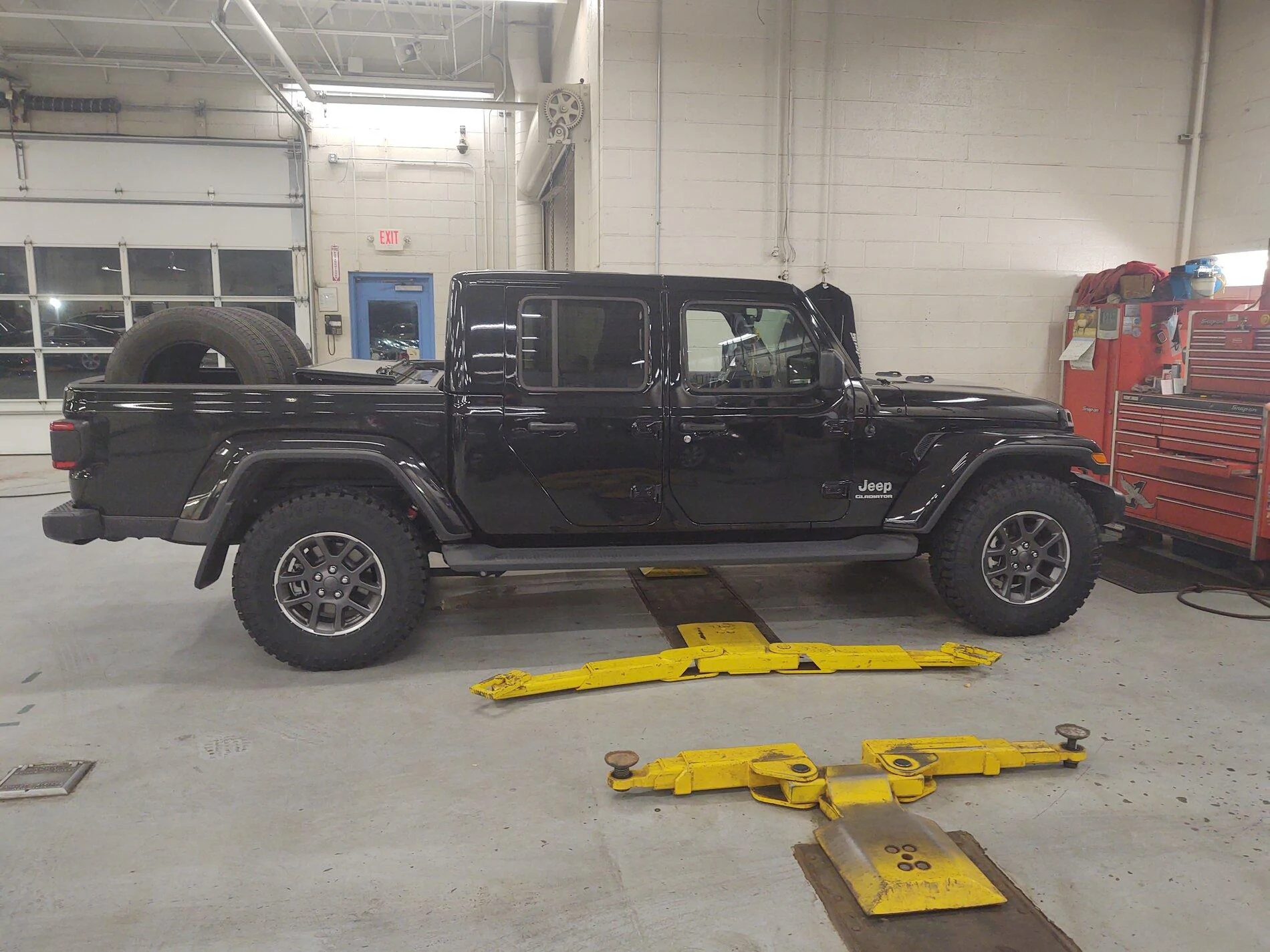

Stock except Rubicon take off shocks and springs. Need to add 1.5 inches to the front to level it.

I just put a 1.5 inch leveling kit on mine and no rubbing.

I haven’t had issues with the wheel set up so far.
