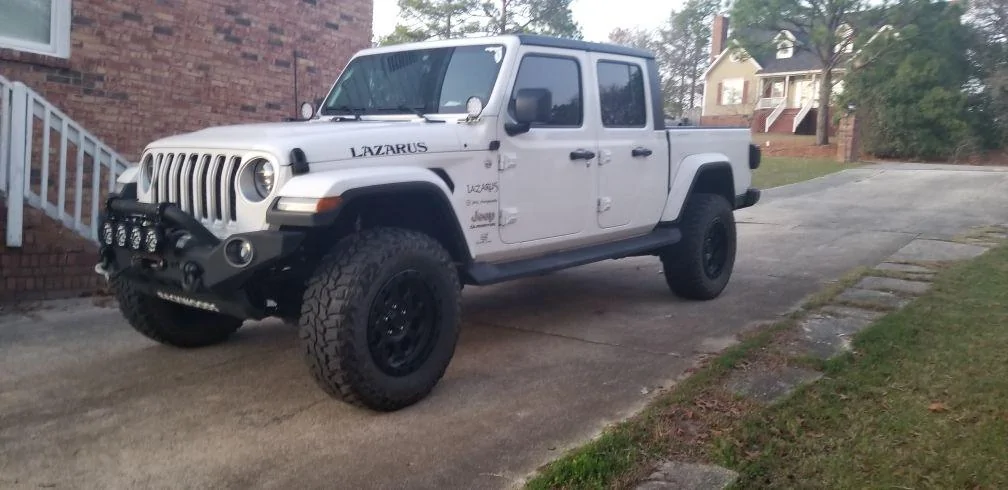

I got my gladiator last saturday night. I upgraded my tires on monday to ridge grappler. 285/75r18. They supposedly measure 35 tall but on the vehicle they co.e out to a perfect 33.5. Of course 33's come out to 31 and so forth. They look aggressive for all terrain. My rubicon that I traded in on saturday had the Nitto MTA's and they were decent. These are better on road

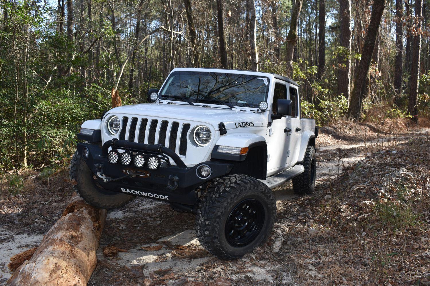

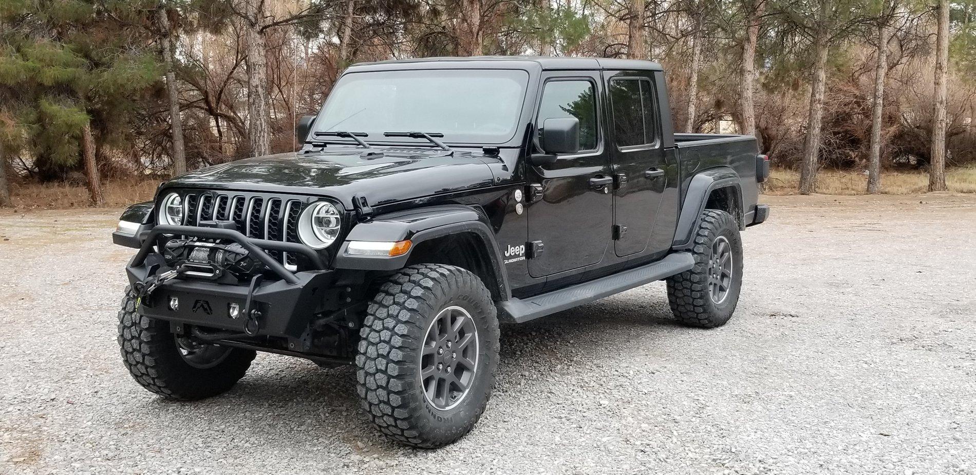

My dealer had American Racing 18"x9" wheels and 295/75-18 Mastercraft Courser MXT tires installed before I bought it. All of the calculators say they are the equivalent to a 34.3 tire. With the stock lift there was no rub at all. I installed the Mopar 2". I also installed Rubicon Express sway bar disconnects. I take it offroad a couple times per month and whenever I find a dirt road that might lead somewhere interesting. It rides good and handles the trails good with no rubbing issues at all. Maybe you could try that size and see how it would work for you. I would like to go to 35"s, but I really don't see a need because of ride comfort with the size I have now and still being able to perform off road.

What front bumper is this ? I love what you've done, looks nice and clean!

The bumper is from Amazon brother. Lol! I thought I would actually have problems winching but it's ben good to me so far. Had a smittybilt but it was so heavy, my front end had a rake to it. I think rugged ridge has a really strong aluminum one out now. But, this one is looking good and working good for now. Loving it!
