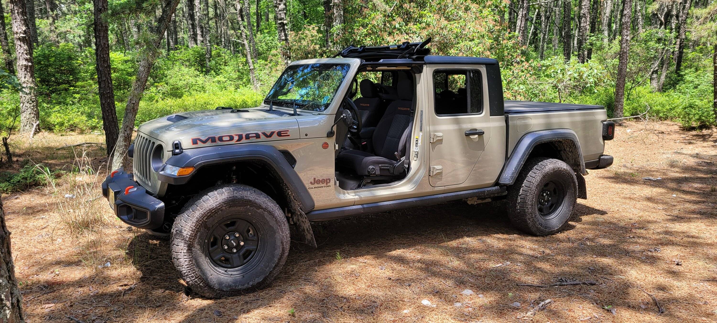

It's an older picture, but what I had readily available. 315/70r17s at +6.
teeniest, tiniest bit of fender liner rub at full articulation while sway bars are disconnected, but a quote i've heard from a user here that was attributed to one of the MORR crew: "if you're not rubbing at least a little bit, you coulda fit bigger tires"

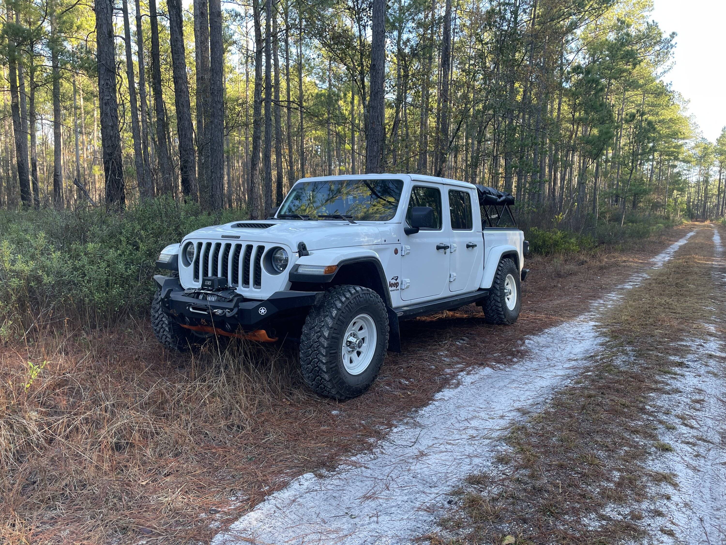

I couldn’t be happier with these, Mickey Thompson Baja legend Exp. 35x12.5x17 @ 64lbs. The wild peaks made a lot of noise and rumbled as I came to a stop. These are the same weight, bigger tires, more capabilities, less noise. Leveled @ 1.5.

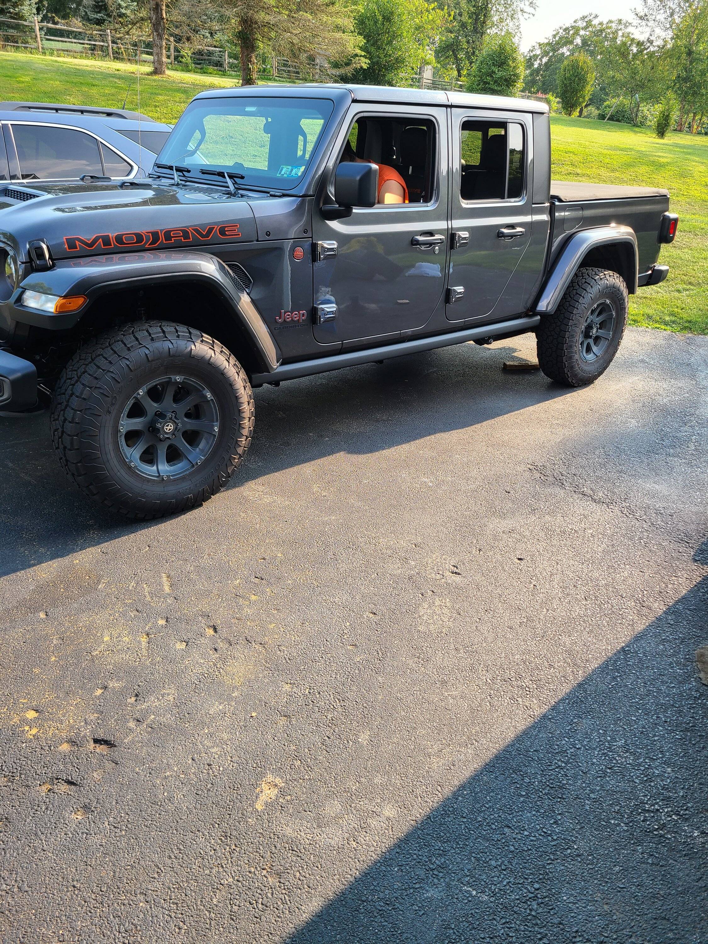

Sales Acct Mgr - OEM Wholesale DLR Group
Toyo 35x11.50x17s on American Racing Legends ATX.. NO LIFT !
