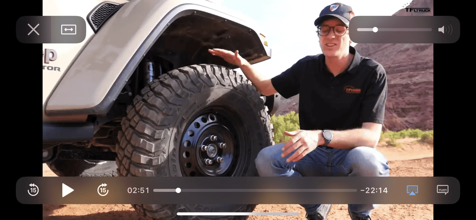

You can run the the BFG KM3 or K02 but they really like a wider rim. The TFL guys are running KM3 35x12.5 on the stock spare wheel. Looks great but technically out of spec.Just ordered the sport with max tow. It has the steel wheels, can I put 35” tires with a mopar 2 inche lift? If so, which tires will fit? Thanks
Nice. I guess the reason why I am asking is because I have funds right now to get the mopar lift and a set of tires that are 35x12.5x17 hoping to run these tires temporarily until I can buy some 17x9 wheels. just wanted to know if its safe and if it will rub at all if I dont run any spacers. thanks for the video.You can run the the BFG KM3 or K02 but they really like a wider rim. The TFL guys are running KM3 35x12.5 on the stock spare wheel. Looks great but technically out of spec.

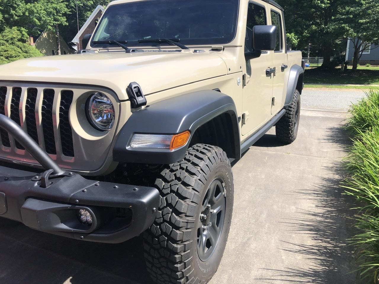

do you know if your wheels and the sport steel ones have the same backspacing? any rubbing ? jeep looks great btw.My 285/75-17 Is a 34.1” tall vs the ~34.6” of a 35 but they’re like 11-11.5 wide so they fit perfectly on the stock 17x7.5
Wheels are the exact same spec, just steel vs AL. Only rubbing was the filler piece between the front bumper and fender. Took those out and now nothing.do you know if your wheels and the sport steel ones have the same backspacing? any rubbing ? jeep looks great btw.

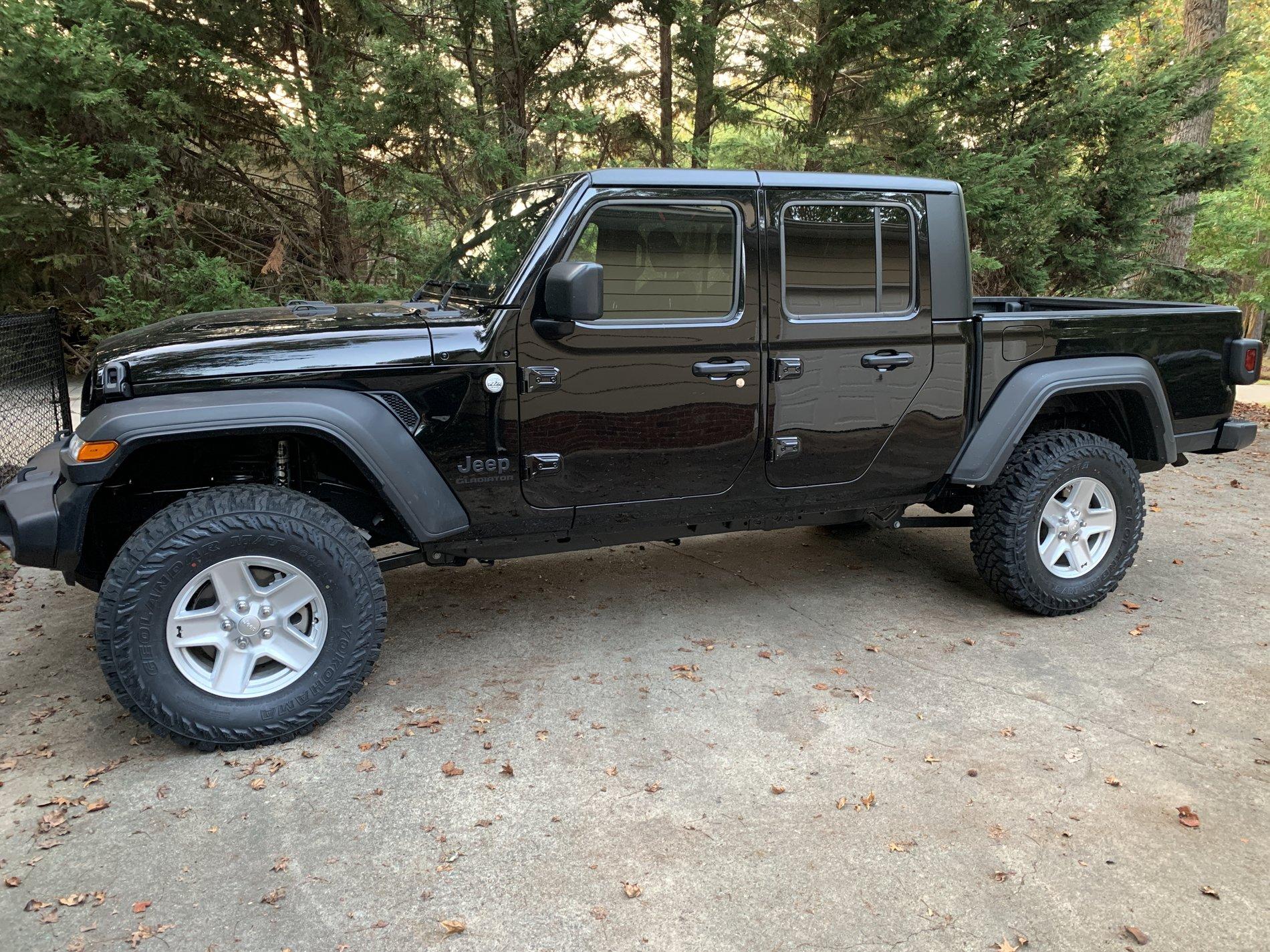

35” tires will fit with no problem. This is my Max tow with the Mopar lift & 315/70/17 Bfg’s On stock Rubicon wheels.Just ordered the sport with max tow. It has the steel wheels, can I put 35” tires with a mopar 2 inche lift? If so, which tires will fit? Thanks
Lift?35” tires will fit with no problem. This is my Max tow with the Mopar lift & 315/70/17 Bfg’s On stock Rubicon wheels.
Yes it is lifted with the 2” Mopar kit.Lift?
