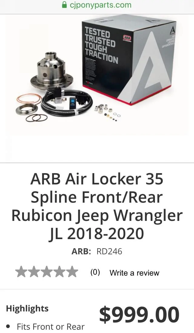

Like this?

I'm pretty sure I read in the fine print, it says requires aftermarket shafts for this locker
It will, but that ARB fits the front and rear differentials and nobody has confirmed rear 35 spline axles to my knowledge. Right now I think it's just the RCV offering up front.

If I'm not mistaken, the gladiator is 32 spline? ARB makes 32 spline air locker for front and rear. I might look into that in the future
