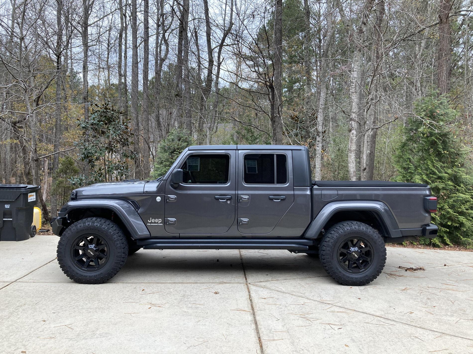

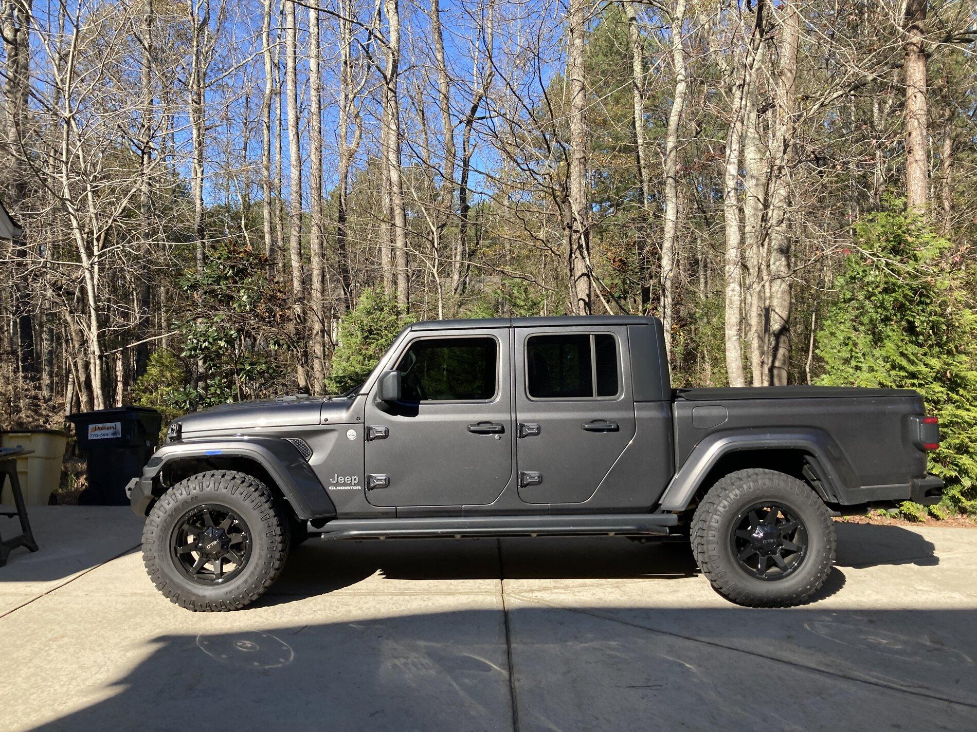

I was getting a bump rub on my Overland, with a Rubi take off, with 35’s. Went with TF 1.5 front and DS3/4 rear. Easy and inexpensive fix.
