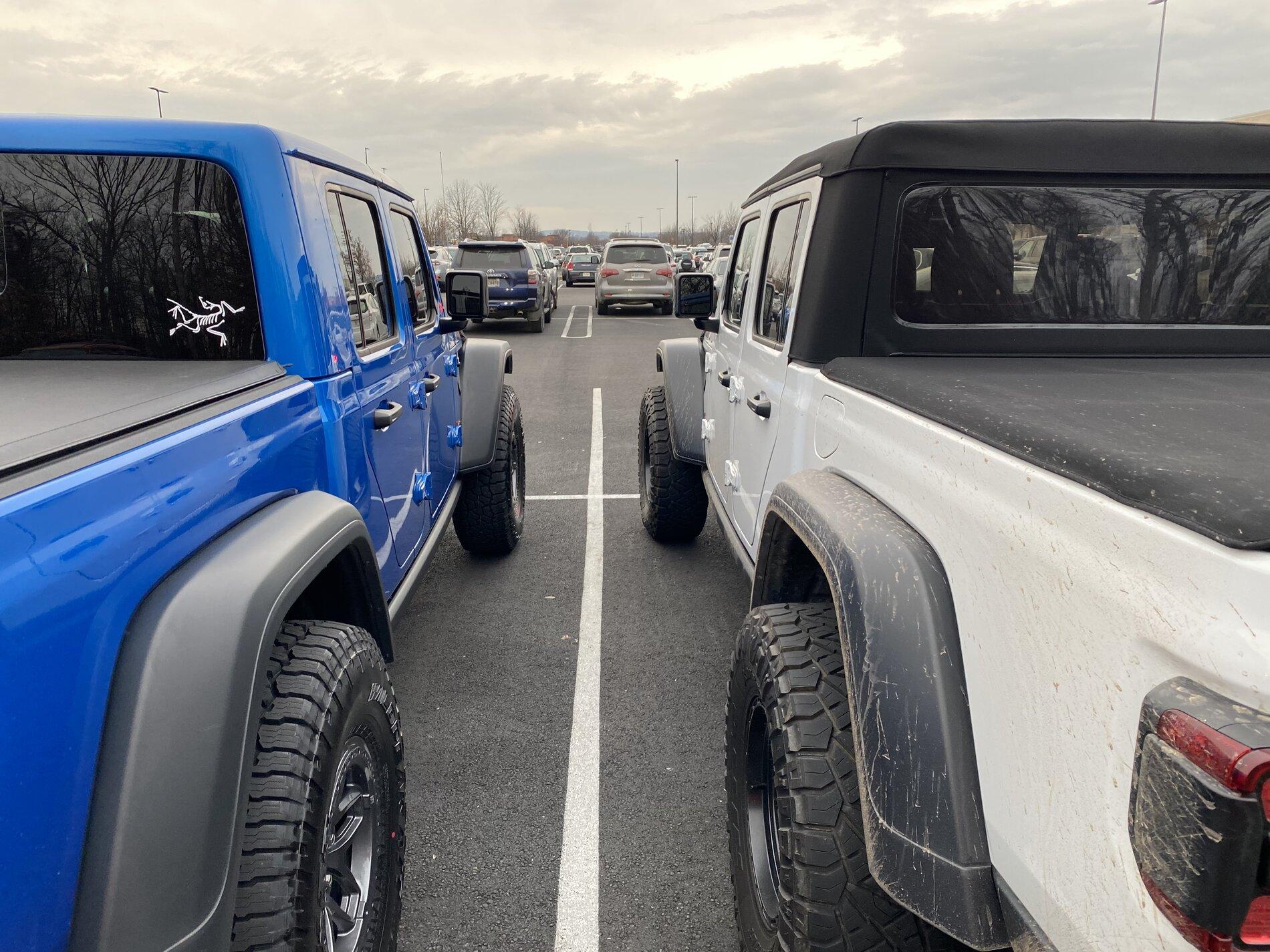

I got 35's and immediately regretted it. I just had 37's installed that I found for $550 installed and I sold my 35's for $600 Friday. I'll say this, get what you want don't settle. If you got to 4.10 gears and you get the 35's your gonna want the 37's. If you get 37's and you got 3.73 gears then your gonna wish you went with the 35's. That's my advice, I got 4.10 gears and got 35's and within a month I was wishing I had went with the 37's been looking around ever since because the wife said until they wear out I was stuck with them. I found the 37's and she agreed because I told her I could sell the 35's and make the money back. The difference in performance is about 1mpg loss on the 37's in mine. Went from 18.3 to 17.3 average over all. I can live with it.
There is a old saying and I just said a few days ago, buy once cry once
On 35's
Jeep Gladiator 35s or 37s PXL_20201219_123525410

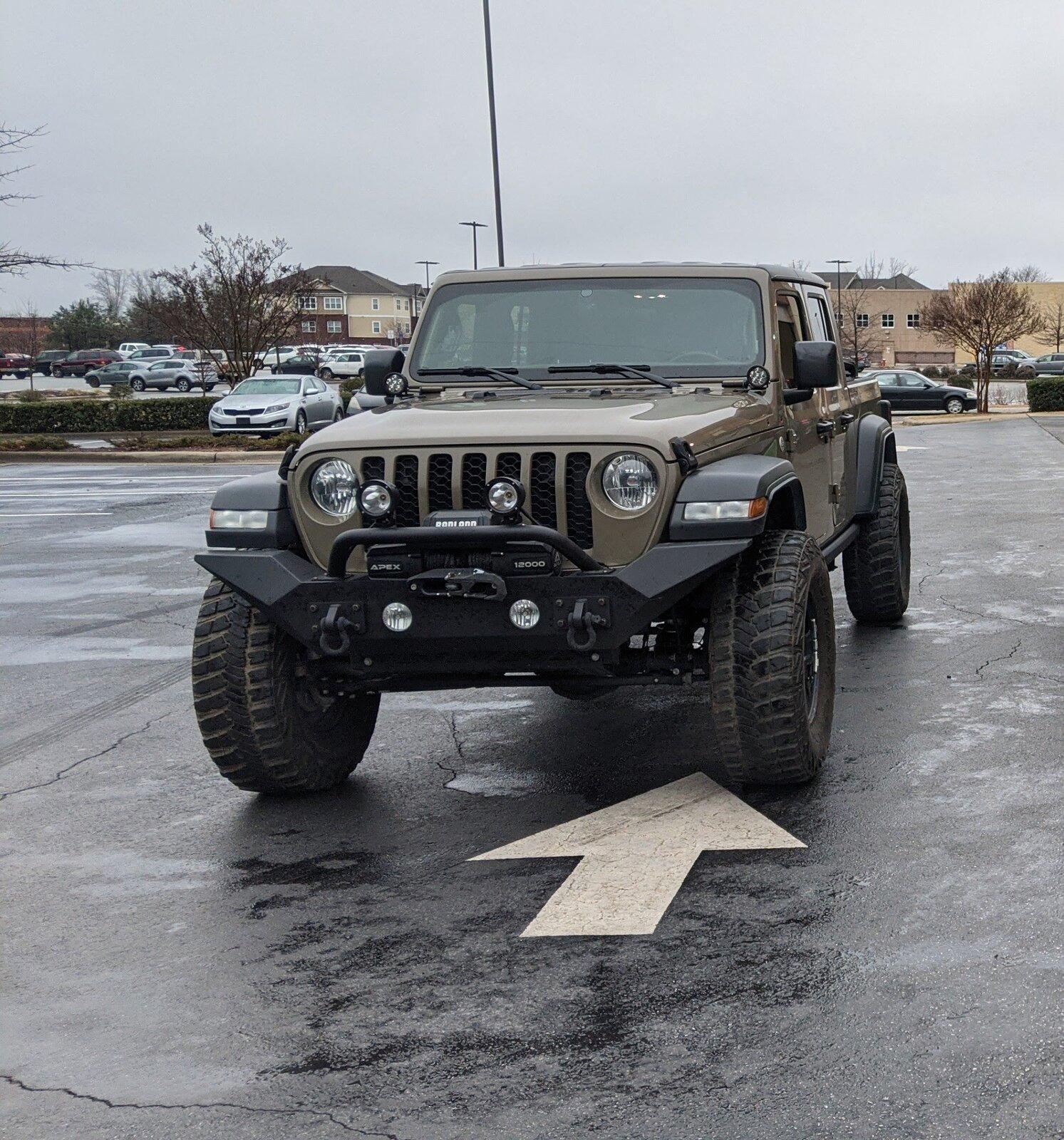

On 37's
Jeep Gladiator 35s or 37s PXL_20210218_222120823~3

Looks great! Just got my Glacier White Rubicon. Still deciding on wheels and tires but my question to you is what lights and mounts are you running on your A pillar? I love the way those look
Thanks!
