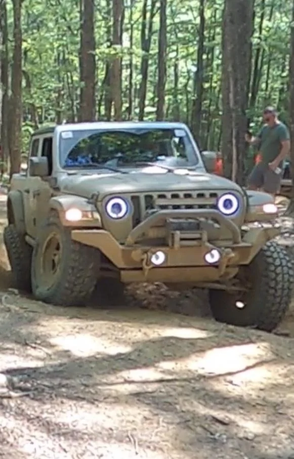

Did the same. Rubicon front springs aren’t any taller, its the higher clearance fender flares that sit higher.
My winch and bumper dropped the front fender height by 3/4” so i put the terraflex 1.5” spacer in front and day star 3/4” rear effectively lifting the whole truck 3/4” for 37’s yet keeping factory rake for towing my camper. In the pic below, left front and right rear tires were just barely off the ground (opposite corners stuffed) going through a crevasse with BOTH front and rear sway bars disconnected. Lol
Terraflex spacer kit came with taller bump stop so NO Rubbing.
As far as getting the 3/4” puck for the rear.... that 1.5” front will level the truck out, without anything in the rear, you wouldn’t be able to put one bag of quickcrete in the bed without squatting. If you plan to ever use your truck as a truck for hauling or towing, keep the factory rake.

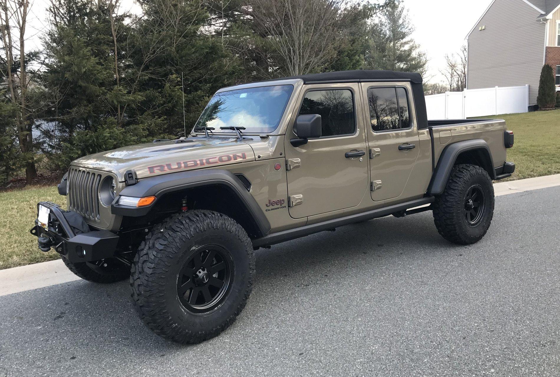

jeepguy225
Nov 12, 2018
480
798
Maryland
Gator JTR, '04 Rubicon (past: 04 TJR, 79 and 84' CJ-7)
Buyer of Jeep parts
I just installed the Teraflex 1.5" front and Daystar 3/4" rear spacer lifts on a Rubicon. Definitely noticeable lift. Would have sit nose high, if I didn't add the rear spacers.
The next day I installed a winch bumper and winch. Brough the front end right back down a little. lol
Same here. Rubicon, wheels: 17x8.5 with 5.02 backspacing. tires: 37x12.50, lift: 1.5 inch front leveling kit (1 inch after bumper/winch added), 3/4 inch rear. 1.5 inch bumpstop front, 1 inch rear. Haven't rubbed fender yet. I may take 1/2 inch bumpstop out of the rear. For the rear I used the JL Teraflex bumpstop add-on kit, now they have out the JT specific kit, as it's slightly different.
