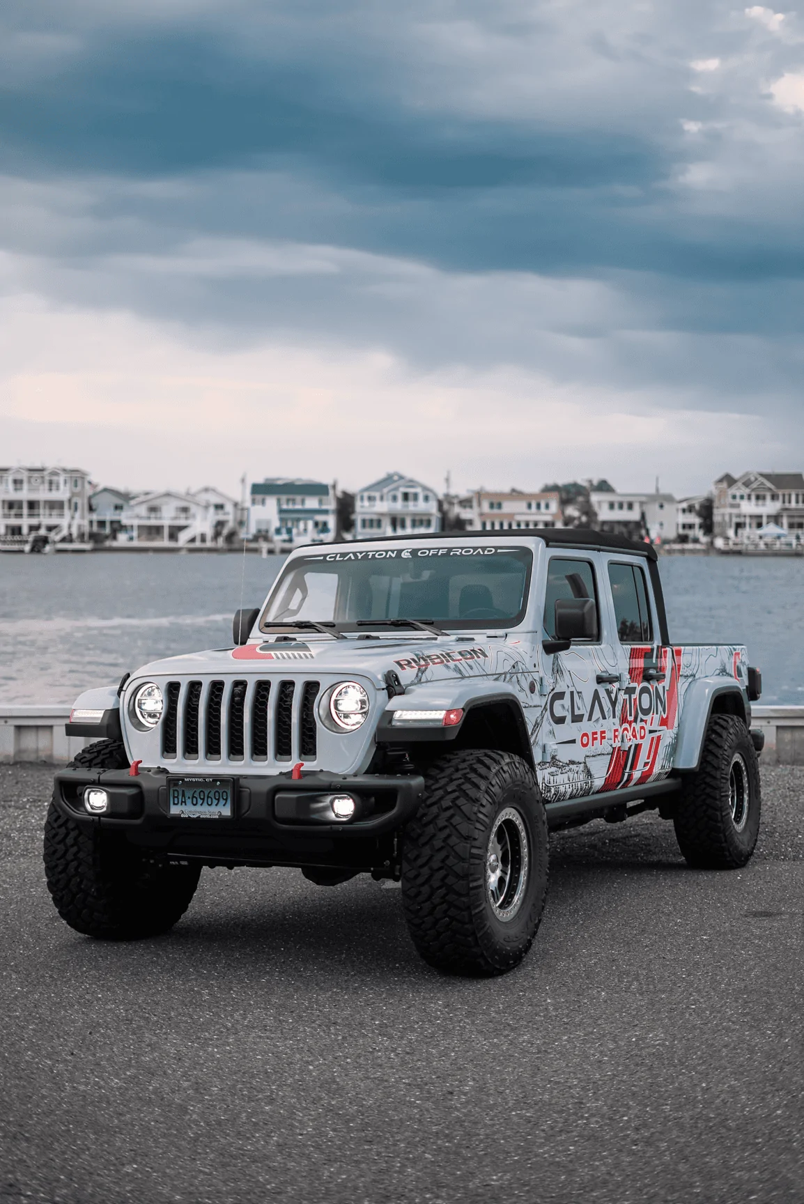

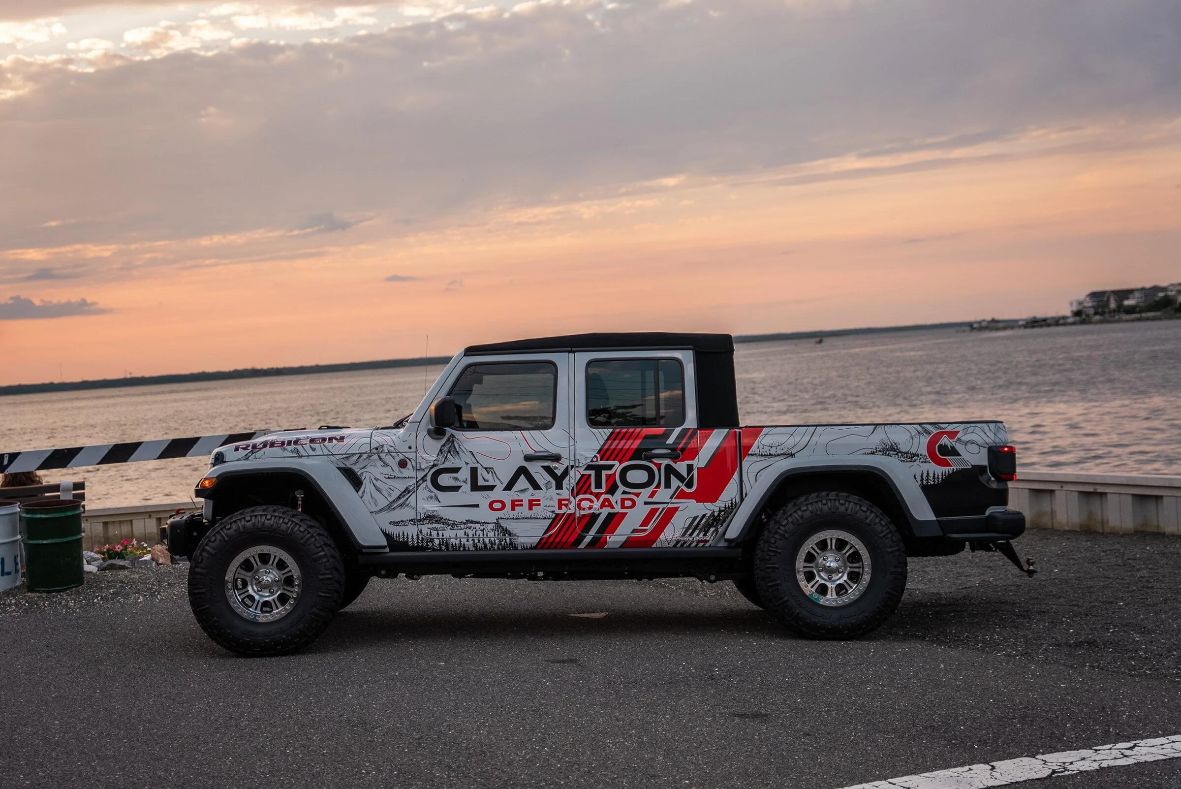

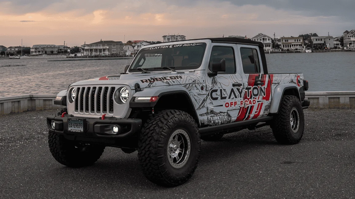

We actually did this! I'll post some pictures of this combo for you to check out, no bottoming out issues at all daily driving. You'll rub the fenders off road of course, but for a daily driver, there's enough clearance!
Jeep Gladiator 37’s on Clayton 1.5” Level for Rubicon Diesel DSC08791-2
Jeep Gladiator 37’s on Clayton 1.5” Level for Rubicon Diesel DSC08805 landscape
Is this Clayton 1.5 lift kit with 37s?
At the time this photo was taken, this was actually the 1.5" leveling kit with 37s! So you could get a good idea of what the proportions on that set up would look like, just taller in the back!
