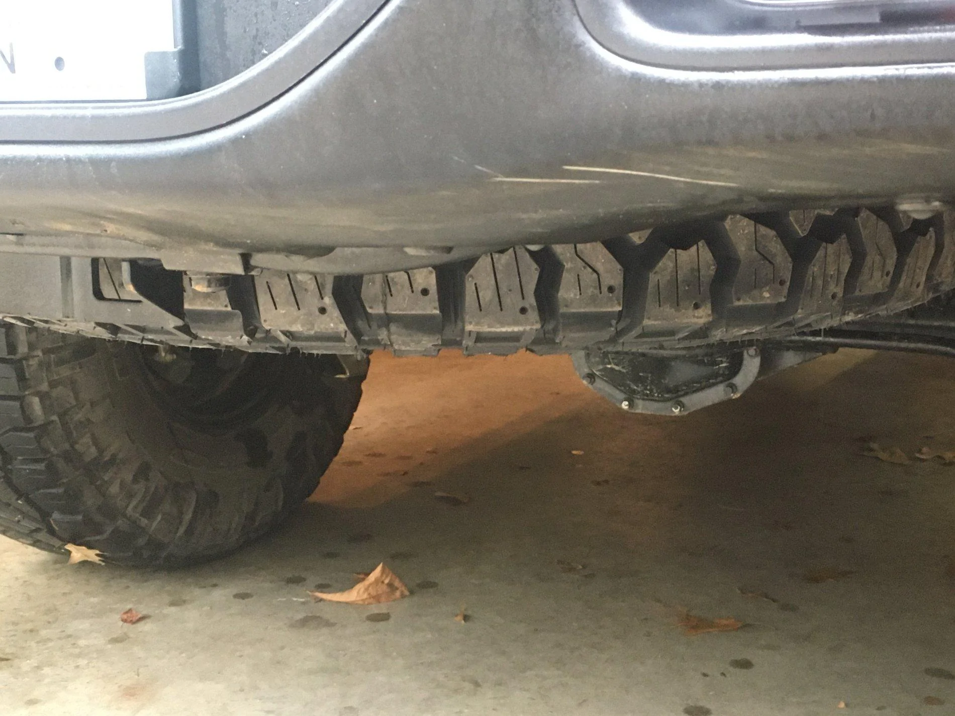

I still need to buy a spare but I am running MT 37in baja boss. I just installed the afe rock basher exhaust and removed the spare tire shroud...i dont think it will be a problem when i finally get a spare

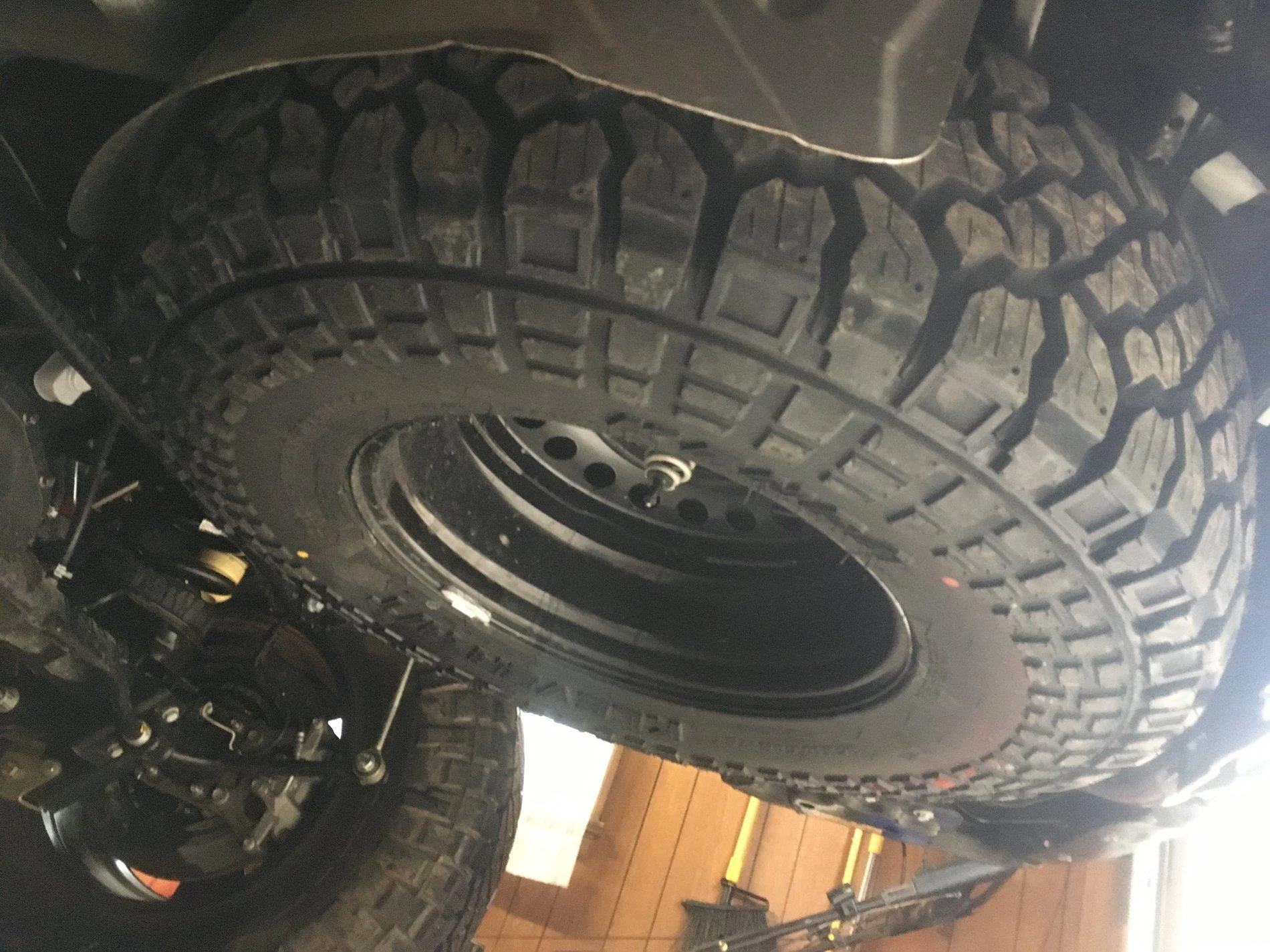

I’ve been running 37x12.5 R18 Kanati Trail Hog A/T’s on my Gladiator for last few months. Have them mounted on some 18” wheels from a 2016 Wrangler Sahara. After reading a few treads on here I ordered a 5th tire for a spare. It was a tight squeeze but fit.

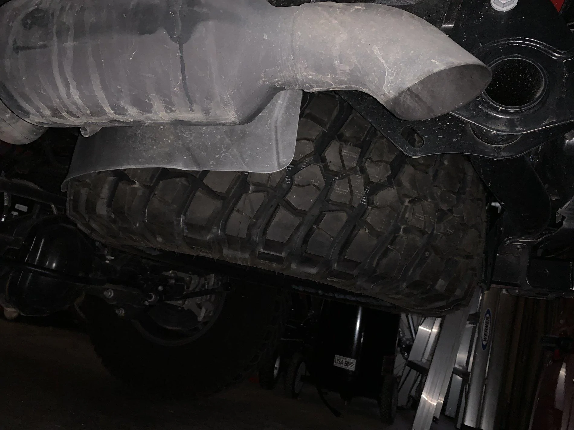

I was able to snag an BFG KM2 that was used as a spare but “never” seen pavement. I threw it on the spare rim and it fits without airing it down.

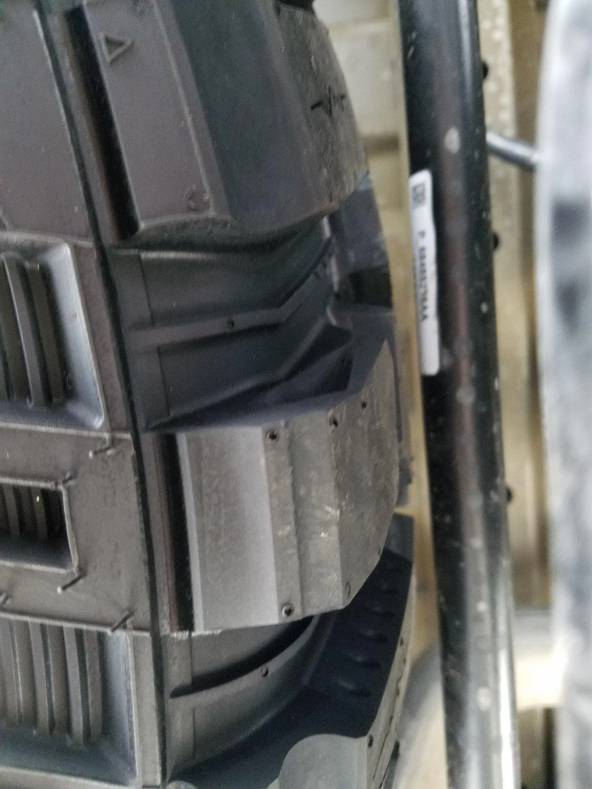

So far I have NOT been able to get my General Grabber X3 37x12.5R17 to fit (stock spare wheel.) There is not enough room between the trackbar and the receiver. I even aired down to 15psi and it wouldn't fit.
When I measure between the trackbar and receiver, there is about 37.25", which should be enough to fit my tire since they are actually 36.8". I'm going to try again, but I'm afraid it will hit the trackbar when off-road (which this is being built for) even if I get it up there.

I’m sure that a KO2 will fit as I have my KM3 mounted there now, the spare is at full air pressure and fits tight. I did not need to modify anything for this to fit, no bending of the heat shield.
