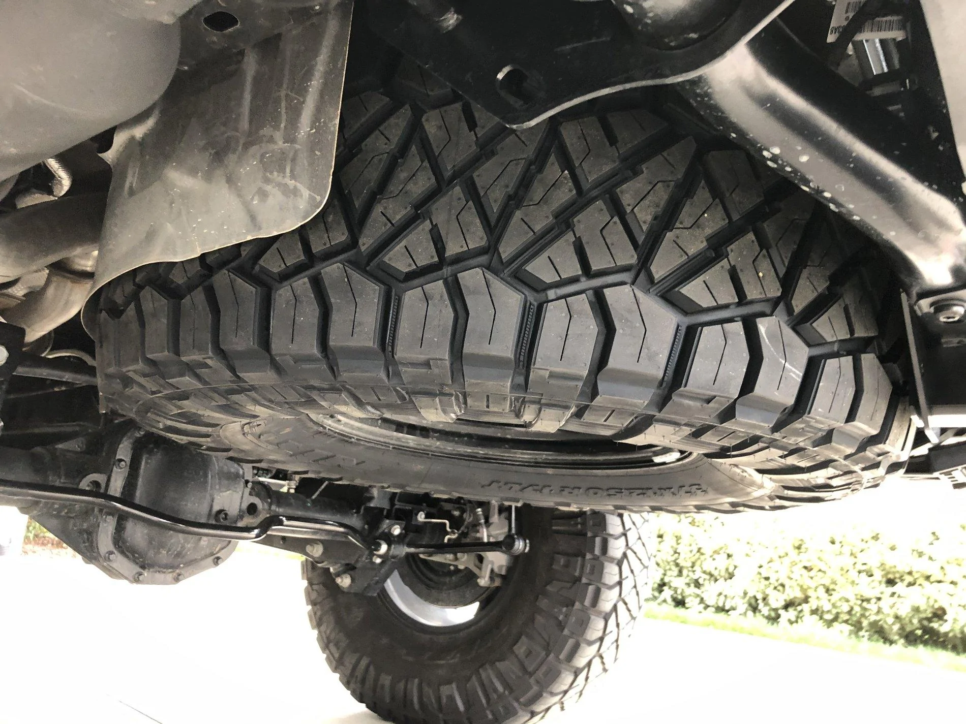

On my Sport S, the spare 37x12.5R17 Maxxis Razr MT fit on a 17x9.5" Black Rhino Arsenal. (No lift or any mods under the bed for that matter... yet)

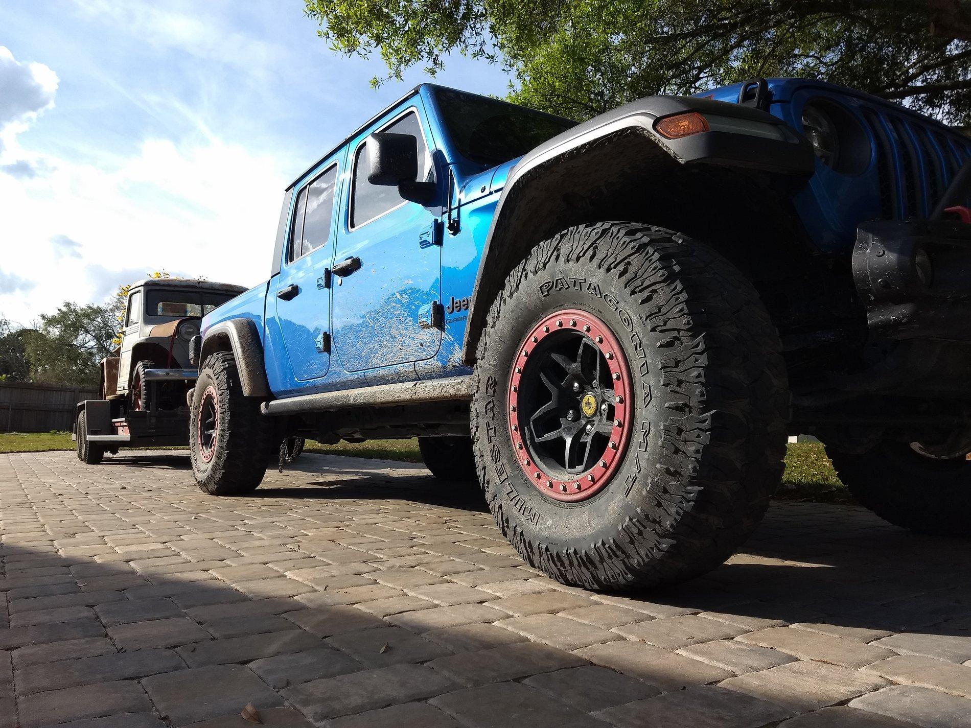

Just to clarify, I'm running 37 x 12.5 x 17 Milestar Patagonia M/T's on my Rubicon, 1 1/2" leveling kit only, bone stock in the rear, no rubbing and still getting 17.5 MPG's @ 75 MPH on the highway!!! And yes the Milestar fits in stock spare location!

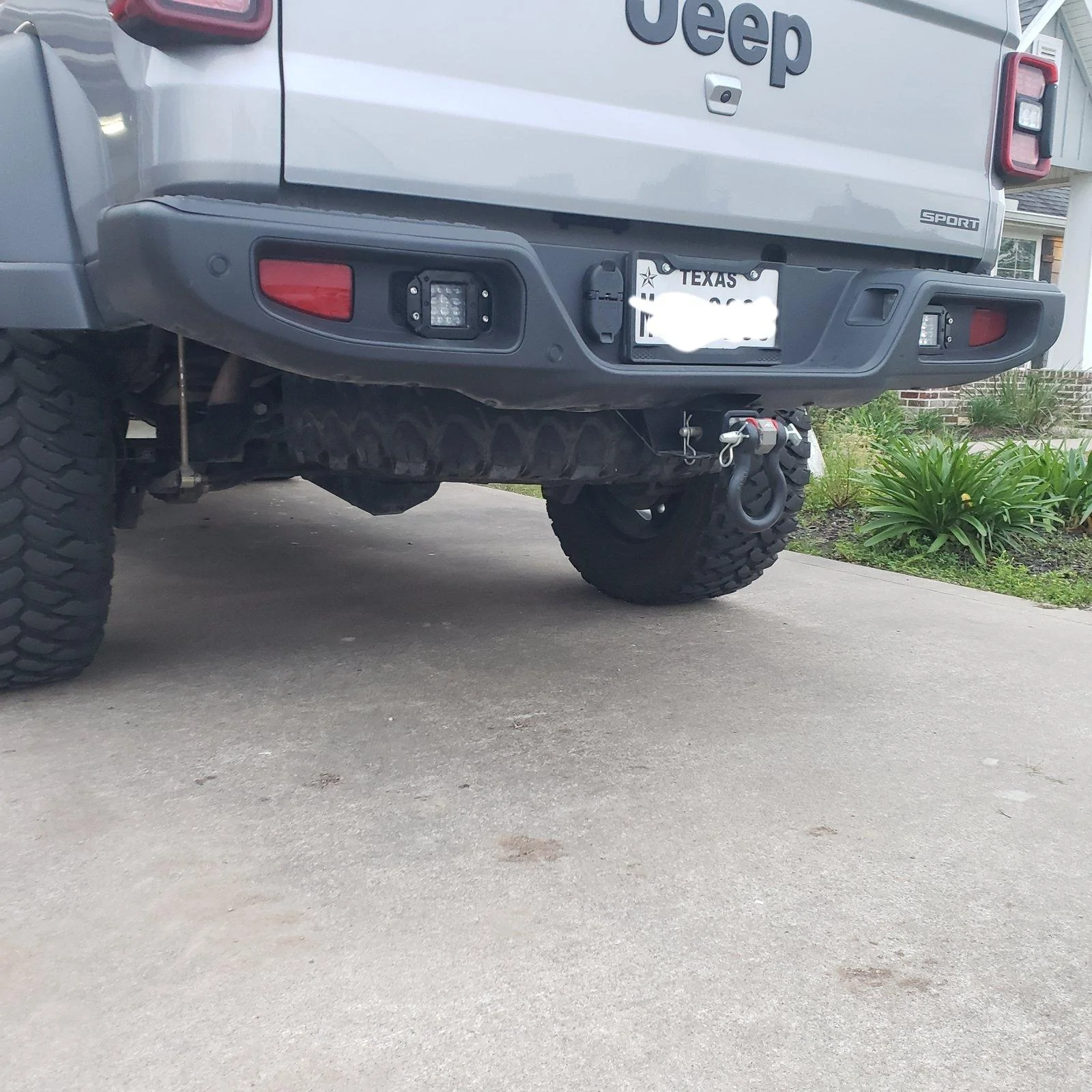

Well used 37x13.50r17 Gladiator Xcomp M/T on a 8.5" wide KMC wheel.
On a side note: I removed the resonator and the heat shield and she fit without any effort.

How does it sound without the resonator? Been thinking about doing that as well, then just putting a piece of pipe and the same turn-down in the same spot.

Resonator: I can barely tell the difference outside of the truck - on the inside there is no difference. I like the way it looks without it and once it was gone the heat shield looked like crap so I took it off too.

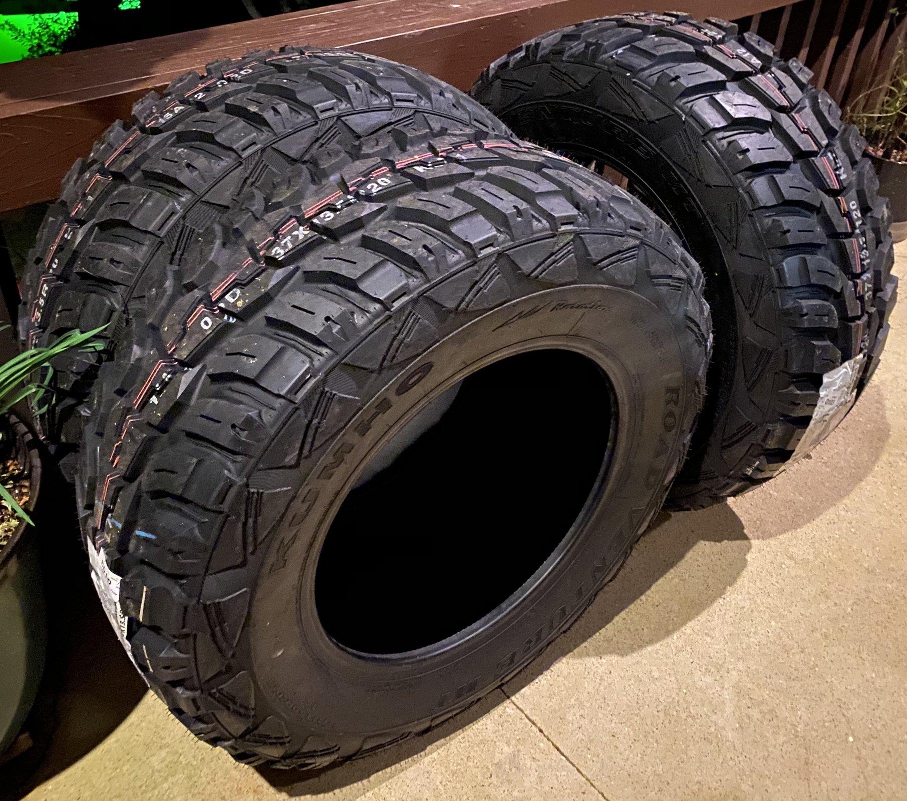

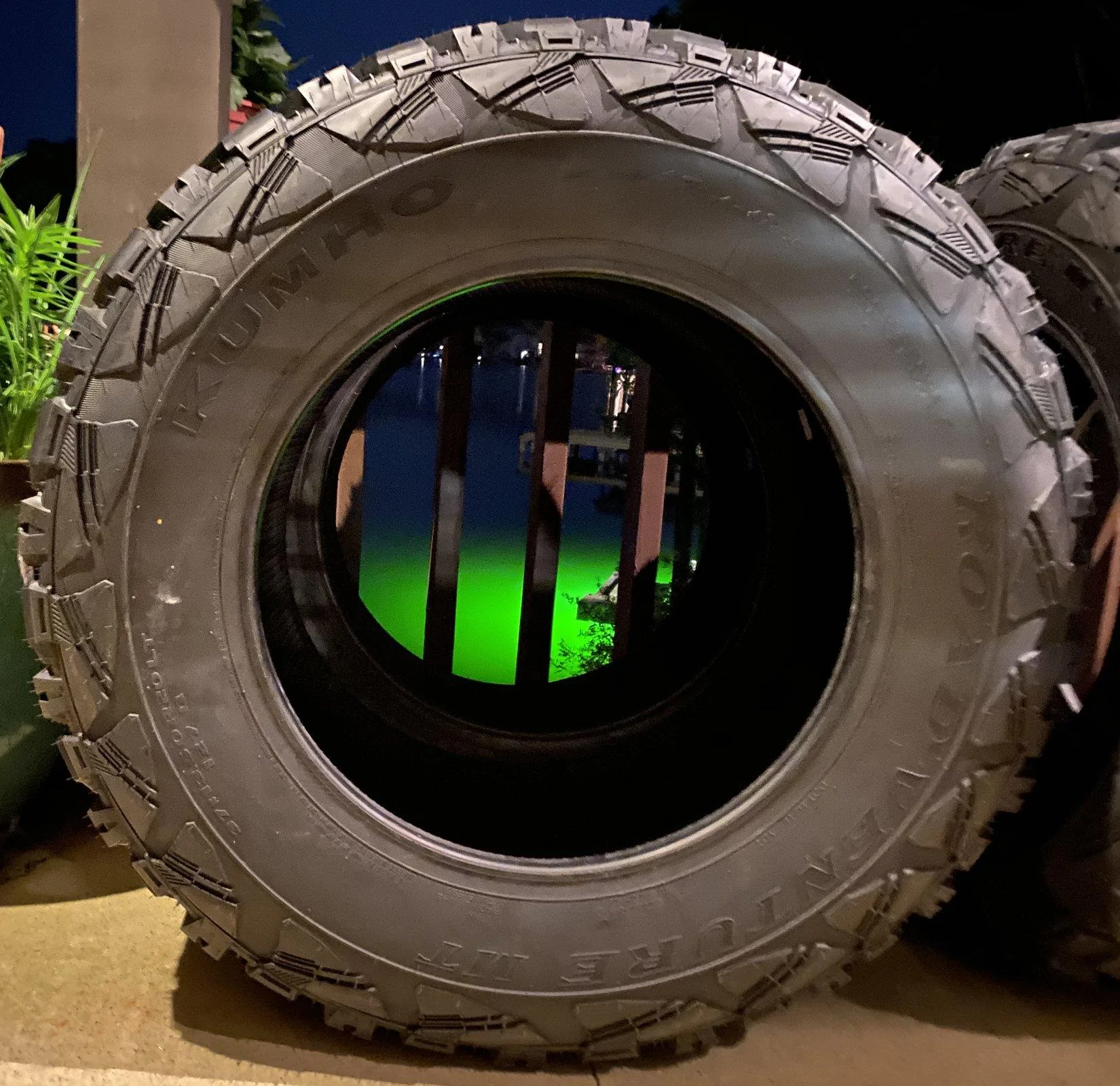

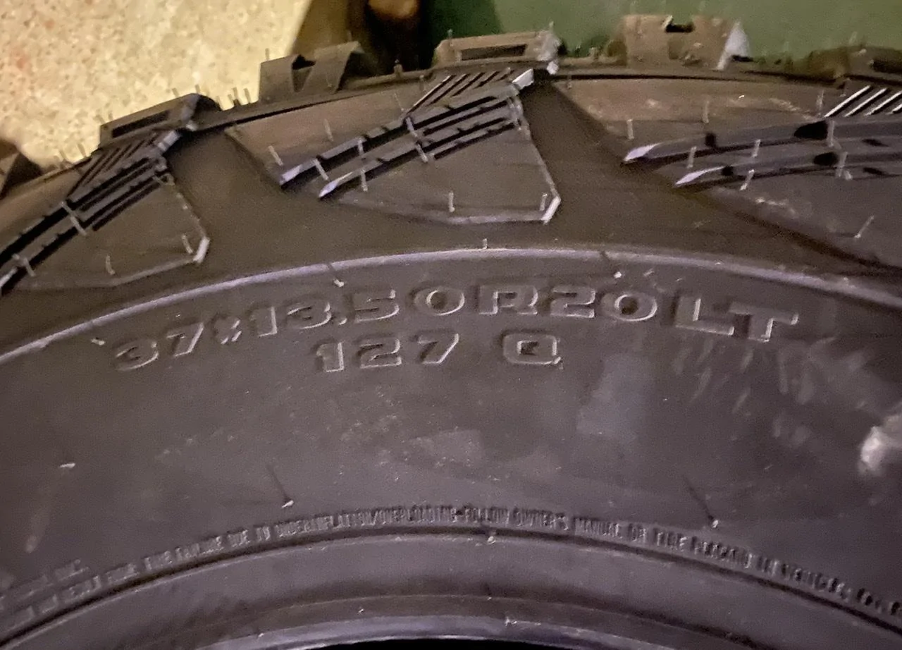

Here’s the 3 that showed up today...
