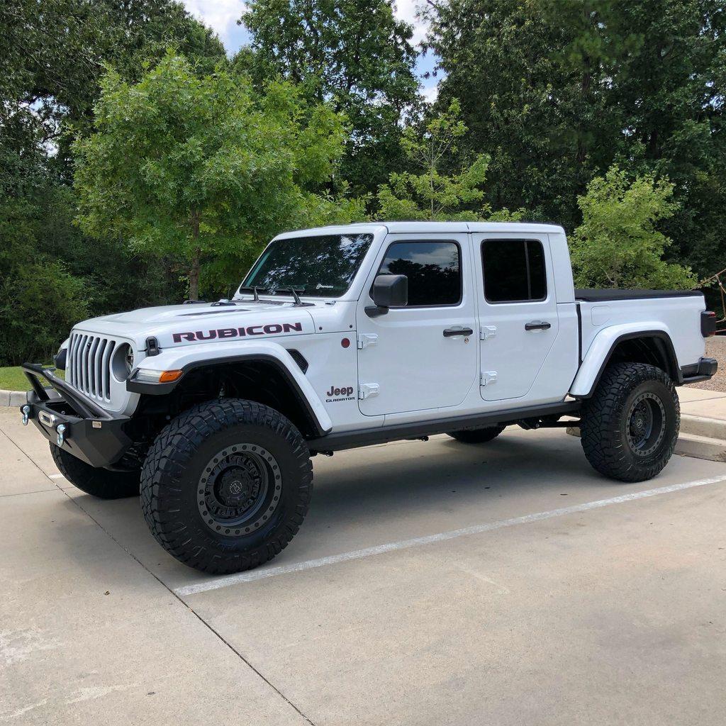

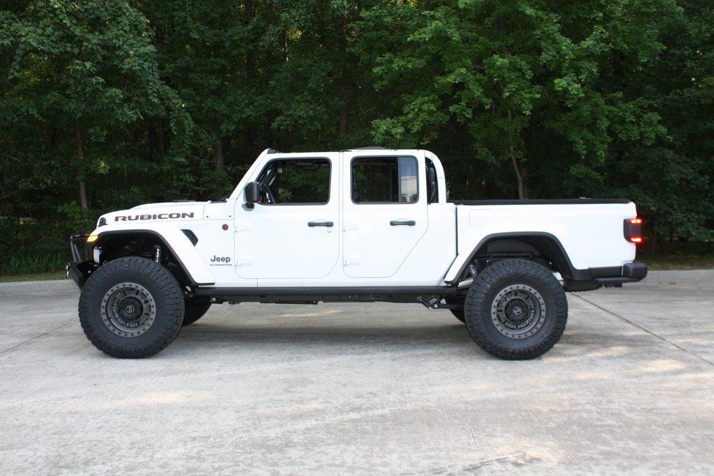

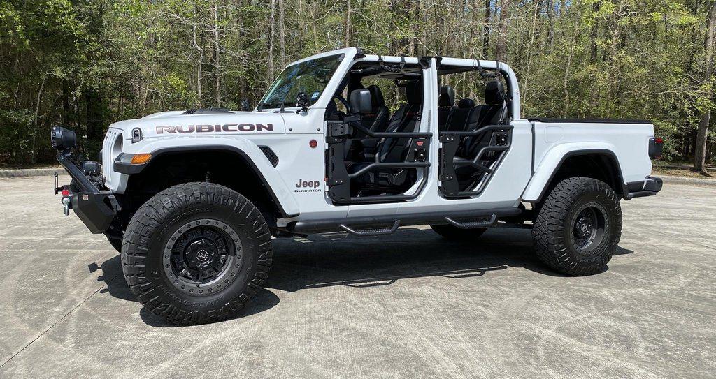

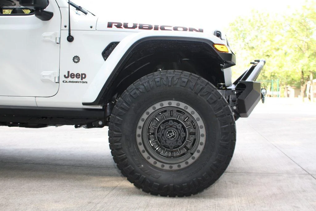

This is my first Gladiator that was on 18" Black Rhinos and 37" Nitto Ridge Grapplers
Perfect. Love it.! That's exactly what I'm talking about. Perfect stance. That wheel to tire ratio in my opinion is spot on and is what I'm talking about.
35s on 18s aren't bad and I may stay that way but I really wanna go 37s in a perfect world. Not looking forward to regearing though.
Couple questions though. What's the width on those Grapplers x12.5 or x13.5 and that wheel width itself on the Black Rhinos? Also what lift you running to allow room? I'm considering the basic Mopar 2 inch and hoping that'll be enough clearance.

wheel width is 9”
tire width is 12.5”
suspension lift on this one is Mopar 2” with .75” spacer in front

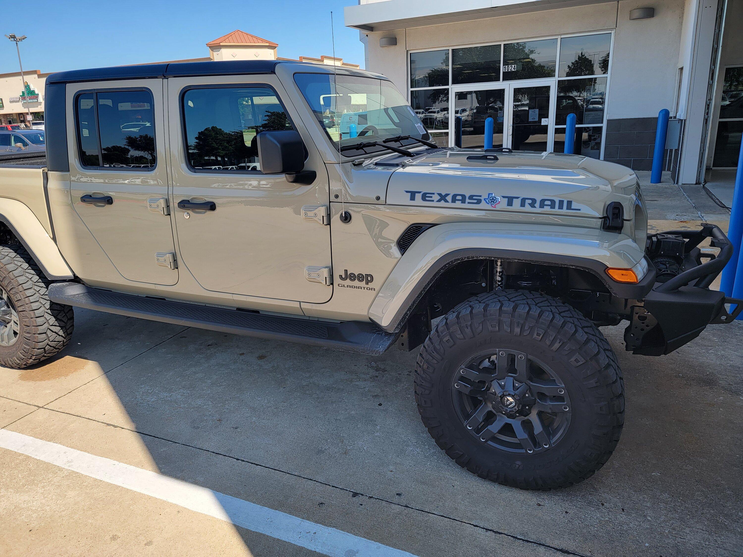

35s on 18s as well. Planning to go to 37s when these are due for replacement in a year or two. Guess I didn't realize 18 was an odd wheel size?
