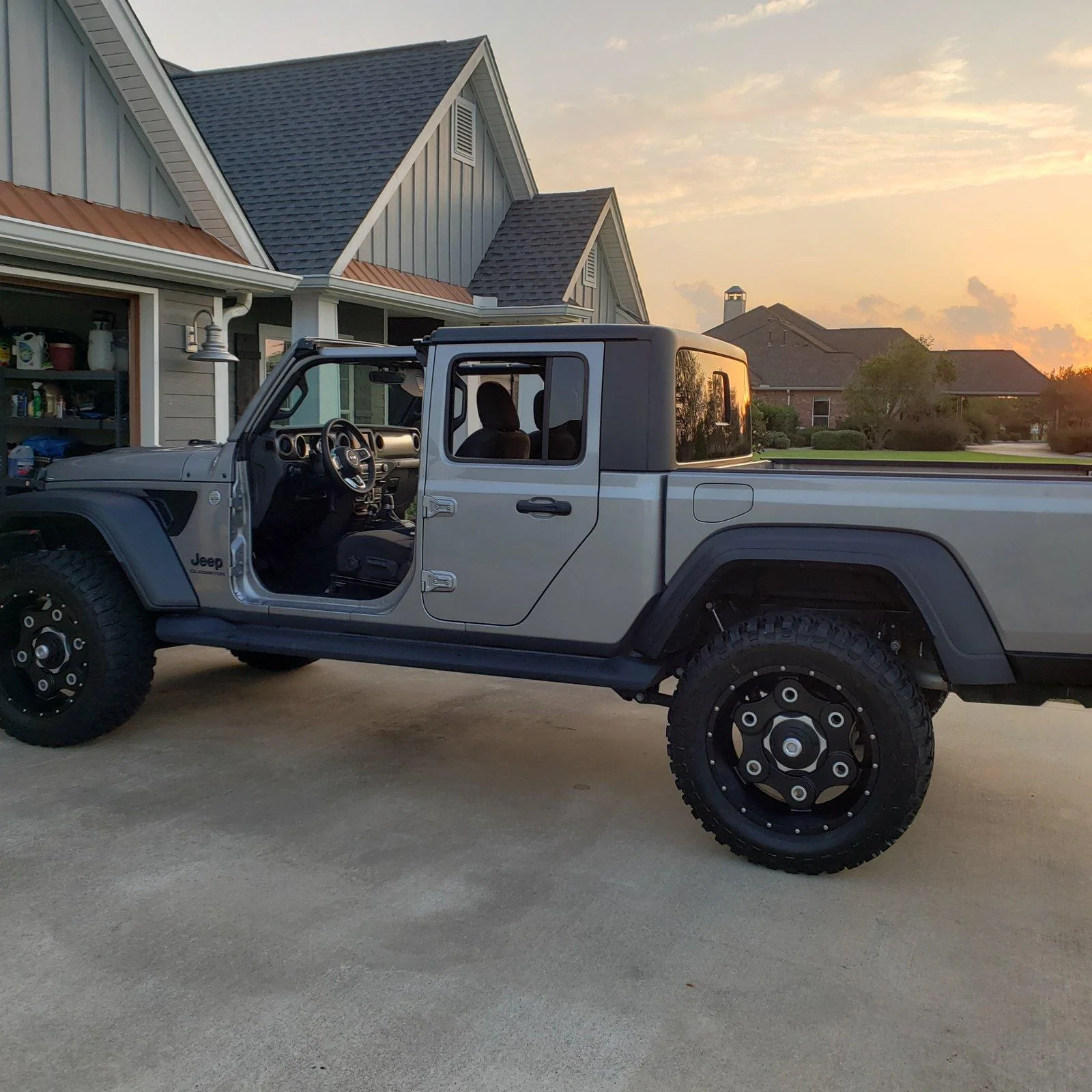

What gears do u have? I installed the Skyjacker 3.5" lift on my Sport S Max Tow and the 4.10's handle my 37's just fine.

I had 3.73's on my JKU with the same wheel/tire setup that I have now and it worked fine. It was a little sluggish but got better gas mileage. I was still able to pull my SxS with it and overall it was fine. That being said, I can definitely tell the difference with the 4.10's and 8 speed tranny. My opinion is to get the wheels and tires that you want...it is definitely doable with 3.73's and then you can upgrade later.
